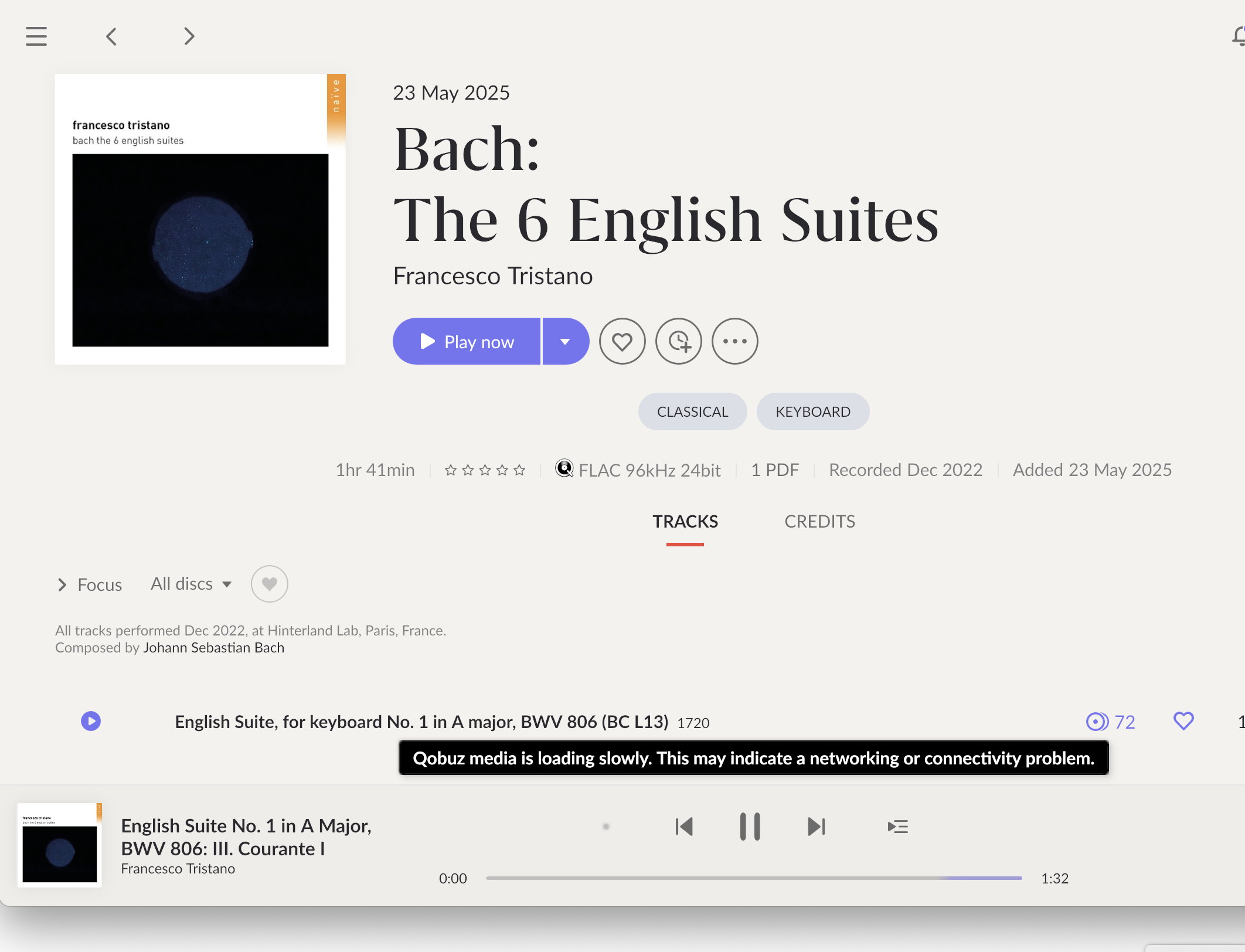

Recently, every time I start playing music from Roon, after 20 or 30 seconds, the music stops and I get an error message stating "media is loading slowly" and advising me to check my network and Internet connections. The connections are fine. I have reset both and the problem persists. I have also reset my Roon Nucleus One. A couple of my Roon endpoints are BluOS products (PSB Alpha iQ, Bluesound 2024 Node). I can play the same music on those systems with no problem from the BluOS app or using AirPlay. Network is ISP internet gateway > Google Wifi four-node mesh network (main Google Wifi unit is connected to Nucleus One) > and then Wi-Fi to my players. BluOS and AirPlay work fine on my network, but not Roon. What's the fix?

This is not a Qobuz issue or Qobuz CDN issue, and it is not an issue with my network. As I mentioned in my initial query, I can stream from Qobuz to my PSB Alpha iQ and Bluesound Node from the BluOS app, or from the the Qobuz app via AirPlay.
I’ve been doing some more troubleshooting. I can play Qobuz content from Roon through an iFi micro iDSD BL DAC-headphone amp which is connected to a USB port on the Nucleus One with no issues. I just tried streaming Qobuz content from Roon to a KEF LS60 Wireless system. Again, no issues. That leads me to believe the problem may be related to BluOS, not to Roon
How, here’s where things get crazy. After doing this, I can now stream from Roon to the Bluesound Node and PSB Alpha iQ with no interruptions. As mentioned, the problem has been constant for the past week or so, until now. Go figure!
