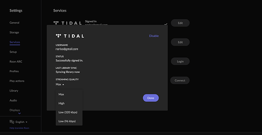

Have you tried changing the streaming quality in Roon for the Tidal service?

Thanks for confirming. Can you please let us know the exact local time + date + track when the next issue occurs? We’ll enable diagnostics for your account to see if logs can provide further clues. Also, does this issue happen when you set a lower streaming quality under Roon Settings → Services → Edit (next to TIDAL/Qobuz) → Streaming Quality?
