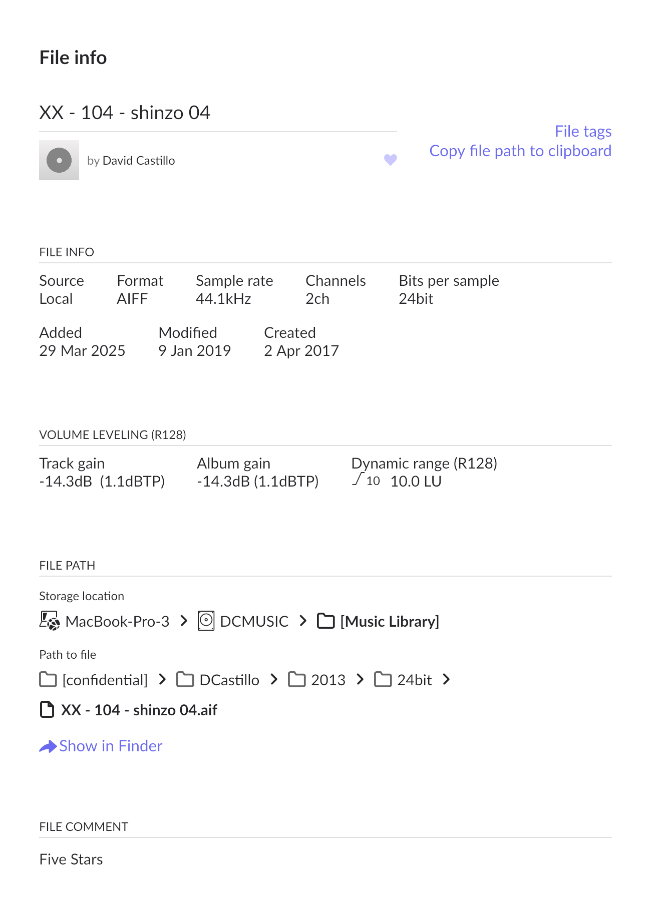

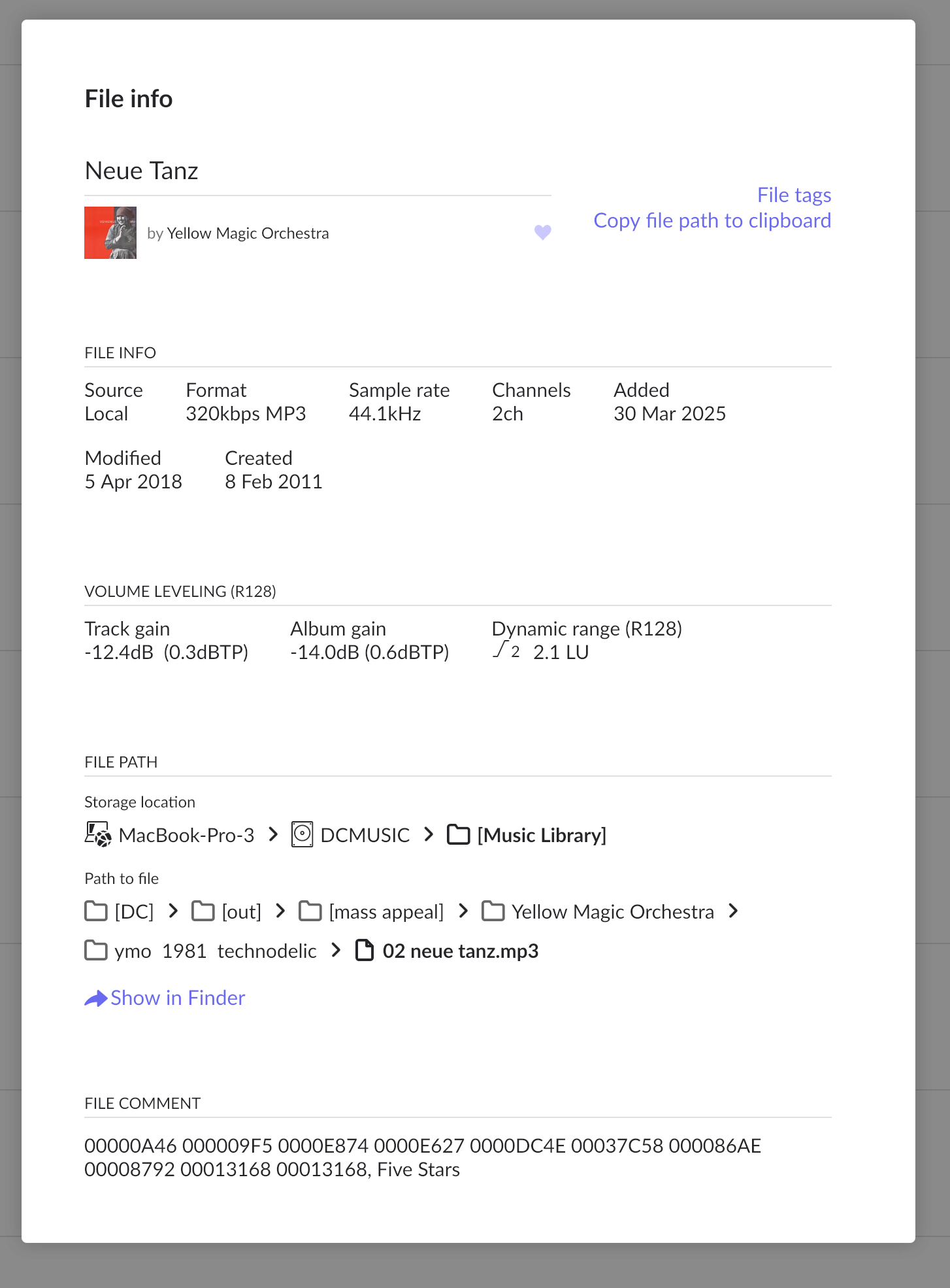

Here are a couple occasions where it dropped:
The first time it stopped at the beginning of a 24-bit AIF. So I thought maybe it could have been due to a bit-rate change from track to track, but this time it happened by going from one 320kbit mp3 to another 320kbit mp3.
