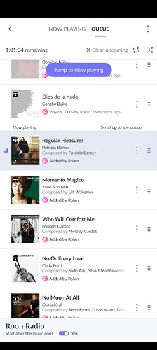

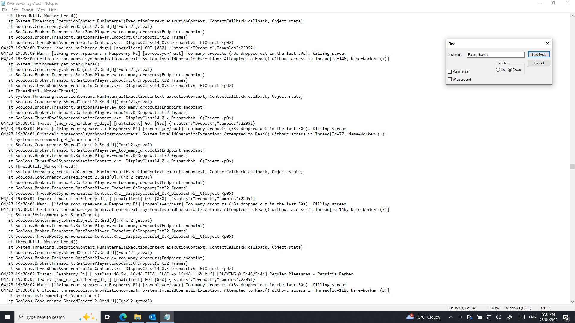

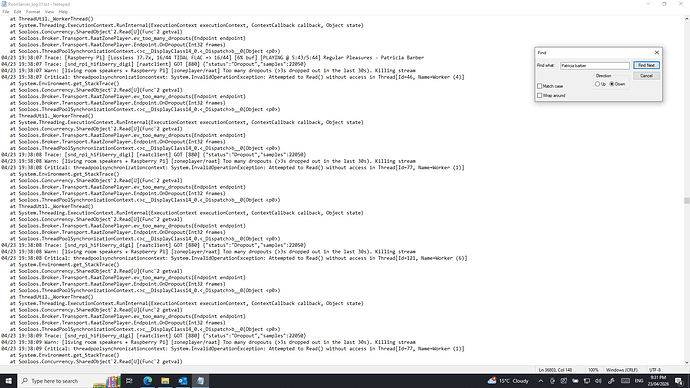

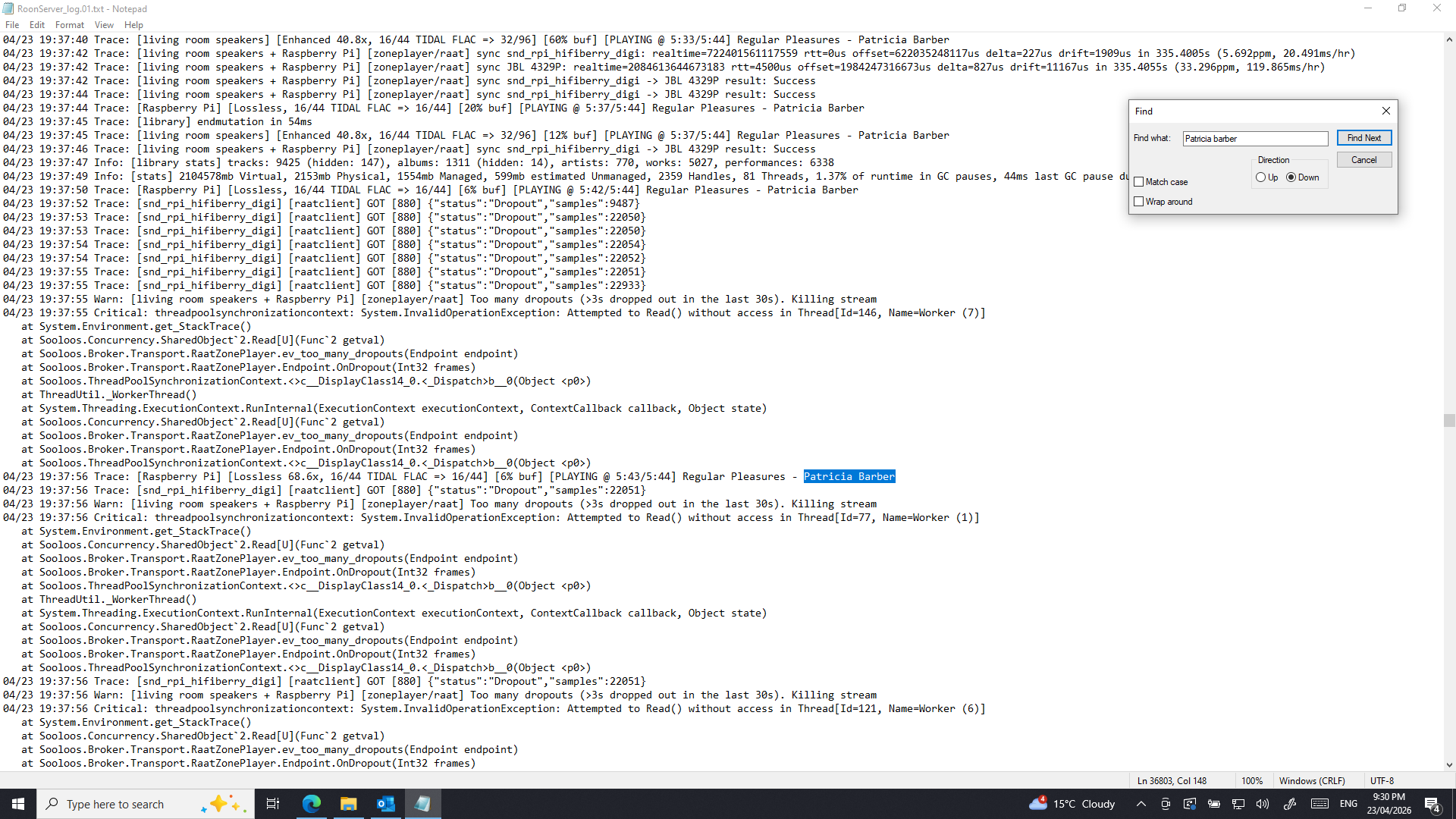

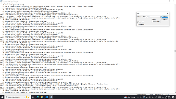

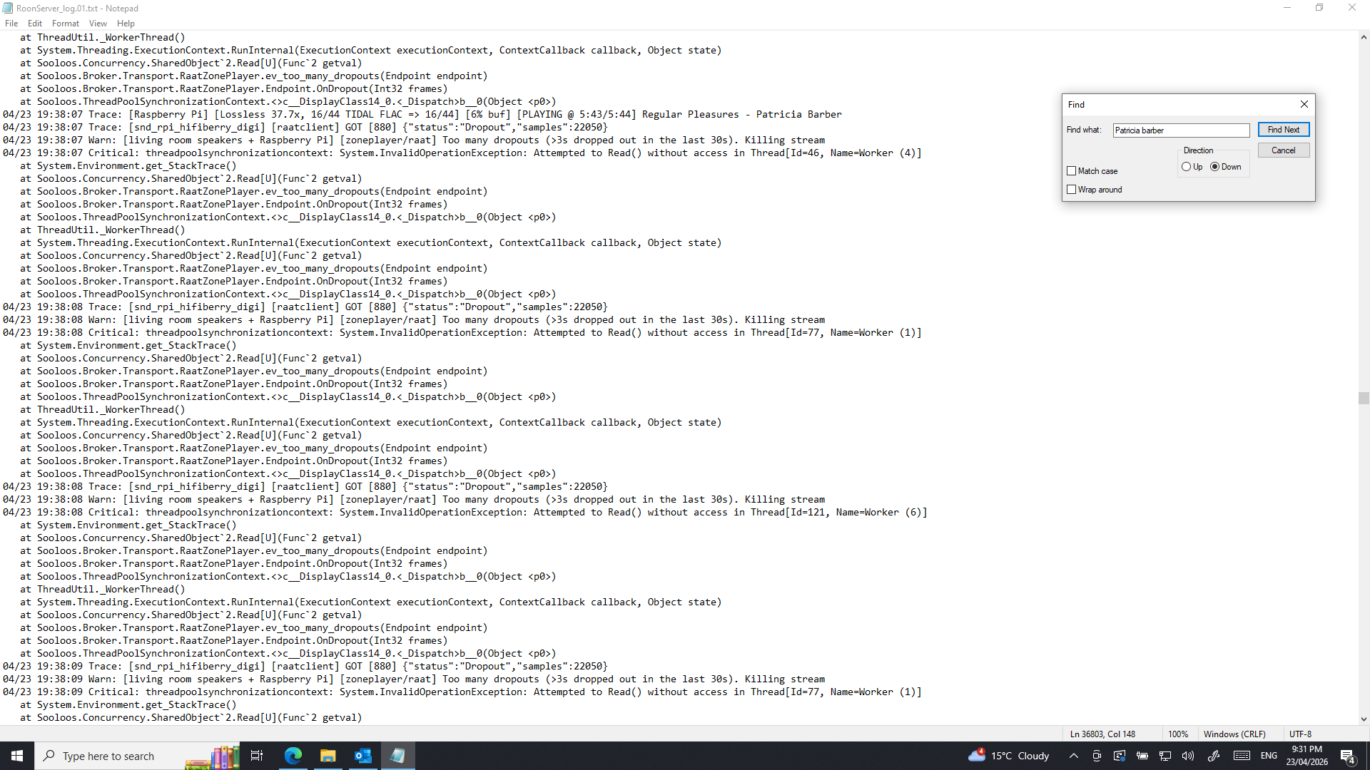

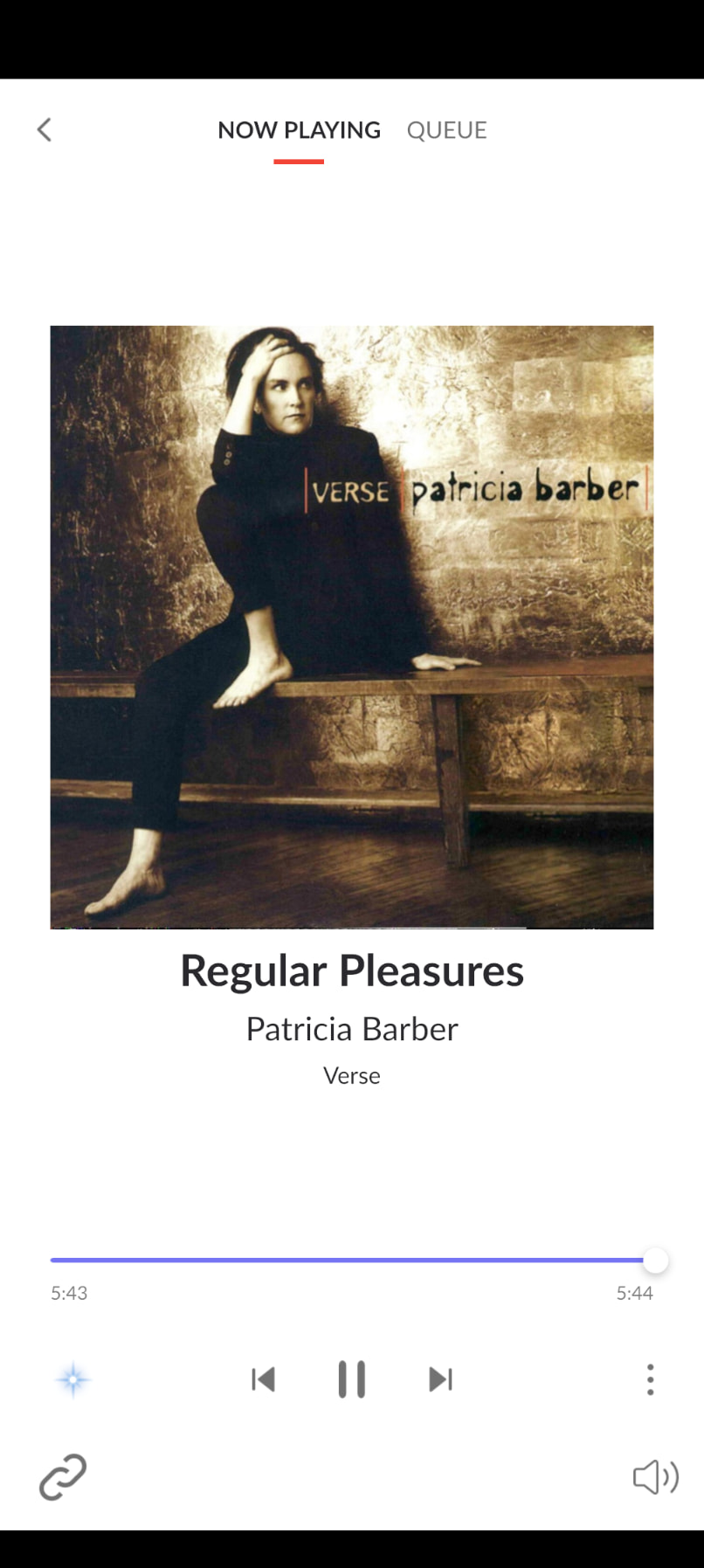

The above screen shots show the problem of Roon stopping at the end of a track and not advancing to the next track. I’ve tried to attach the log showing what is happening but it doesn’t seem to let me attach a text file. So here are some screen shots of the log file, It shows the track stuck at “[PLAYING @ 5:43/5:44] Regular Pleasures - Patricia Barber”

Thanks for the update, and for confirming that you are seeing the same behavior with Tidal as well. That lines up with what we found in the logs.
According to the logs, your computer hosting Roon Server is rendering the audio stream more slowly than real-time playback requires. To confirm whether that is the cause here, please disable Sample Rate Conversion and any other Signal Processing, then try playback again.

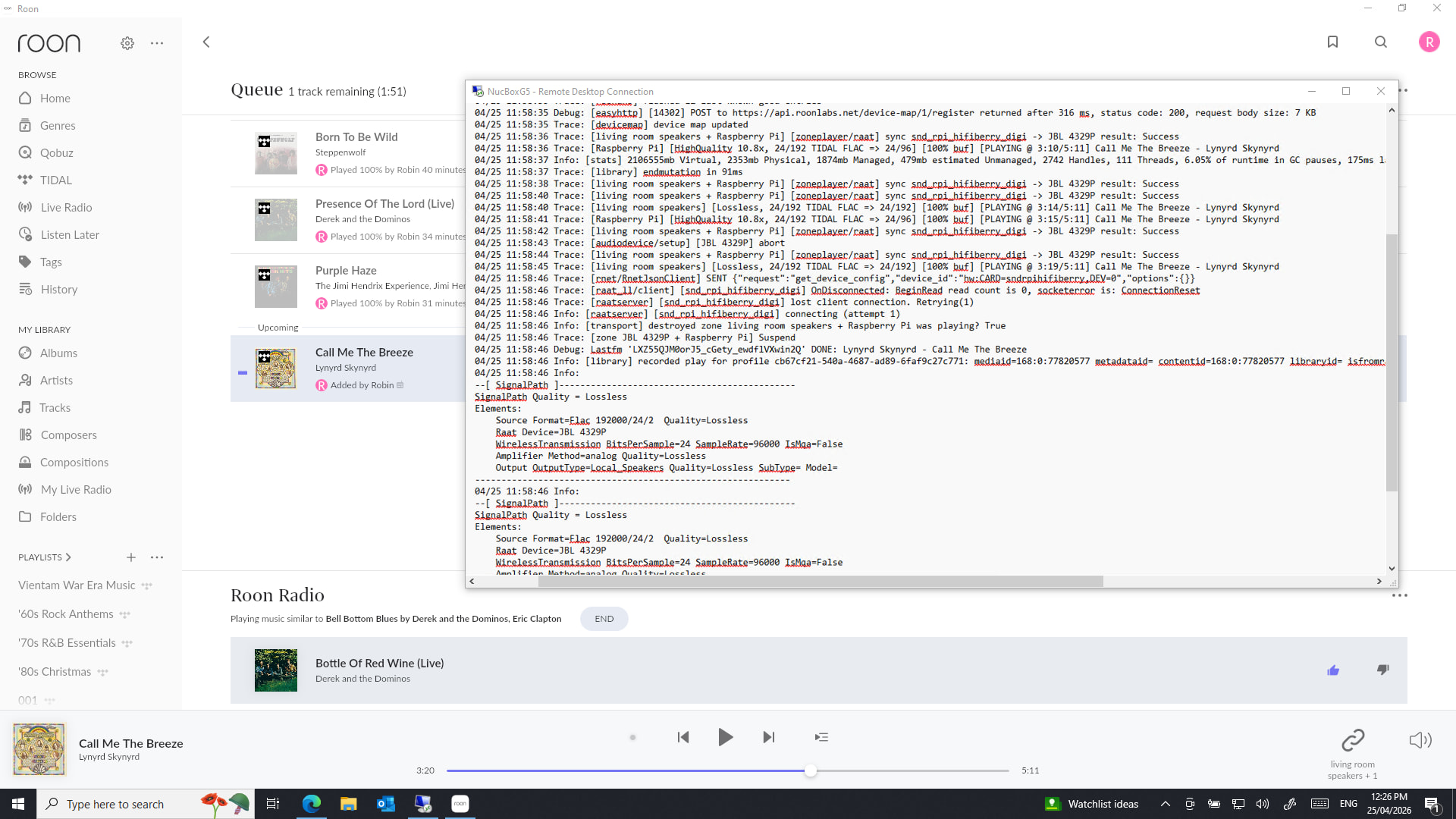

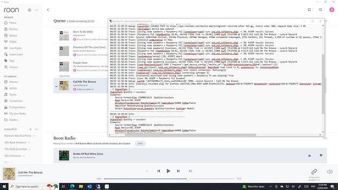

The only processing I had was Sample Rate Conversion for the JBL 4329’s. I turned this off but still got the problem of Roon stopping. Attached is a screen print of the log file showing Roon "[Playing @ 3:19/5:11] Call Me The Breeze - Lynyrd Skynyrd”. Then it seems to loose connection to the Raspberry Pi and stops.

Thanks for the follow-up and additional information! Based on the analysis of your Roon Server logs, the issue is directly related to network synchronization within your grouped zones.
The logs confirm that when your devices are grouped, the system encounters critical timing errors that force Roon to “kill” the stream to prevent playback from drifting out of sync.
