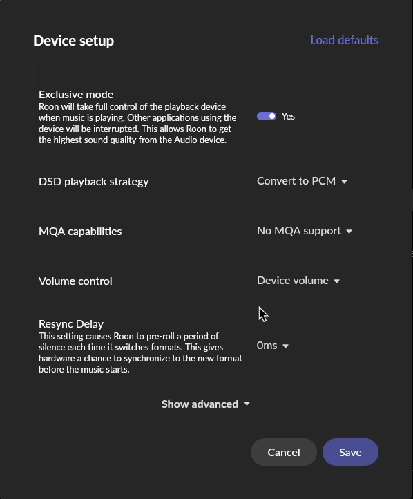

Please show us screen shots of signal path and device setup.

Maybe try setting fixed volume and deselect integer mode, just in case…
And also give it a shot without any DSP enabled, so do away with volume leveling and convolution.

Will try the fixed volume and deselecting integer mode, and without DSP.
