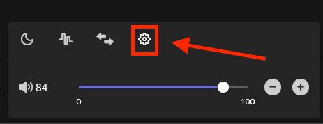

Hi @Peter_Goodman,
In Roon, enable your zone, then click the volume button followed by the cogwheel to access your Device Settings:

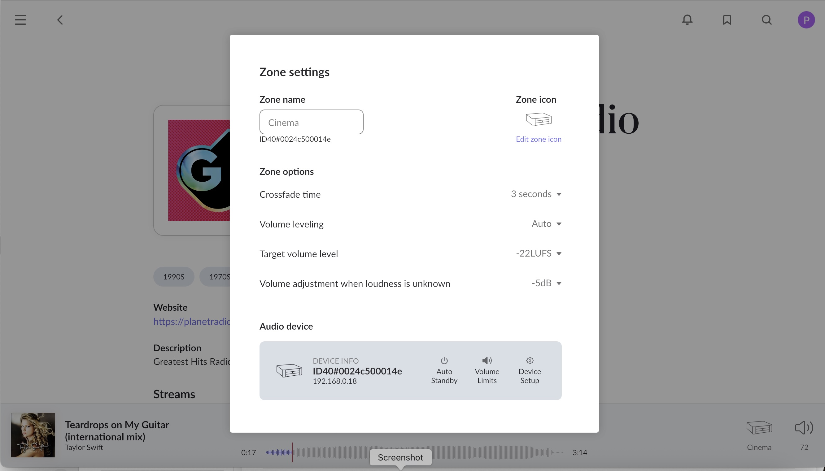

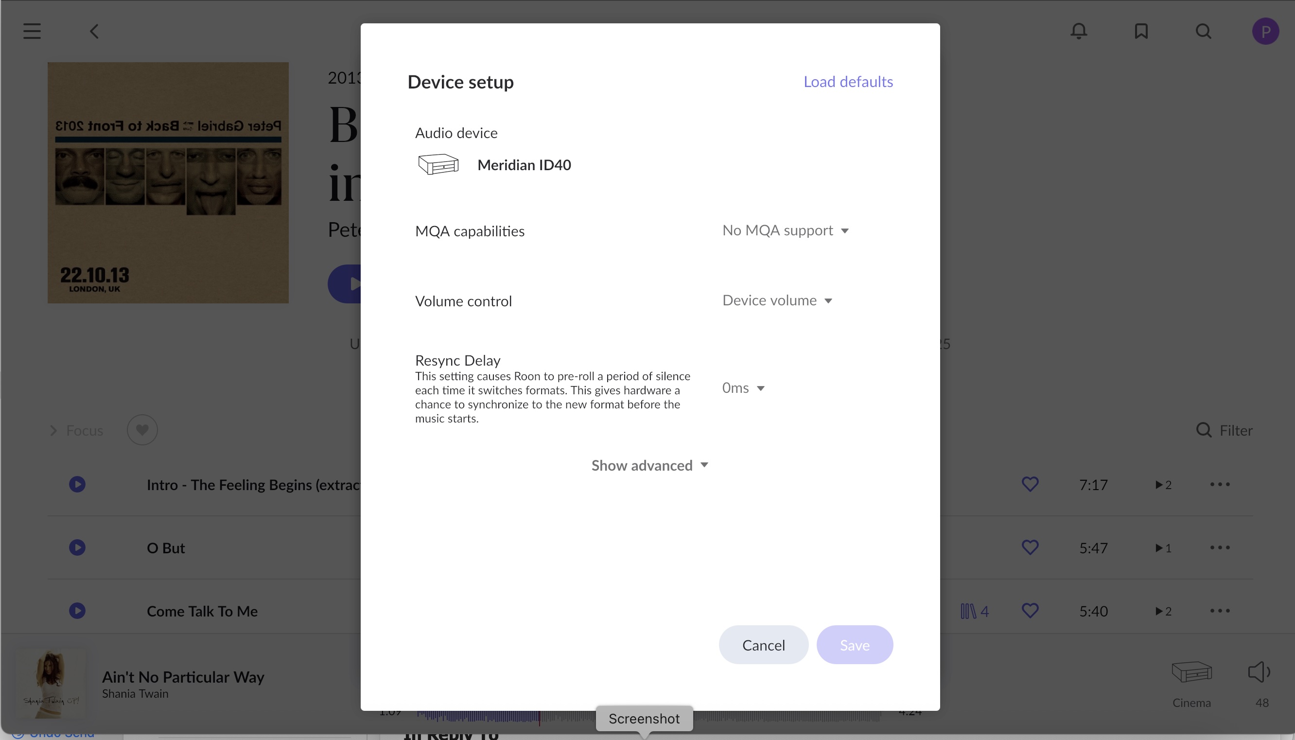

OK, here is the screenshot of the Device Settings you asked for. Regarding the DAC I guess this is the ID40 card which is in my Meridian 861 music processor? I have no idea how you access the details you have asked for. One other thing I notice is that there is background noise whenever I play any track. If I pause the track the noise stops after a few seconds?
Good day @Peter_Goodman !

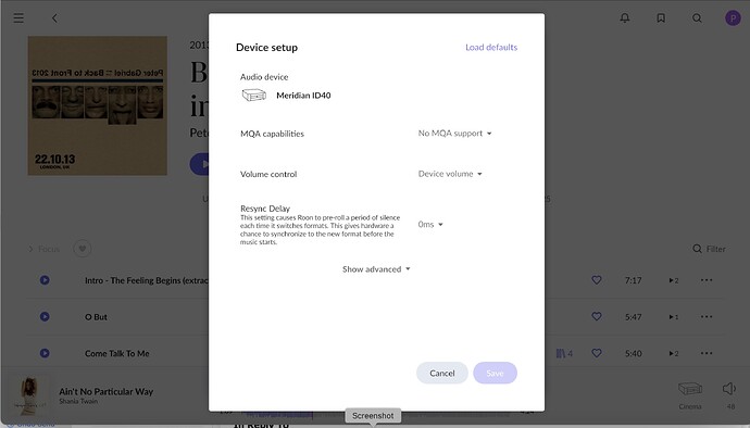

Сan you please tap on “Device Setup” option from your screenshot and share a photo from there ?
Also, can you please clarify, if you limit the sample rate to 48k, does it sound normally ?
Thanks !
Regards.
Hi Alex
Please see screenshot of the “Device Setup” as requested. I do not now how to 'limit the sample rate to 48k" so could you explain how to do this?

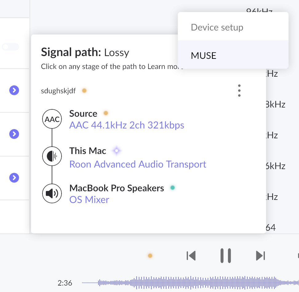

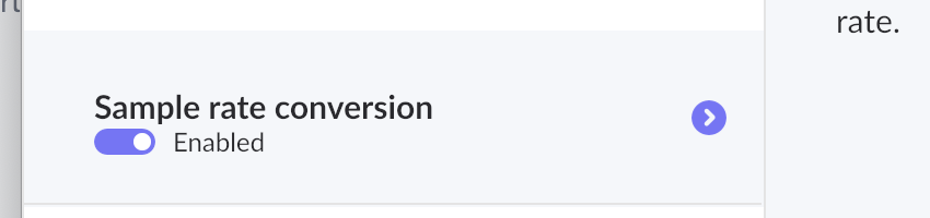

In order to convert the sample rate from 96 Khz to 48 you can open the signal path and proceed to Muse as on the screenshot below:

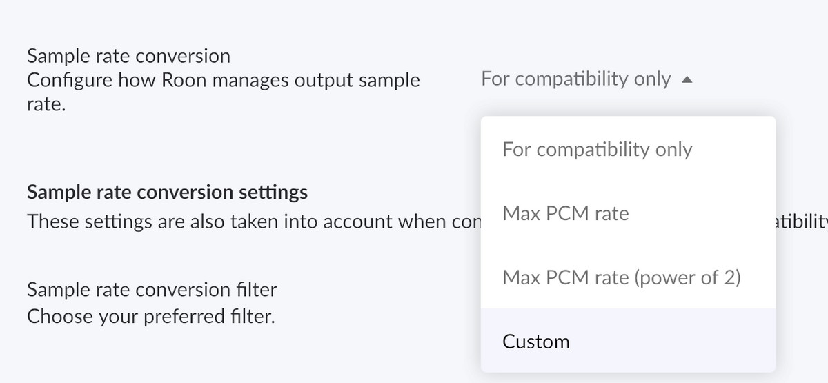

There please enable sample rate conversion like this:
And switch “Sample rate conversion” option to “Custom” value:

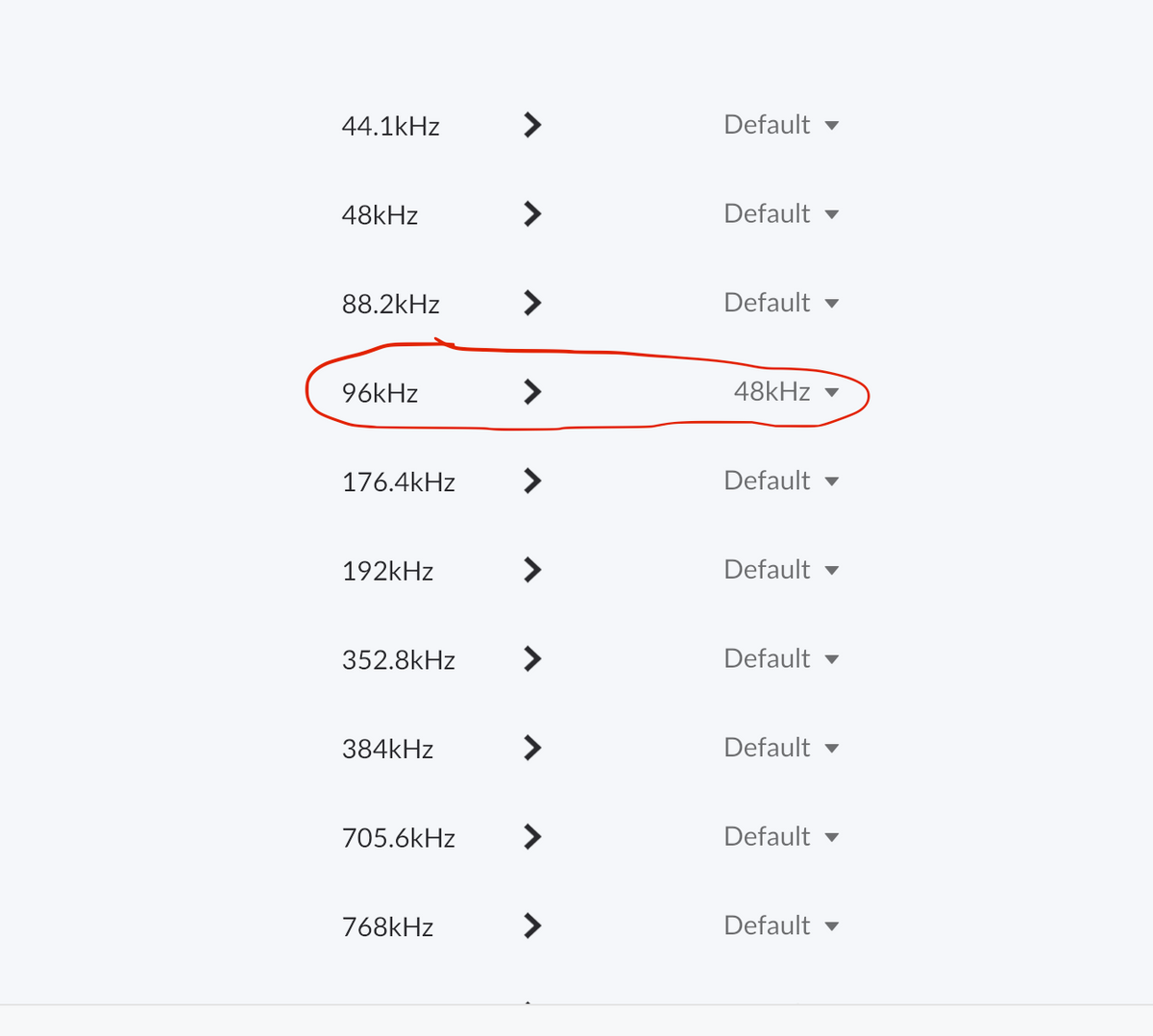

In your case please choose manually 96 khz to 48 conversion:
After that please let us know whether it changes playing behavior.
Regards.
Thanks Alex, I have changed it as advised and yes, it is now playing normally.
