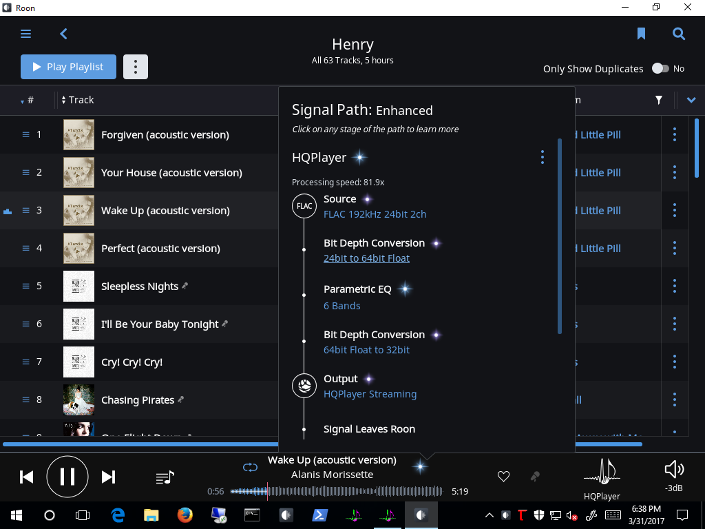

Here you go:
The first picture has the music bars moving and music playing. The first 4 tracks are 192-24 files
Core is running on Windows 10, all Roon components are up to date, HQPlayer 3.16
The second picture is taken after Roon gets to the 5th song which is the first DSD file on the playlist. the music bar keeps moving, but no music is playing. If I hit the next track button and then the previous track button, song 5 plays correctly, but the progress meter on the bottom advances very slowly, say 1 sec forward for every 5-7 seconds of music. When song 5 finishes playing, track 6 (also DSD) plays, but Roon does not advance to show that track 6 is playing. Once track 6 is finished playing, the music stops again. If I then hit next track, track 7 (also DSD) plays. After track 7 finishes, track 8 (also DSD) plays, but Roon does not advance to show track 8 playing. If I turn off DSP Engine, all the tracks play fine. Lastly, for the steps above, I can get Roon to play again after it stops without having to reset connection to HQPlayer or restarting HQPlayer.
