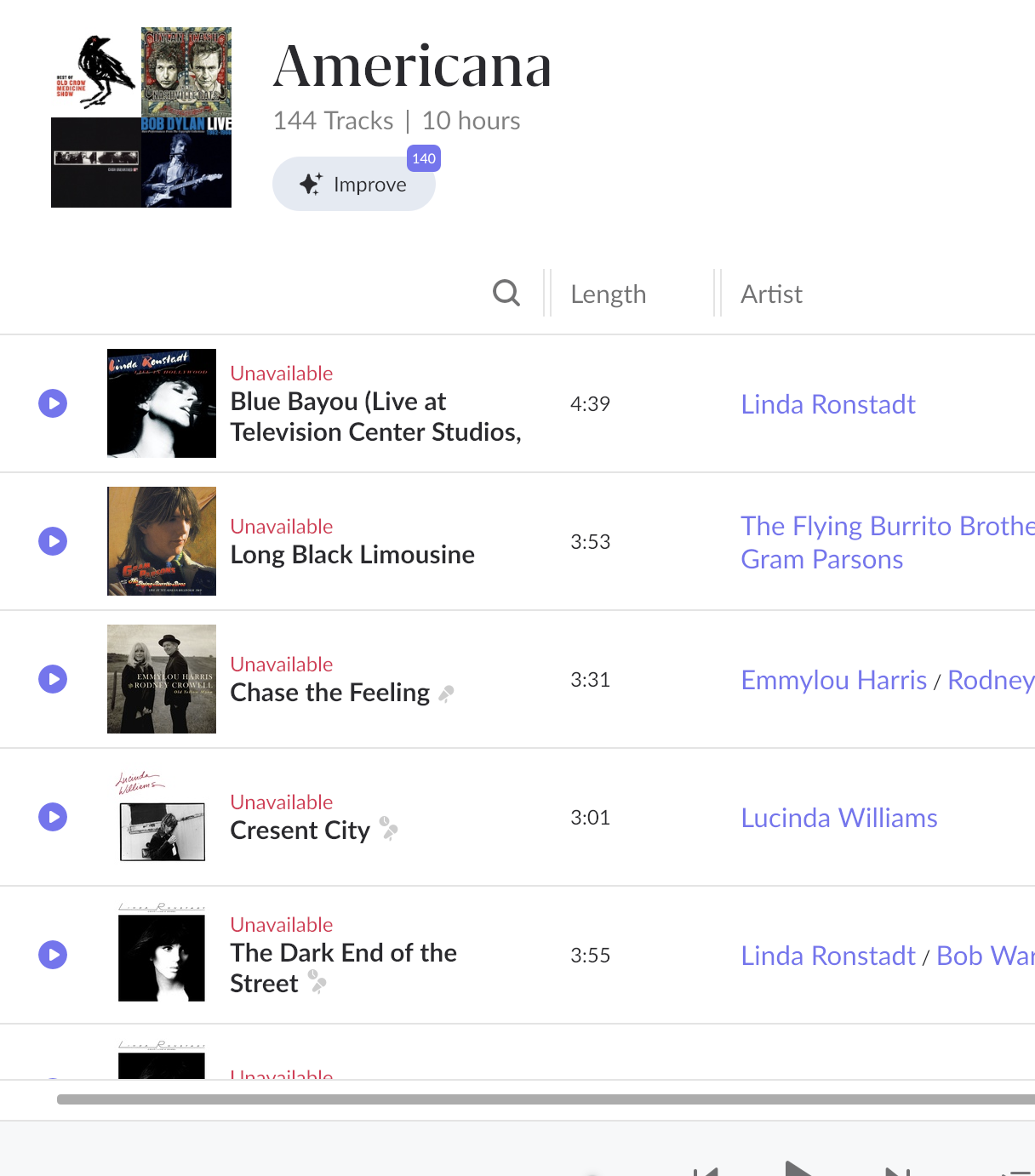

· At the suggestion of my AV vendor, I replaced an aging QNAP NAS with a Synology NAS. Music files were copied over but my ROON playlists are visible but nothing is inside. I'm able to play music from the library but not from my playlists. The playlists were developed solely from my library and do not contain any streaming services music.

Roon playlists and edits are stored in the Roon database, not in the music files themselves. Since the database was not restored from your QNAP, the playlists are visible but appear empty — this is expected behavior.
