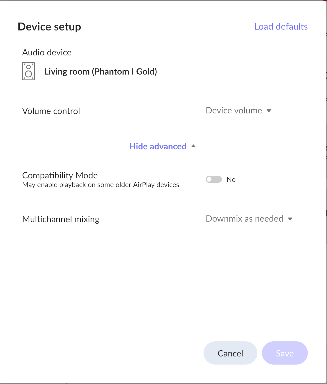

Than you for reaching out to us for help with this issue. @Mike_LC makes a good note about volume limits. It’s a good idea to have those set for all of your audio devices. To figure out why this is happening can you please share a screenshot of your device settings in Roon for the Devialet? There are a number of volume settings that can be adjusted to address this issue.

Hi @Knut_Rorbakken,
Thank you for the screenshots. I think setting fixed volume and controlling the volume level from the Devialet remote would be the best choice to avoid the full volume issue. Fixed volume has Roon send out a fixed level signal and let’s the receiving device control the actual outputted volume level. Can you try that and see if it works for you?
