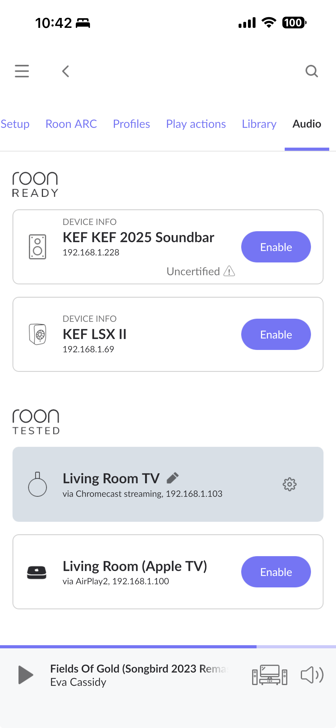

Hi @benjamin,
Yes, I’ve had the KEF XIO configured as “via Chromecast streaming”, see screenshot below. The other available option is to stream “via AirPlay2”. How does one stream via a “network connection”? What does that mean? Also, is streaming via AirPlay worse in terms of quality, should that be my next step?

Hi @connor,
Thanks for this. The only two options that I see under “other networked devices” relating to the XIO are Chromecast (which I was previously connected to and was having issues with) and Airplay2. You can see them both in the screenshot above. The issues I’ve been experiencing have been coming up on the Chromecast connection. Over the past few days I’ve been playing through the Airplay2 connection and have not experienced any drop outs. I have not adjusted streaming quality.

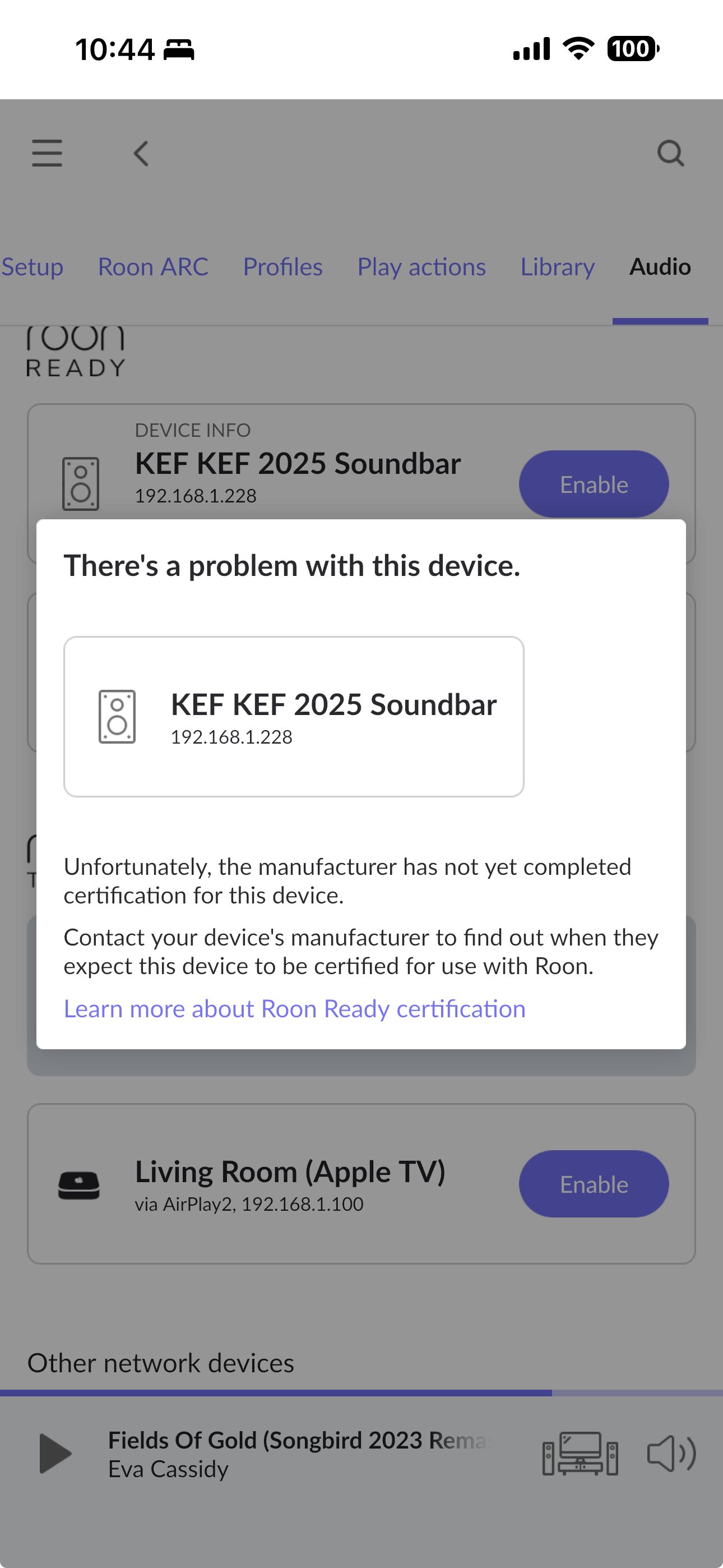

My only other option to connect to the XIO appears under the “Roon Ready” section (screenshot below), but when I click “Enable” I get an error message for this (screenshot also below) saying that the manufacturer has not yet completed the certification for this device. I reached out to KEF about this and they replied as follows: “There is no specific plan or date as yet but I’ll certainly add your service suggestion to the other customers for future consideration.”
Does this mean that my only option here is to listen through Airplay2?

Hello @David_Fasman ,
Thanks for letting us know that Airplay is working as expected. It does seem like there is something related to the Chromecast playback that is going wrong, so using Airplay until the Roon Ready certification is complete does sound like the best option for the time being. There are also a few other things you can try to see if they help, you can try to restore the factory defaults on the XIO, and try to stream chromecast audio from another device to the XIO see if the issue reproduces. It’s also possible that a setting related to your router is causing Chromecast to fail more often (such as IGMP Proxying/Snooping).
