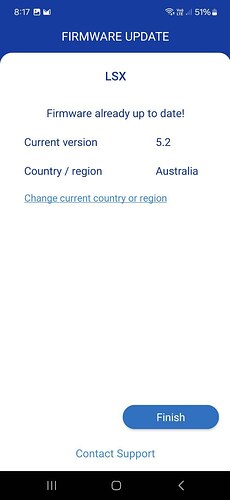

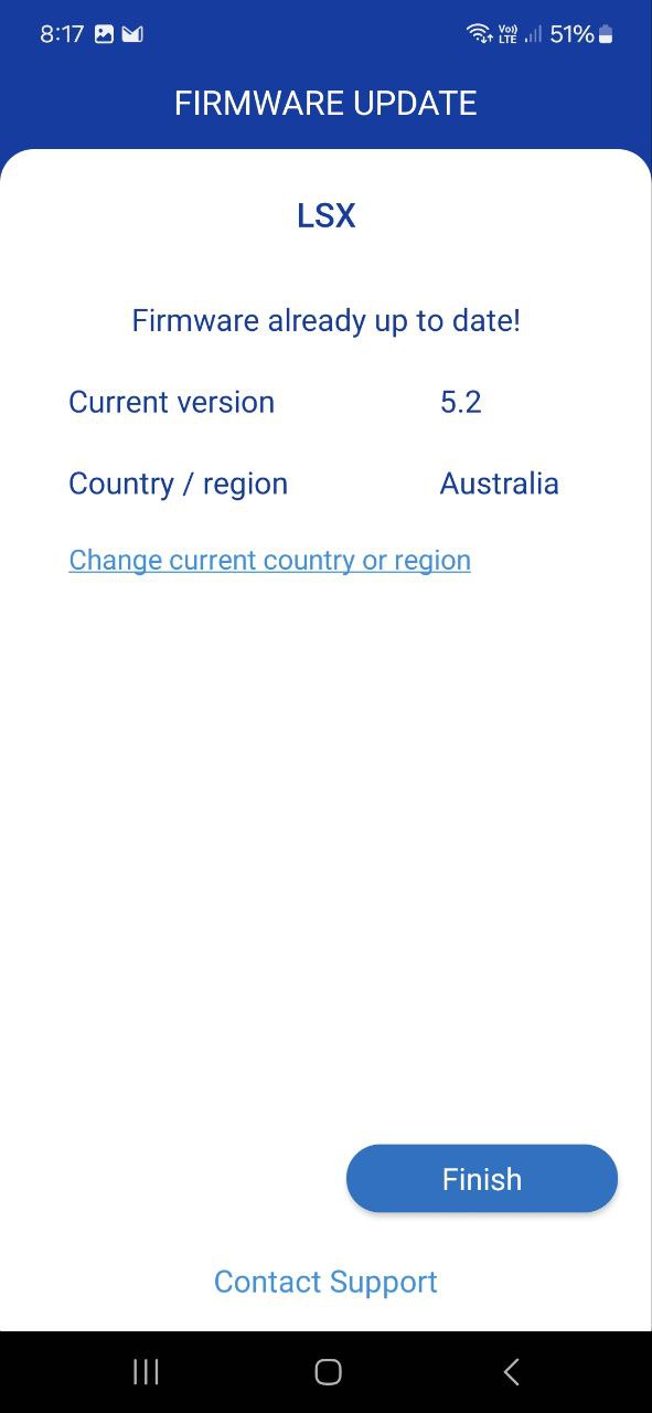

Can you be more specific with the firmware version? We had difficulties finding any recent update it regards to the LSX.
And my apologies if this has been glazed over, but are you able to maintain playback when using the system output of one of your remote devices? I see you have a few available you should be able to temporarily test with - let me know if this is possible, thank you! :raised_hands:
Hi @benjamin
KEF LSX are running version 5.2 of firmware.

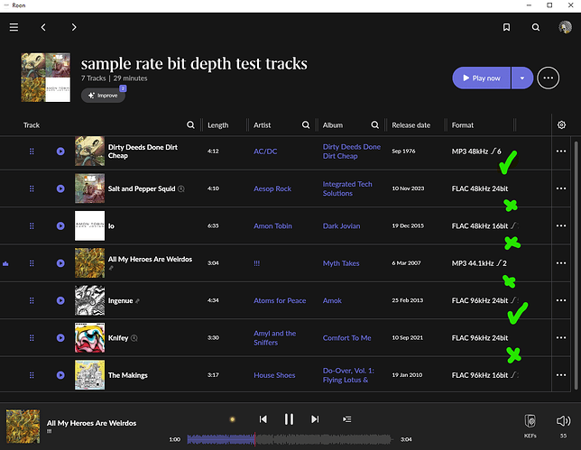

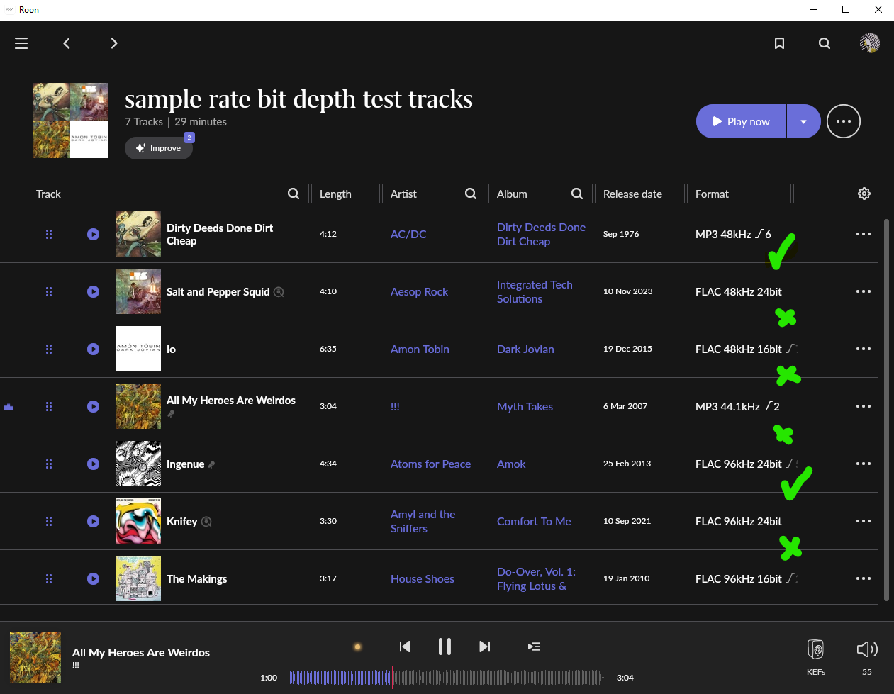

I have the same problem. I have test when I play the music sample rate is 96/24, if next music is 96/24 it will play the music. If next music is other sample rate such as 44.1/16. It will not play the next music.
Hi @Jaypee_Yeung . This seems to be what I’m experiencing as well.
I’ve created a playlist with different formats to test.
This has a combination of MP3s and FLACs, with various bit depth and sample rates, also local and streaming files.
Interestingly, the local 48kHz mp3 transitions to the 48kHz FLAC without issue.

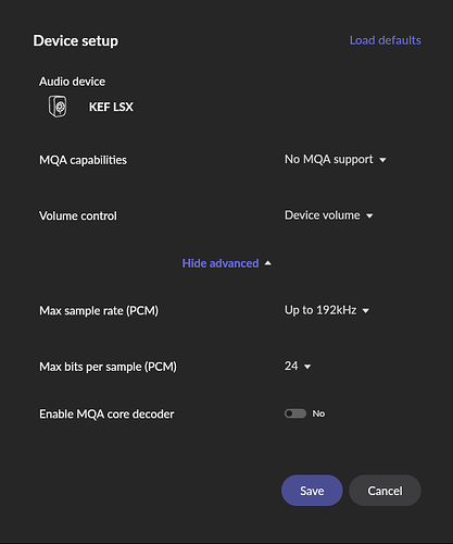

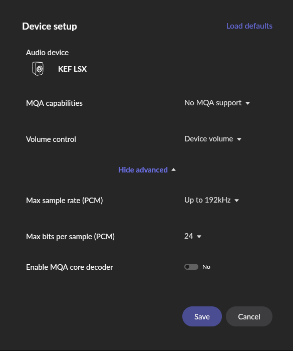

The KEFs are set to 192kHz max sample rate and 24 bit max bit depth.

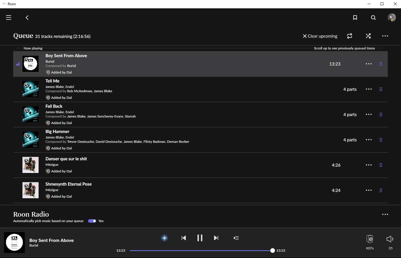

In my experience, I start playing a playlist and sometimes I see what I call a “Knight Rider effect” on the progress bar for a few seconds as if Roon is trying to load the track and then it stops. Sometimes it plays for hours without issue and sometimes is a per track occurrence.
Right now I was playing said playlist and it was working fine. I had to lower the volume to hear a video and now it’s on a track per track and “knight rider effect” mode.
I’m beginning to wonder if this problem is volume level dependent or something…
