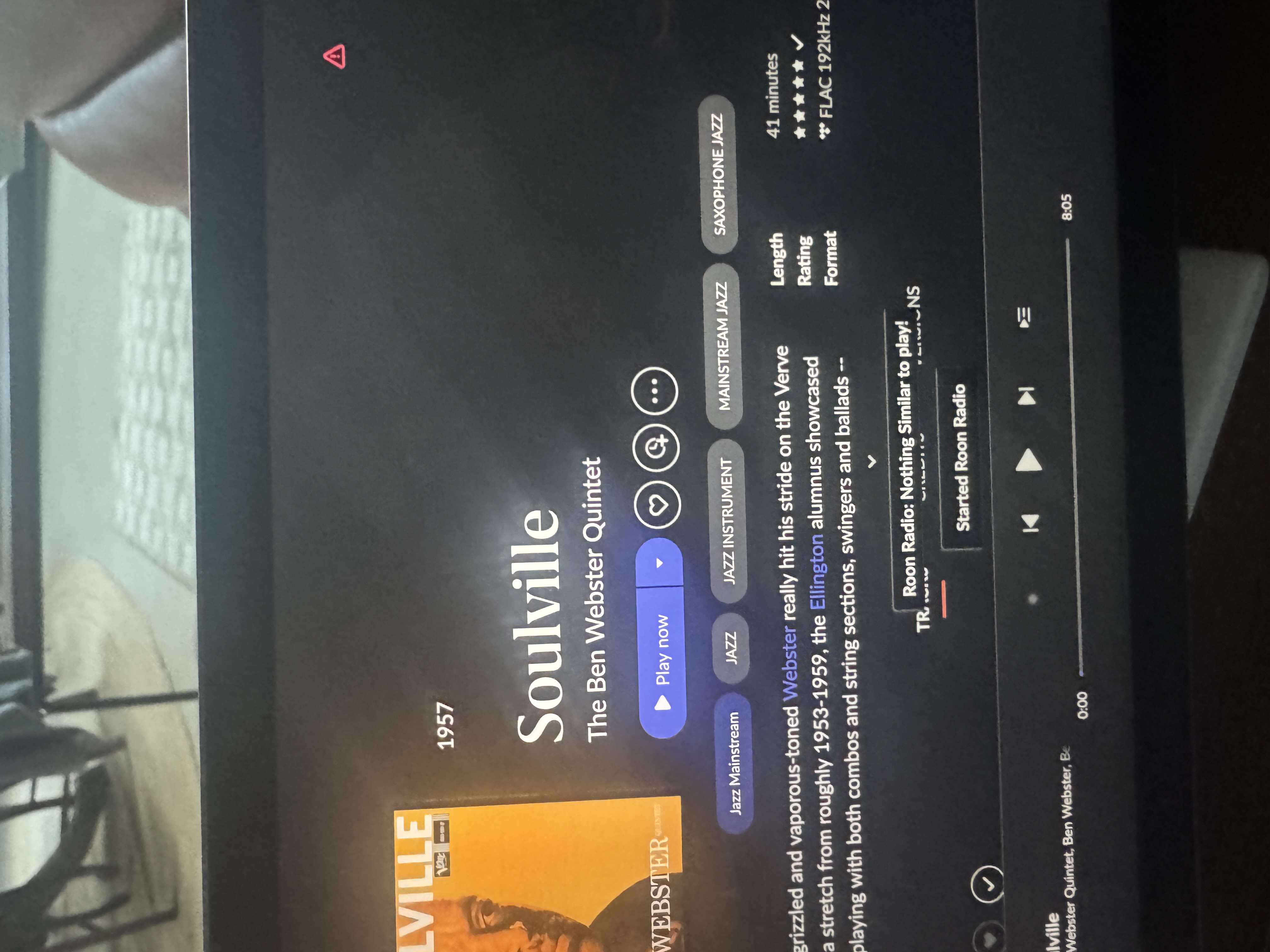

When I have an album open and click "Start Radio" from the Play Now button, i am told a) Starting Roon Radio, b) Nothing Similar to Play and then Roon stops. This happens to Albums imported from Tidal, Qubuz and from my SSD library.

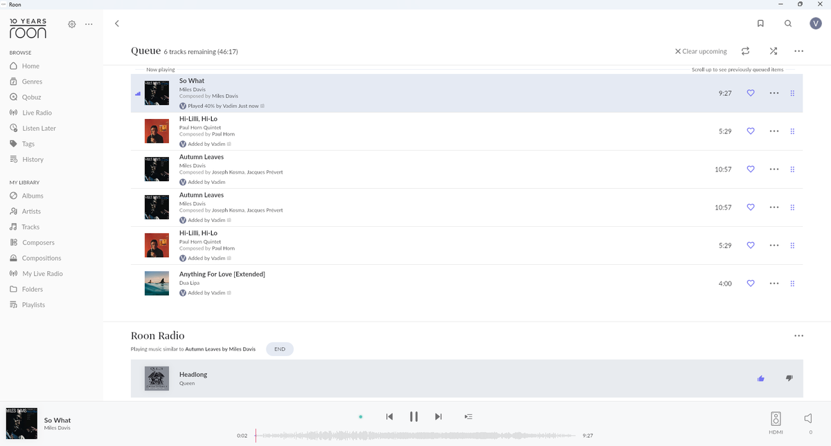

I have uploaded some pics of files that i tried this AM, but did not work. Please let me know if the pics are sufficient, or if you need something different.
Hey @hshrader,

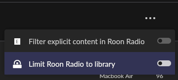

Thanks for sharing the screenshots! The first thing to check - within your queue screen, do you have your Roon radio settings enabled to only filter library content?

  • Limit to Roon Radio was NOT selected.

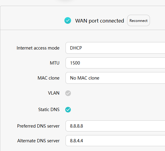

Thanks for including all of the above! Could you test out temporarily changing your DNS settings on your Roon Server machine, as well as router?
We have seen users have a better experience in the past if they change their Router’s DNS servers from the ISP provided ones to Cloudflare DNS, Quad9 or Google DNS. Can you please give this a try and let me know if it helps?

I have been trying to change the DNS settings on my modem, but with no success. Seems it would be a simple fix but it is not. Maybe i need to buy a new modem?
In any case, what is your sense of probability that a DNS address of 8888 or other suggested will fix the issue?
Hello @hshrader,
Would you kindly share your modem model and manufacturer? I will try to find the appropriate guide for you to change the DNS settings.

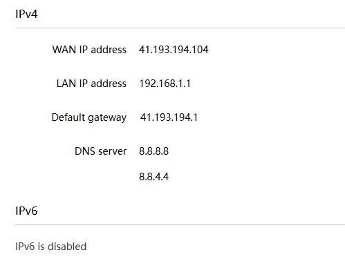

Hi - i was dumb. I have changed the DNS to 8.8.8.8 and secondary to 8.8.4.4
This has made no difference - i get the error “Nothing Similar to Play” from the Album Play Now button. Also, Roon Search is not working: I search Miles and get the message “Cannot connect to Roon Search.” Other web functionality might also be affected, but am not sure as i just made the change.
And incase this helps:

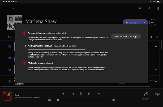

Update - Roon Search is back this am…
Hi @hshrader,
Good to hear your search is back! Based on your description, it does sound like a network inconsistency taking place.
