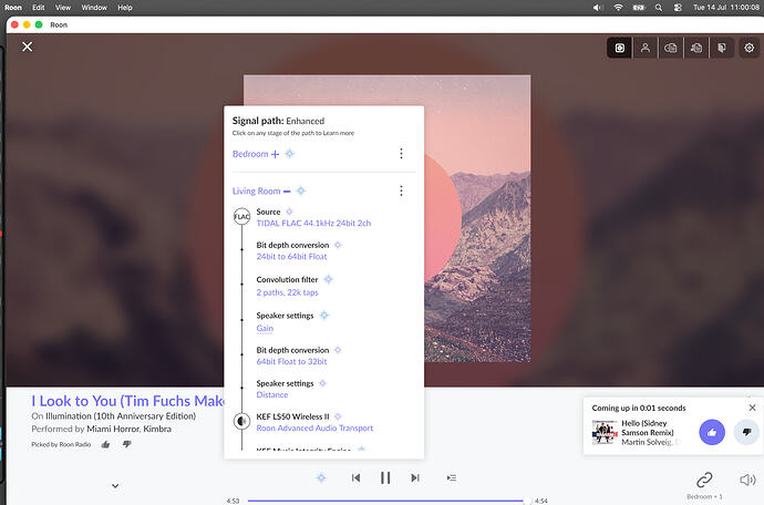

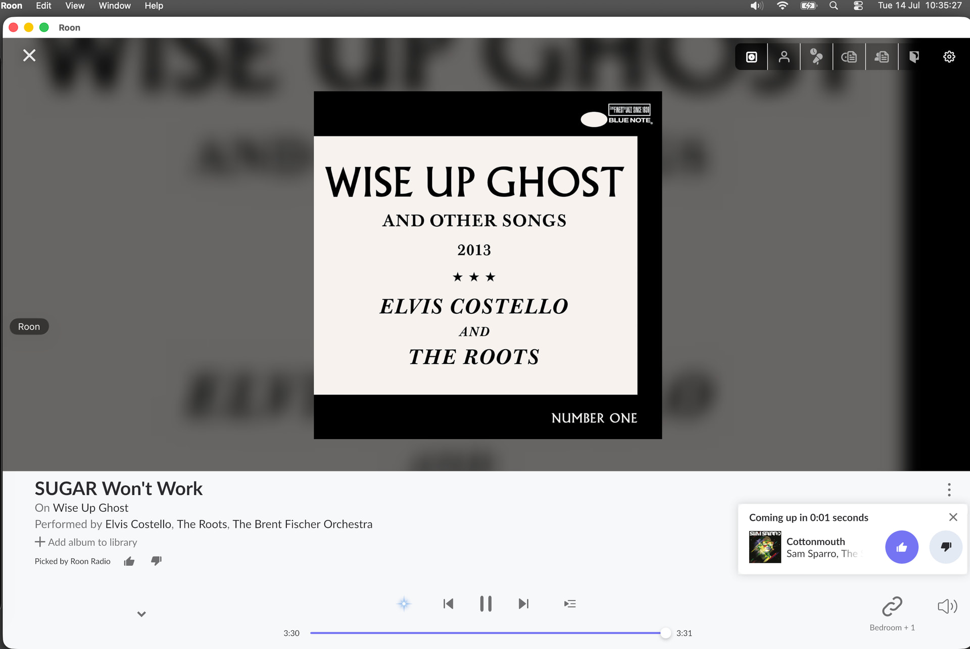

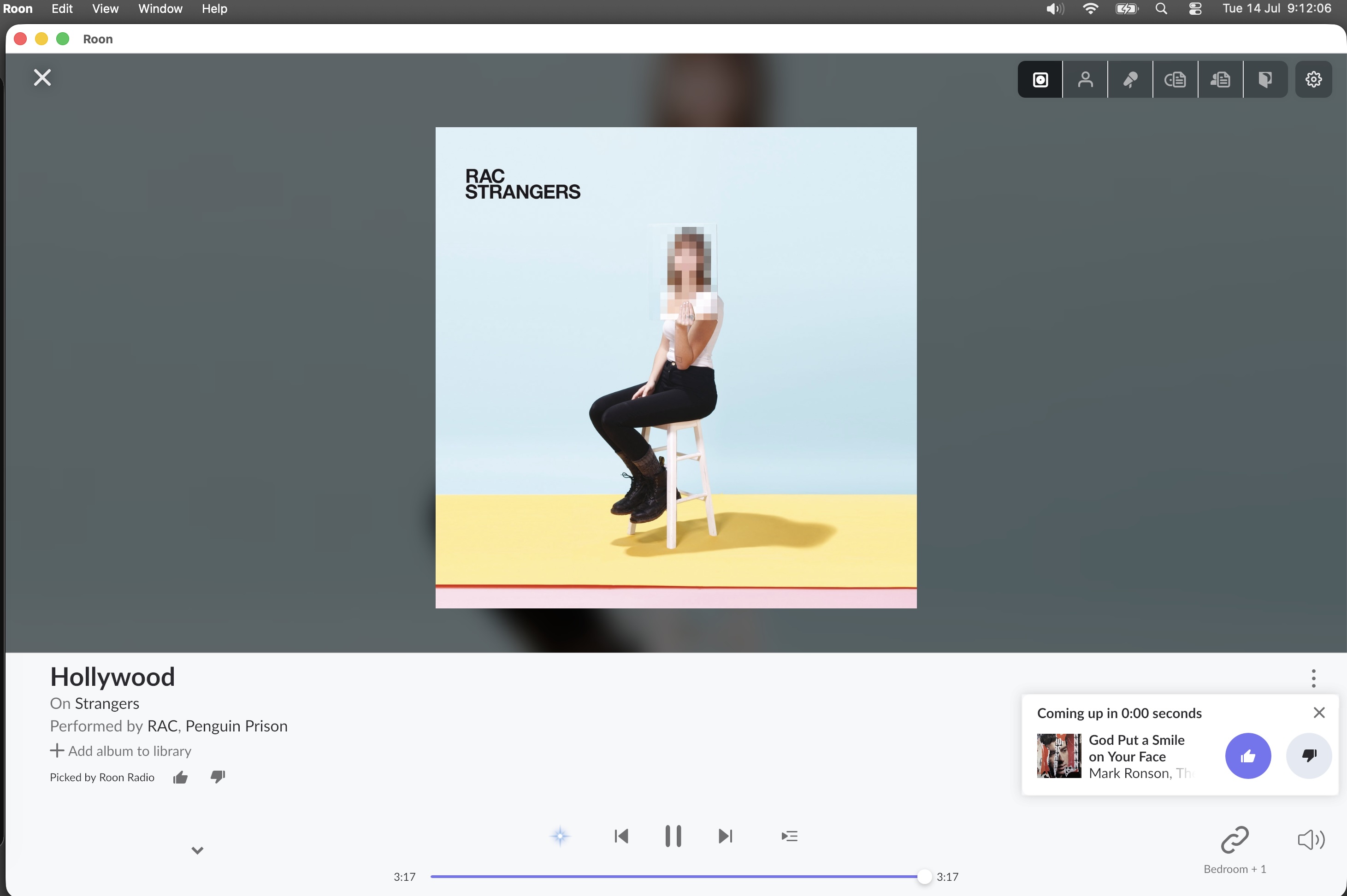

When using Roon Radio with grouped playback the audio stops playing at the end of the current track often, the upcoming track pop up shows but it doesnt play and the interface is not showing paused

What kind of grouped Zone are you playing to in this screenshot (Chromecast, Airplay, Roon Ready, etc.?)
From your last report, these were KEF speakers using Chromecast. If that’s still the protocol here, it’s worth noting that the team has a constellation of tickets in the pipeline to stabilize issues with Cast, which might affect this.

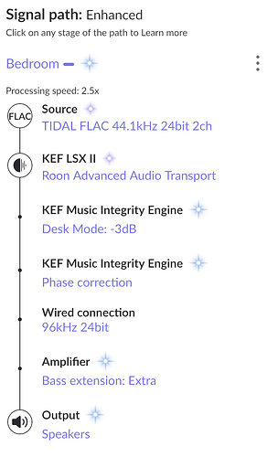

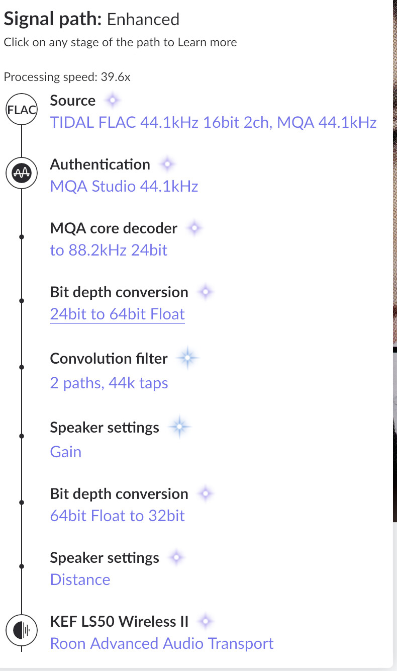

Can you share a screenshot of the Signal Path when this issue occurs?
Hi @connor
I gave up on Chromecast.
This is Roon Ready on both sets of speakers.

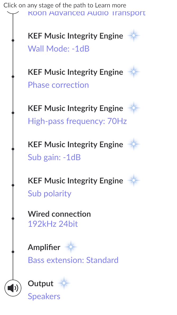

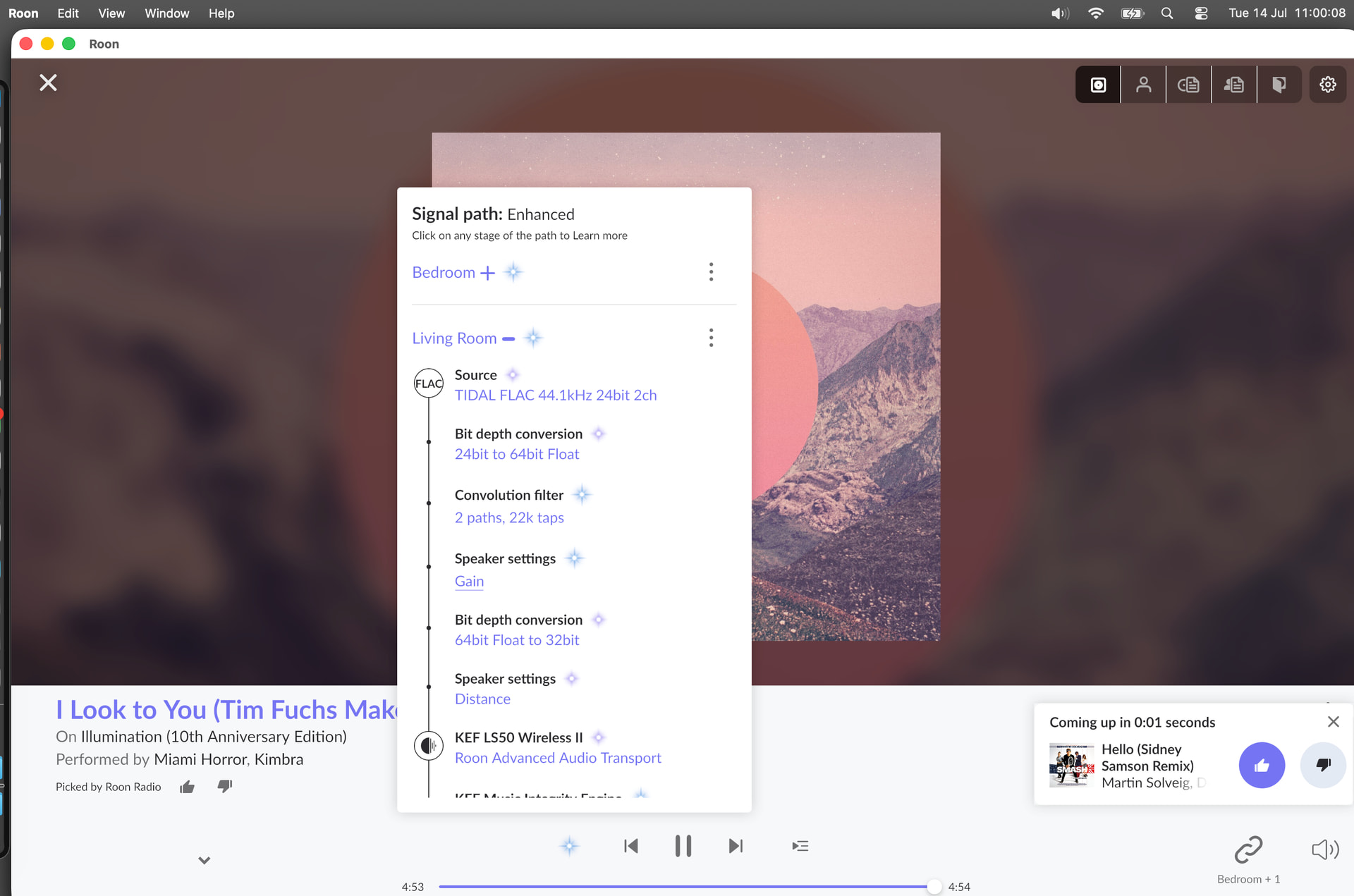

This is a screenshot of the signal path for one pair of speakers during playback whole grouped.
Just happened again at 10:34 am

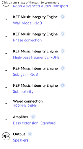

Signal path for the other speakers while they should be playing but aren’t:
again at 10:59am

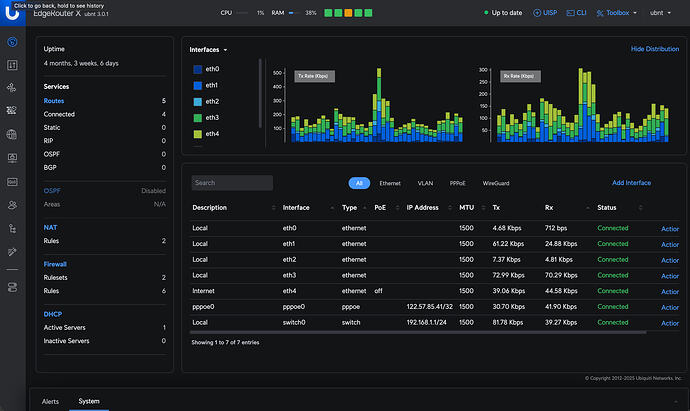

Please could you send a screenshot of Settings, then Networks, then your LAN network, showing the advanced or multicast section. IGMP Snooping lives there rather than in the general router settings, and the layout changes between UniFi versions, so we would rather see it than guess.
And we never got the result of the earlier test with all processing disabled, both MUSE on our side and any processing on the KEF side. If you tried it before your holiday, please let us know what happened.
Hi @vadim
Thanks for your reply.
I have disabled MUSE but I didnt want to change any KEF settings as I have those setup nicely and there is no simple on off switch, so I would just be changing to different settings really rather than disabling anything.
It turns out IGMP proxy was actually already off.

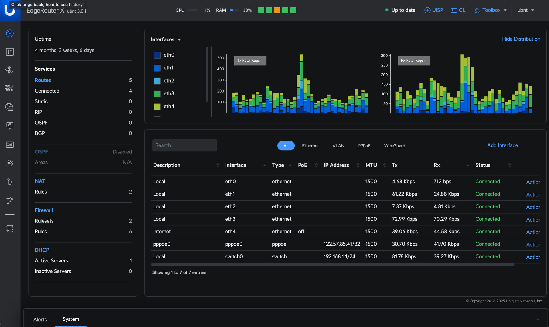

Im not sure where you want me to go to check for IGMP snooping. Here is a screenshot of my router settings. I dont see any LAN settings per se.
