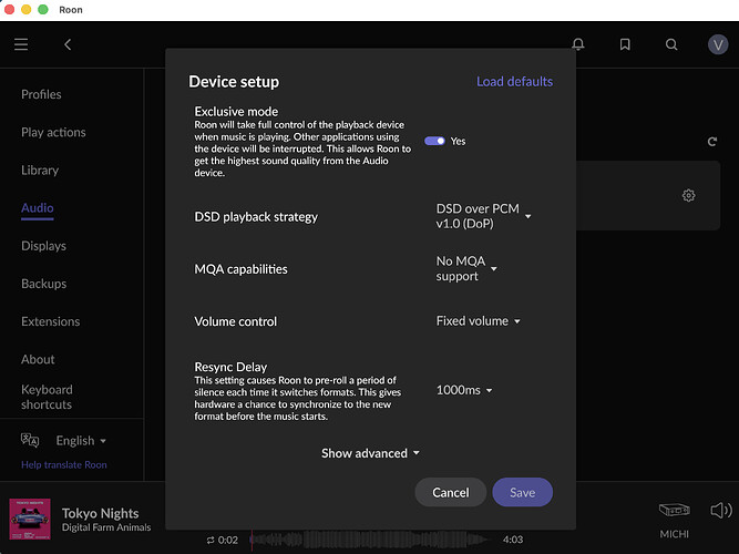

Because the MICHI seems to be taking too long to physically "click" over to the new sample rate, we need to tell Roon to pause for a moment between tracks of different resolutions.
  1. In Roon, go to Settings > Audio.
  2. Click the gear icon () next to your MICHI USB Audio 2.0 zone and select Device Setup.
  3. Click Show Advanced.
  4. Look for the setting called Resync Delay.
  5. Change this from 0ms to 1000ms (or even 1500ms).
This adds a 1-second buffer of silence only when the sample rate changes. It gives the DAC's internal clock plenty of time to fully lock into the new frequency before Roon starts sending the audio stream.

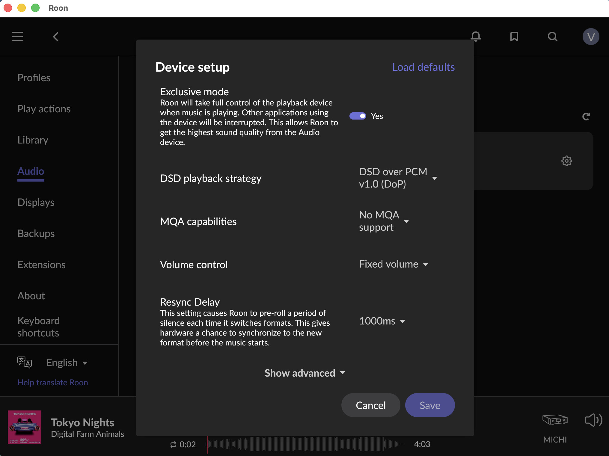

Hello
Thank you for your reply @vadim
I tried to fix as per your mention but it didn’t works as it should
at first I change Resync Delay to 1000ms the playback sped-up at timestamp
BKK May 22 09:04
Second tried to change Resync Delay to 1500ms the playback sped-up at timestamp
BKK May 22 10:54
Third tried to change Resync Delay to 3000ms the playback sped-up at timestamp
BKK May 22 17:36
I not sure that I do it right, the problem is still remain
So I had already upload the logs following your instruction last time
That you can check and please fix this problem :smiling_face_with_tear:

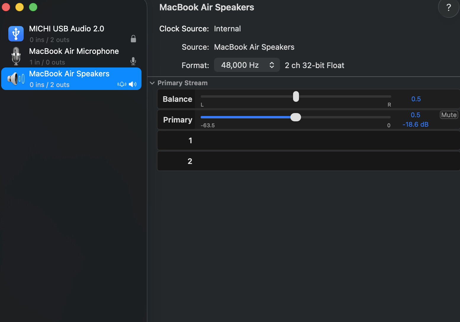

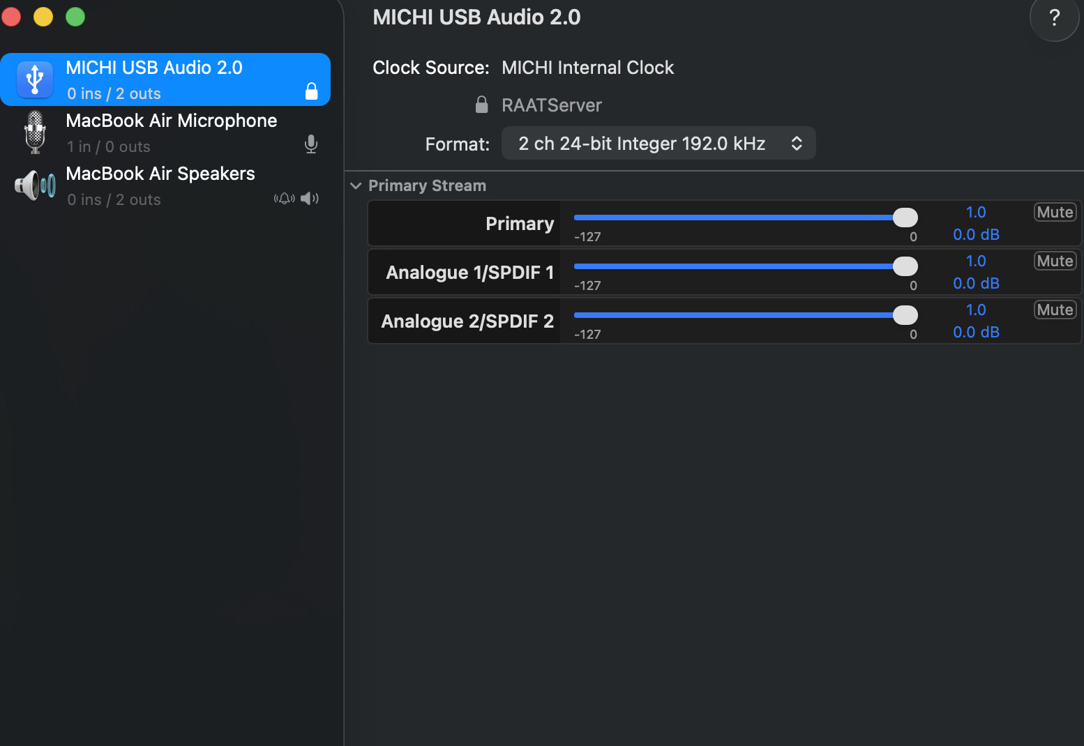

Can you share a screenshot of your Audio Midi setup utility with the DAC connected? This is in MacOS Applications → Utilities.
Hi @connor
I took a screen shots please look into it
Kind regard

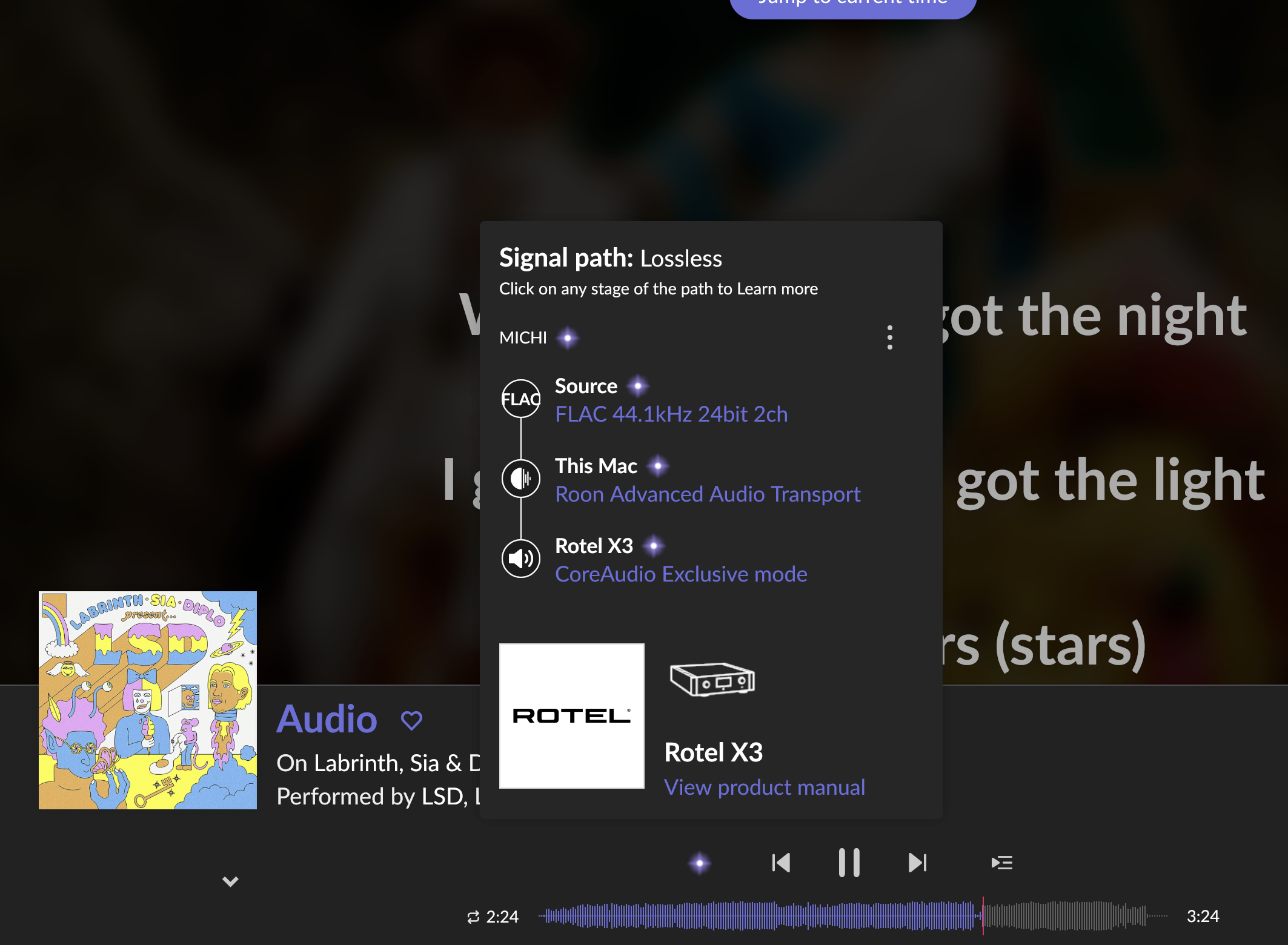

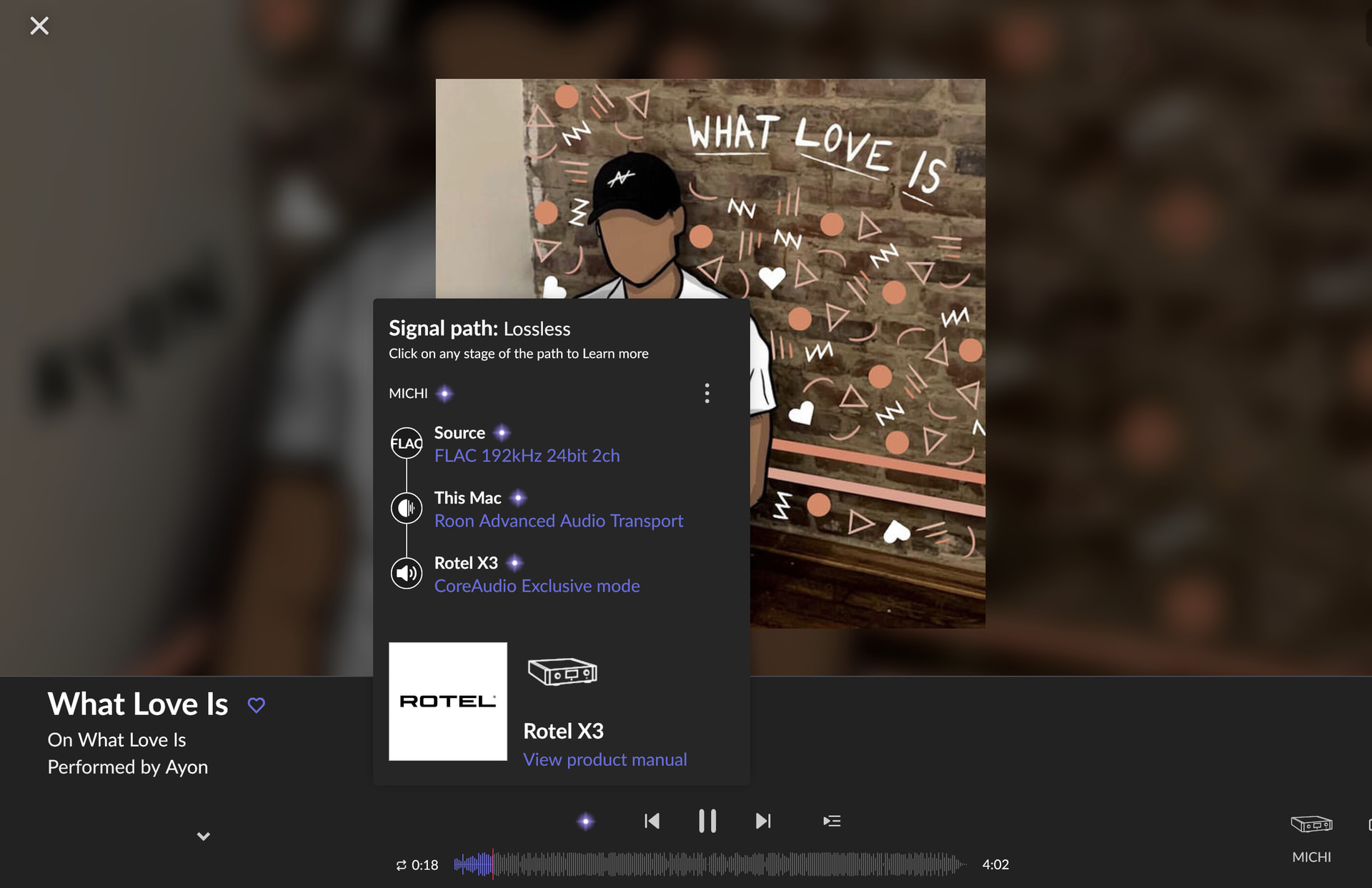

Hey @Varanyu_Upapan,
Thanks for the additional information and screenshots! Your MICHI USB Audio 2.0 is clocked internally and running at 192kHz. At this rate, USB audio is extremely sensitive to timing issues on macOS.
Let’s see if the following help:
In Roon, enable MUSE/DSP and downsample to 88.2kHz or 96kHz before sending to the Rotel X3:
  • Go to the device's MUSE/DSP settings → Sample Rate Conversion
  • Set max to 96kHz
  • This removes the 192kHz USB stress entirely while still being hi-res

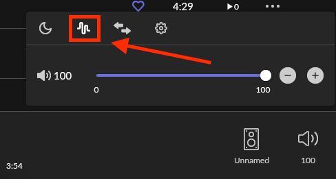

Here’s a screenshot on how to access MUSE from your specific enabled zone:
If that doesn’t help, test out disabling “Exclusive Mode” temporarily. You have CoreAudio Exclusive mode on. Try turning it off to see if the problem disappears, this helps isolate whether macOS’s CoreAudio driver is fighting Roon for clock control.
