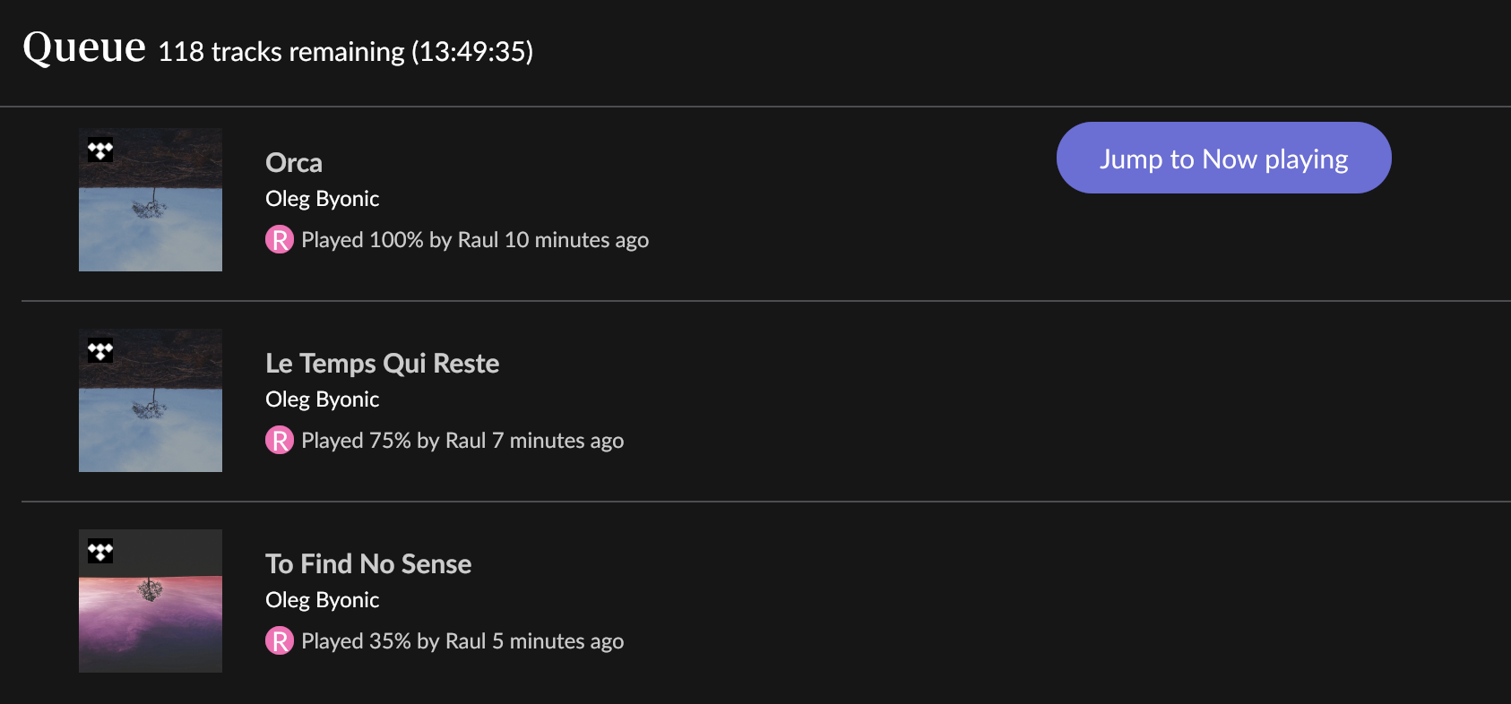

Roon occasionally randomly skips to next track
Mac mini Roon Core, TP-Link Deco mesh, 1Gbps Spectrum Internet

Issue just happened at 4:05pm PDT.
This happens on a Google Chromecast group involving all the speakers I mentioned above; the KEF speakers and Mac mini Roon Core are all wired ethernet to Deco mesh pods in their respective rooms, because I’ve had issues with KEF WiFi reliability in the past. The two Nest Audios are WiFi, with “Mesh Technology” disabled and tied to the 5 Ghz band. All the speakers, WiFi or ethernet, and the Mac mini Roon Core, have reserved IPs.
Happened again at 10:12am PDT.
Note this doesn’t happen on Spotify streaming to the same Chromecast group, and I don’t have issues streaming 4K content through my Apple TV (wired to the same Deco mesh pod as my KEF LS50 W2).
Again at 11:11am PDT.

Happened again at 5:42pm PDT. :frowning:
I created a new KEF-only group called “KEF Group”, without the Nest Audios, and it just skipped at 7:07pm PDT.
Lastly… Note this has never happened on Spotify streaming to the same speaker group, even if it’s the same playlist transferred to Tidal via Soundiiz.

KEF only Chromecast group skipped twice just now, first at 1:10pm PDT then again 1:12pm PDT.
The StoppedEndOfMediaUnnatural happens first then the INVALID_MEDIA_SESSION_ID, all within the same second.
