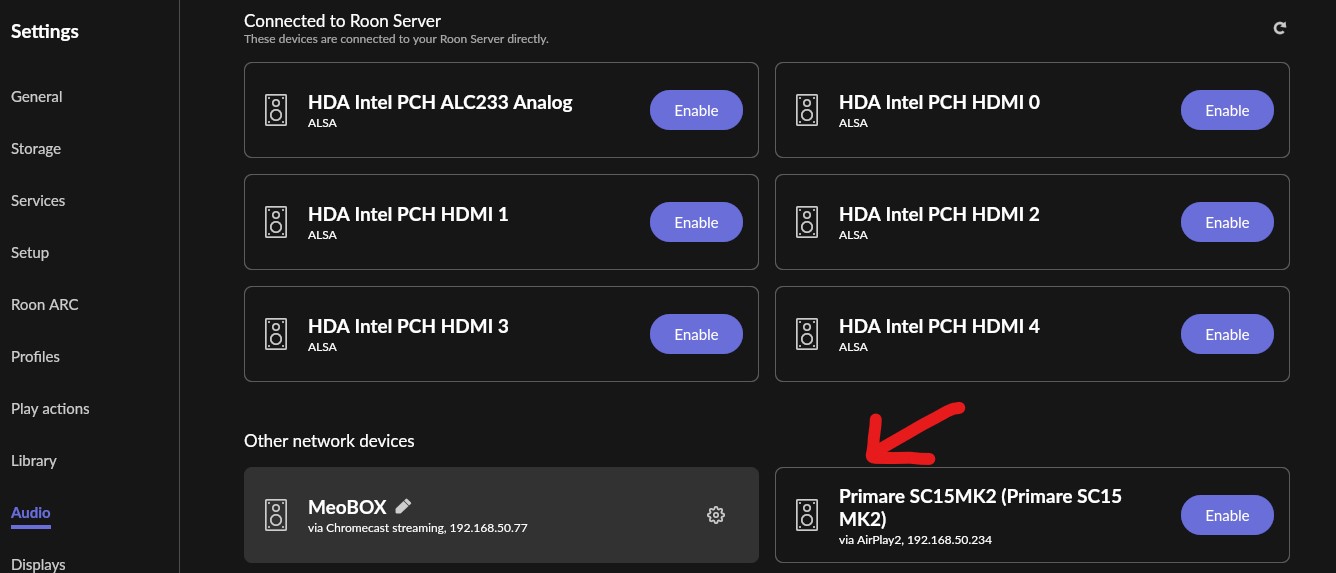

I am experiencing an issue with my Primare SC15 PRISMA MK2 and Roon. Despite being a Roon Ready device, the only available connection option in the Roon app is via AirPlay 2. No other options appear, and even AirPlay 2 does not function properly—it is unable to play music at all. This is especially odd since there are no Apple products involved in my setup.
However, something unexpected happened recently. Without me making any further changes, the SC15 suddenly appeared as a Roon Ready device and worked flawlessly for three days. Then, without warning, it disappeared again and reverted to the initial problem, only showing under "Other Network Devices" and failing to play any music.

One last question—just a small detail that annoys me: under “Other Network Devices,” I can still see the SC15 with the AirPlay connection. Is there any way to remove it from there?
And, as a cherry on top—since I already opened this issue on the forum—can I hide all the devices connected to the Roon Server (like “HDA Intel PCH HDMI 0” and so on) that I don’t want to enable by mistake?

Hey @Daniel_Lopez,
That’s excellent news! I’m glad you’re able to get things sorted out properly.
Unfortunately, there’s no way to do this quite yet - as it’s part of Roons auto discovery for devices on the network. Disabling them would be your best bet for now!
Absolutely - we’ll leave it open for now so you can continue to test :+1:
