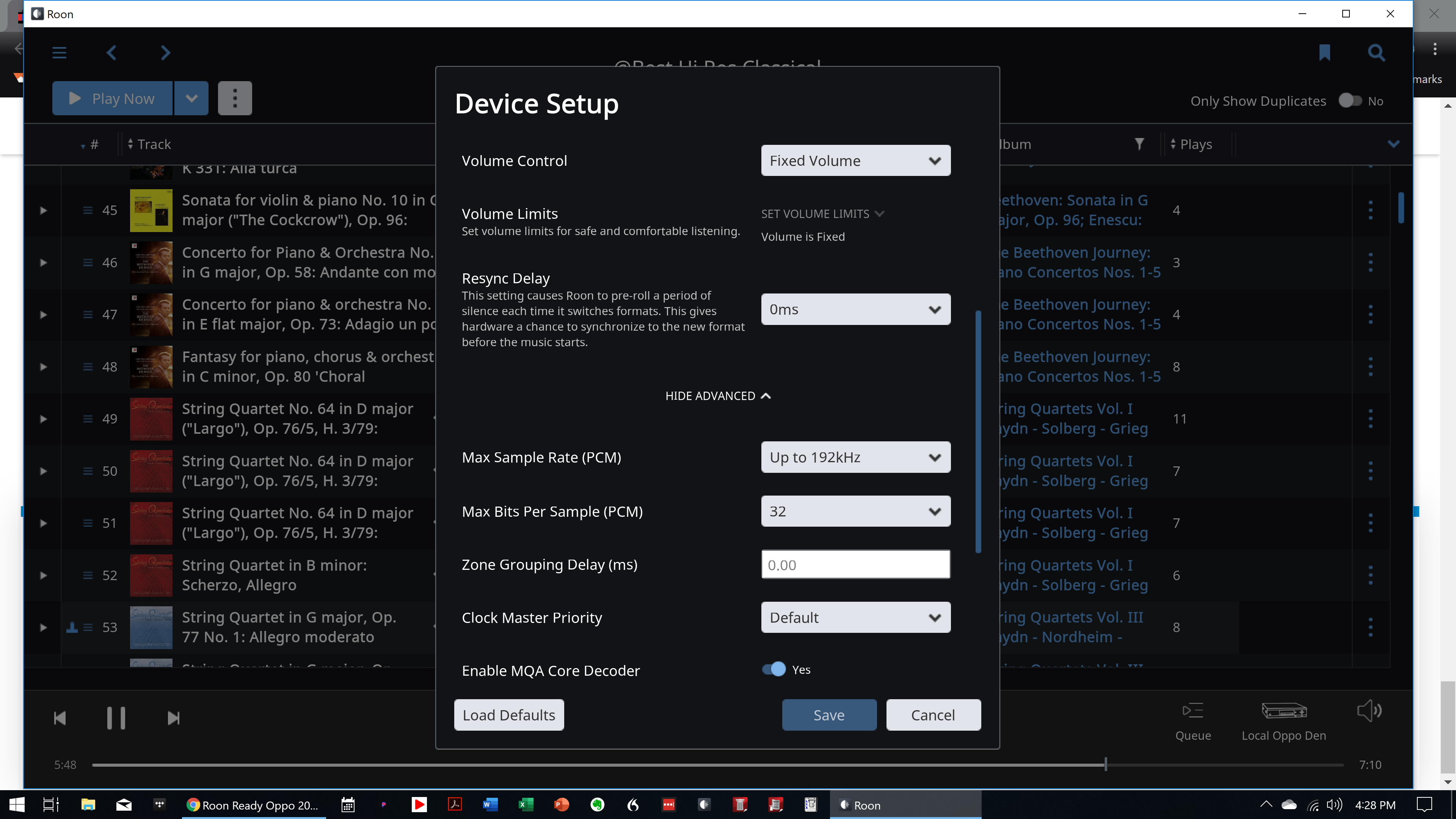

Can you please share a screenshot of your Signal Path when music is playing & also a screenshot of your Device Setup tab for the Oppo Networked zone? You can access Device Setup in Roon Settings -> Audio -> Cogwheel Icon next to Network Oppo zone -> Device Setup.
Here they are for the roon ready network driver zone set up by roon. I also emailed a reply to your email with them.
Also the local 205 zone works today, and mostly did not work yesterday. Here are the screenshots for that

Hello @Robert_Vantress,
Thank you for sharing those screenshots. I have confirmed with the hardware team that the Oppo 205 Roon Ready zone does not have MQA support, you will need to use either the ASIO or WASAPI to output MQA to the DAC.
