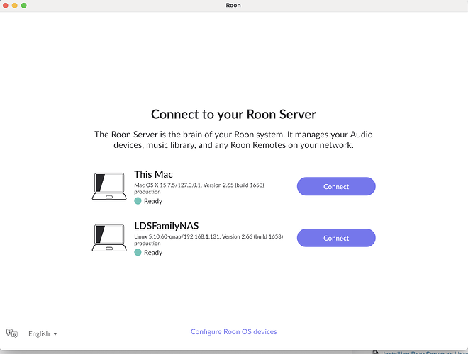

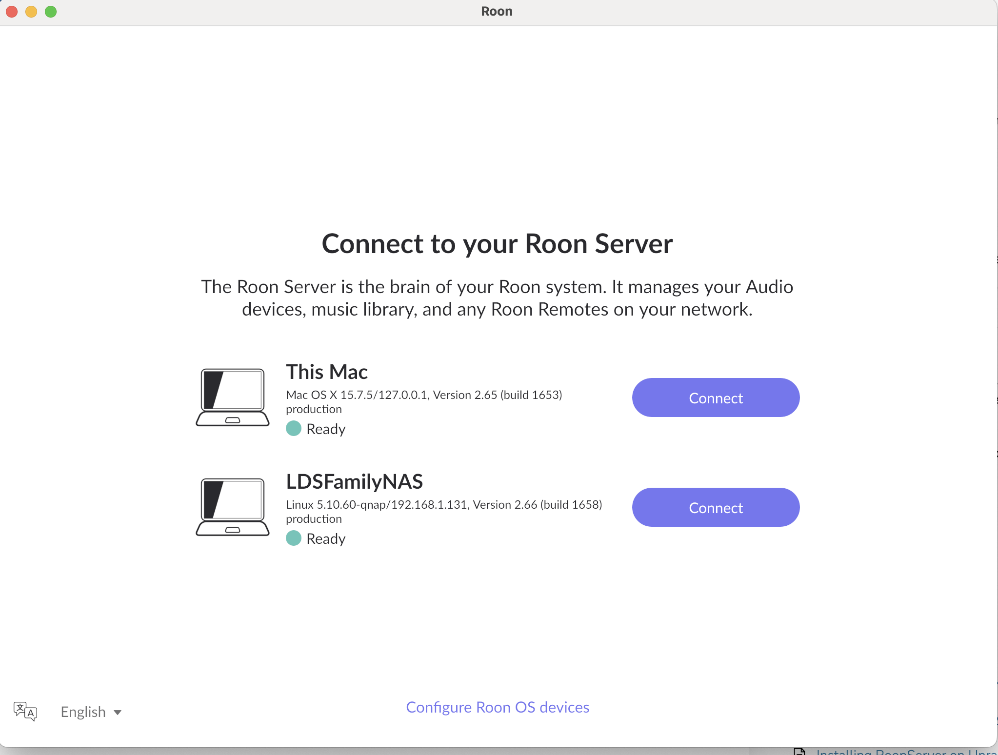

Thanks for your reply. I have tried the steps you mentioned below but it also cannot connect to QNAP server, Please see the capture screen shots for your information.
I follow your instructions unto step 5 and find the status of the roonserver is running.

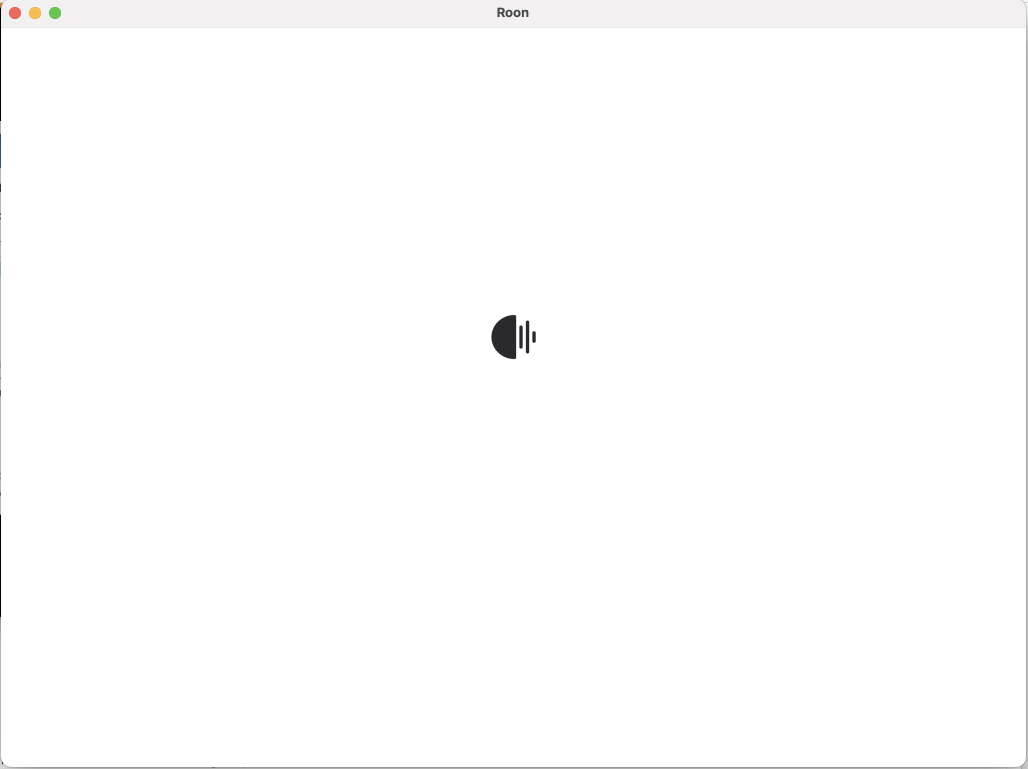

I clicked the Roon remote app in my iMac and turn on the above screen and then I select “LDSFamilyNAS and connect
However, this icon was running after click the connect button afterward and no more reaction.
Please suggest any solutions for this problem.

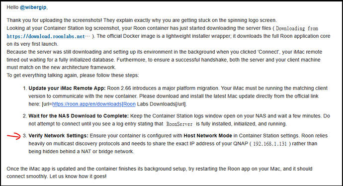

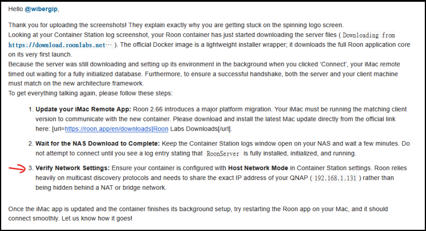

Hello @wibergip,
Thank you for uploading the screenshots! They explain exactly why you are getting stuck on the spinning logo screen.
Looking at your Container Station log screenshot, your Roon container has just started downloading the server files (Downloading from https://download.roonlabs.net). The official Docker image is a lightweight installer wrapper; it downloads the full Roon application core on its very first launch.
Because the server was still downloading and setting up its environment in the background when you clicked ‘Connect’, your iMac remote timed out waiting for a fully initialized database. Furthermore, to ensure a successful handshake, both the server and your client machine must match on the new architecture framework.
To get everything talking again, please follow these steps:
  1. Update your iMac Remote App: Roon 2.66 introduces a major platform migration. Your iMac must be running the matching client version to communicate with the new container. Please download and install the latest Mac update directly from the official link here: [url=https://roon.app/en/downloads]Roon Labs Downloads[/url].
  2. Wait for the NAS Download to Complete: Keep the Container Station logs window open on your NAS and wait a few minutes. Do not attempt to connect until you see a log entry stating that RoonServer is fully installed, initialized, and running.
  3. Verify Network Settings: Ensure your container is configured with Host Network Mode in Container Station settings. Roon relies heavily on multicast discovery protocols and needs to share the exact IP address of your QNAP (192.168.1.131) rather than being hidden behind a NAT or bridge network.
Once the iMac app is updated and the container finishes its background setup, try restarting the Roon app on your Mac, and it should connect smoothly. Let us know how it goes!

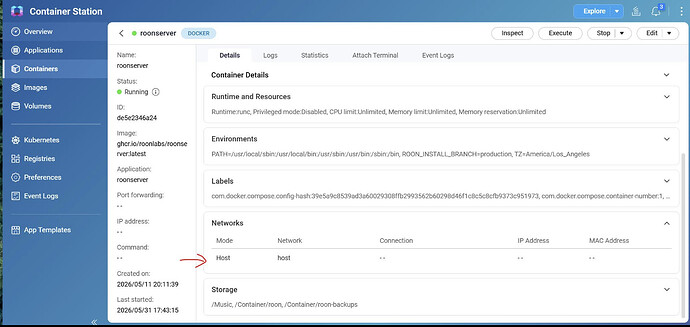

Hi @wibergip ,
Thank you for your request to re-open this thread and we apologize that it closed before we could reach a firm resolution.
Can you please share a screenshot of the current Roon Server instance in Container Station? We’ll be able to guide you through next steps for configuring the proper network mode, etc.
I’m not quite sure how to set Host Network Mode. In Container Station, it already shows as Host.
There also isn’t another option in the settings called configured with Host Network Mode.
Step 2 in the email was already completed earlier.
I installed Roon in the NAS Container Station using the following configuration code:
services:
roonserver:
image: Package roonserver · GitHub
container_name: roonserver
network_mode: host
environment:
  • ROON_INSTALL_BRANCH=production
  • TZ=America/Los_Angeles
    volumes:
  • /share/Container/roon:/Roon
  • /share/Music:/Music
  • /share/Container/roon-backups:/RoonBackups
    restart: unless-stopped
    logging:
    driver: local
Hello @wibergip
Thank you for the update.
We see that Docker is up and running. Would you kindly try connecting from a different remote, like a phone or a different PC, and disable the WiFi connection on your MAC and try again

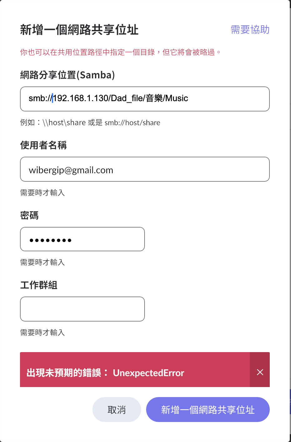

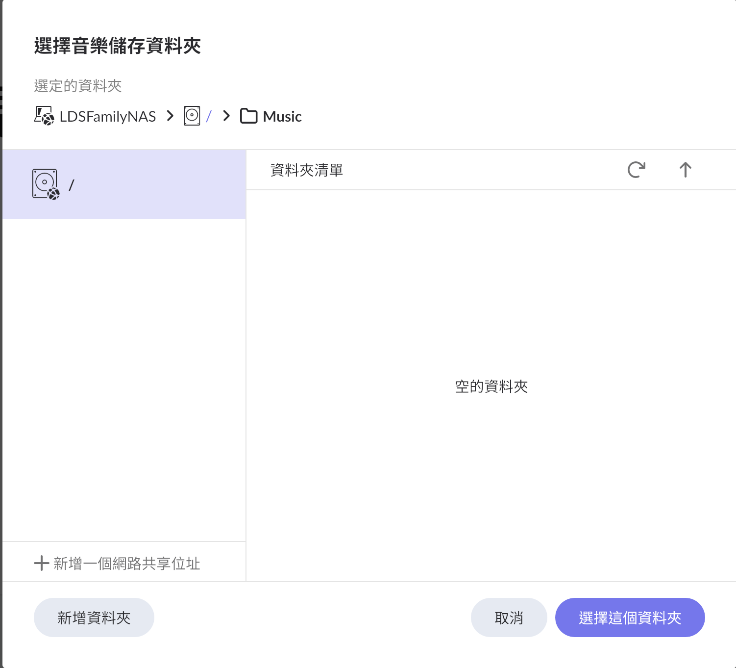

Thank you for your advice. I can connect to the roon again. However, it cannot locate my music folder. I try to reconnect to my music folder in my NAS but in vain as shown in screen shots as below .
Please advise.
