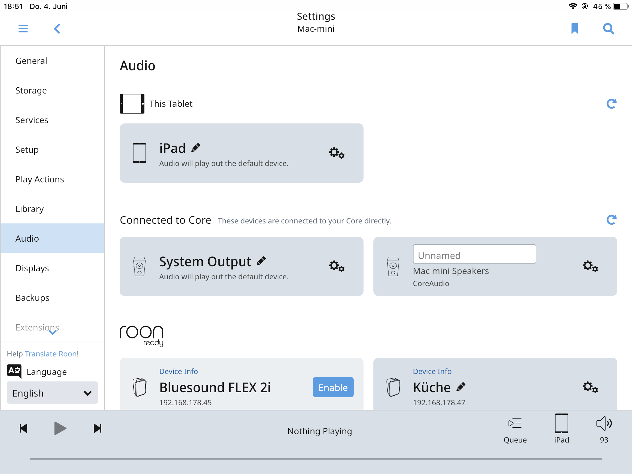

  3. Can you give me a screenshot of “Settings>Audio”?
  4. Has this always been an issue or did this start recently?
Configure roon os is only for core like Nuc rock and nucleus.
Details of my network infrastructure are covered in my OP, I might add that I do not use switches and my router is from AVM (Fritz!Box). When no remote access to the core was possible, the audio setting tab was empty. At the moment the system is ok, so I can enclose two screenshots of my audio setting. I cannot pinpoint when the problem started but I had two updates (one for BluOs, the other for Roon) in short succession and I think the problem started thereafter.

I found the “Software Packet Acceleration” (its hidden deep in the menu and is a hardware acceleration as well). Disabling it had two effects: connection to my iPhone was lost (see screenshot) and speed throttled dramatically. “Enabling” the phone was not completed until I started the hardware acceleration again, as well as the core and my iPhone. Doesn’t look like a real solution.
