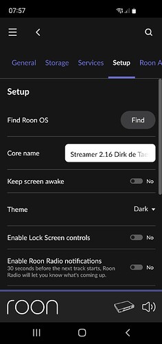

Have you enabled ´keep screen awake’ in Setup?
(in my screenshot it is not!)
This will be most likely Androids heavy handed battery optimisation or power management . Roon is a battery and resource hog so it tends to kill it on devices with not much ram or free resources I have found happend all the time on my Pixel 4. You can try turning off battery optimisation for the app in the battery settings it can help.
Thank you I will try this, I did not have that toggle as ON. Hope it makes a difference!
I have applied the minimum allowed battery conservation, we will see what happens. As it is, I am using my tablet with the power USB C plug plugged in 24-7… so the tablet should not be entering any battery conservation mode as it is running full time on AC power! Thank you!
