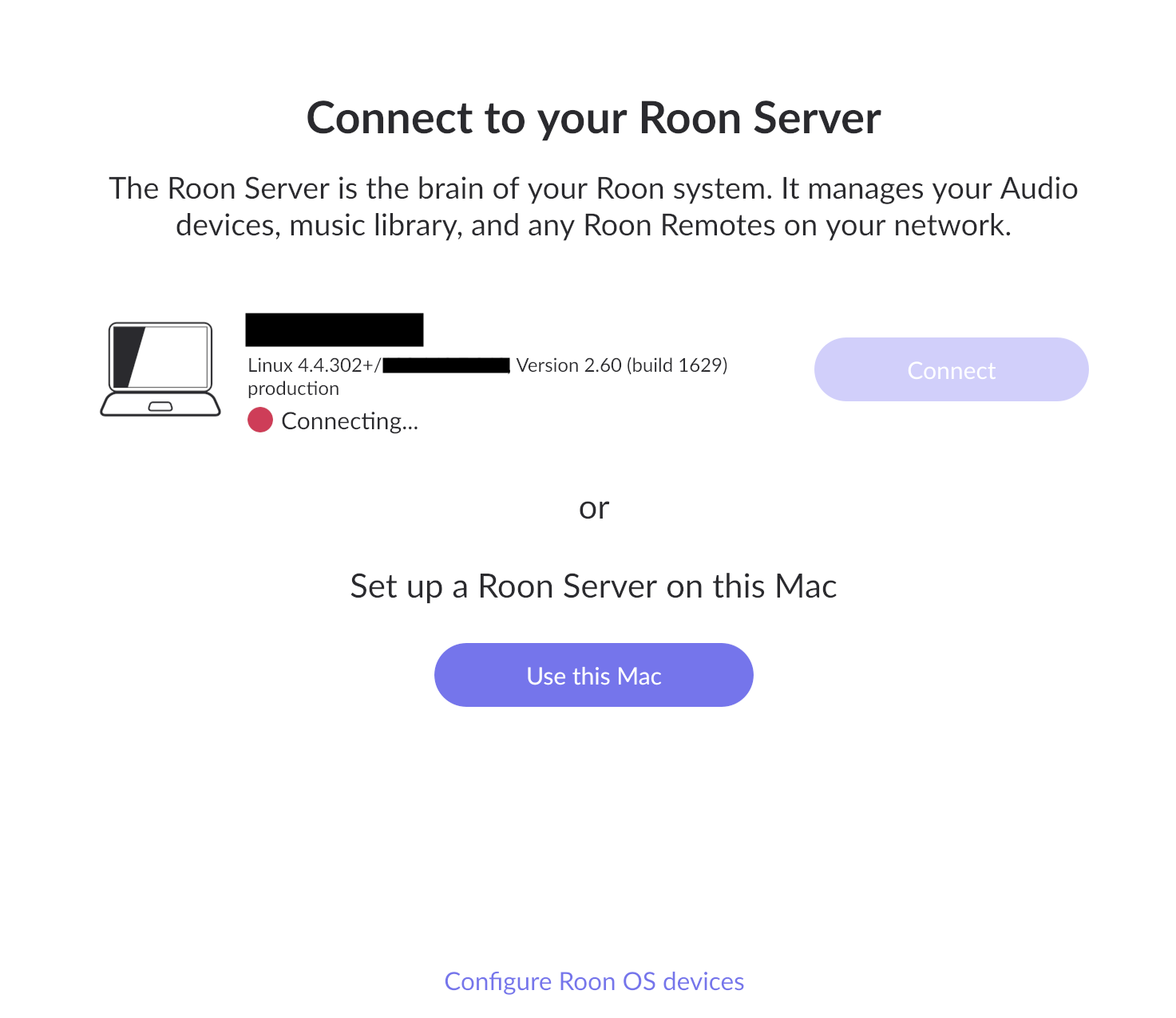

· Can no longer open my home (library) using Roon Remote on MacStudio (Tahoe26.3) since updating Roon Server to v2.6 build on NAS (Synology DSM1522+); Upon launching the Remote, it goes into the panel--shown in the uploaded image--stays on indefinitely.

I tried the steps as you suggested, but the same problem. (I am not running the server on macOS at the moment, so the steps applied only to the Roon Remote that used to work fine fetching data from the Roon serving running on my Synology NAS.) After rebooting, the Remote gets stuck in the same state as shown in the screenshot originally submitted with the ticket. I left it for a couple hours, and nothing changed.

It seems the issue is solved as follows:
I tried fiddling with the network configuration on my MacStudio now that I have verified that another Mac running the same latest MacOS (Tahoe 26.3) allows the latest Roon Remote (2.60 build 1629) to work fine with the latest Server (2.60 build 1629) running on my Synology NAS. The most obvious difference between the two Macs became some details in their respective network configuration.
The culprit was that on MacStudio, I was using the “DHCP with Manual IP Address”. The other Mac - MBP14 ran the Remote successfully and it was using “DHCP”, all other setting options being equal.
So, now I have everything running OK on all Macs, using “DHCP”, using public DNS by google and openDNS, Private Wi-Fi address = Fixed, Wi-Fi 6E mode = Automatic, Limit IP address Tracking = ON, Firewall = Active, not using VPN)!
For a reason that I don’t quite remember, but likely for setting up the Roon Arc, I had set the Manual IP Address mode for MacStudio.(The manually set ip address was then reserved via eero settings.) I eventually gave up on the Roon Arc, but kept the manual ip setting. With earlier Mac OS versions, this apparently wasn’t a problem. But with Tahoe 26.3, it seems to have become an issue.
But it would be great if you can explain to me why choosing the Manual IP address mode for my Mac wifi has become an issue under the latest MacOS. To be more specific, why the Roon servers log file never reached the “Authenticating…” step in its Connecting to Server stage (step 5 in the comparison of the log files from two Macs) when the MacStudio was in that manual ip address mode?
