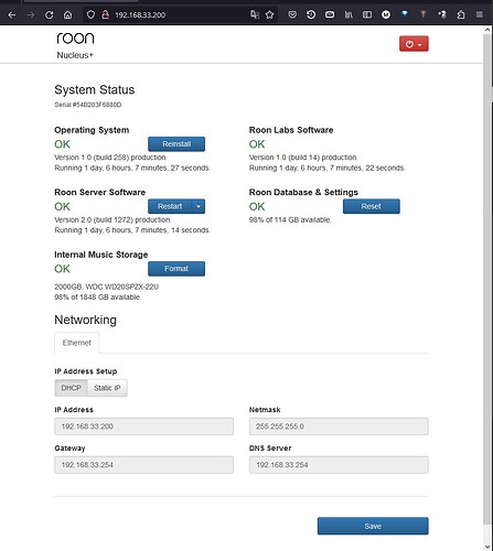

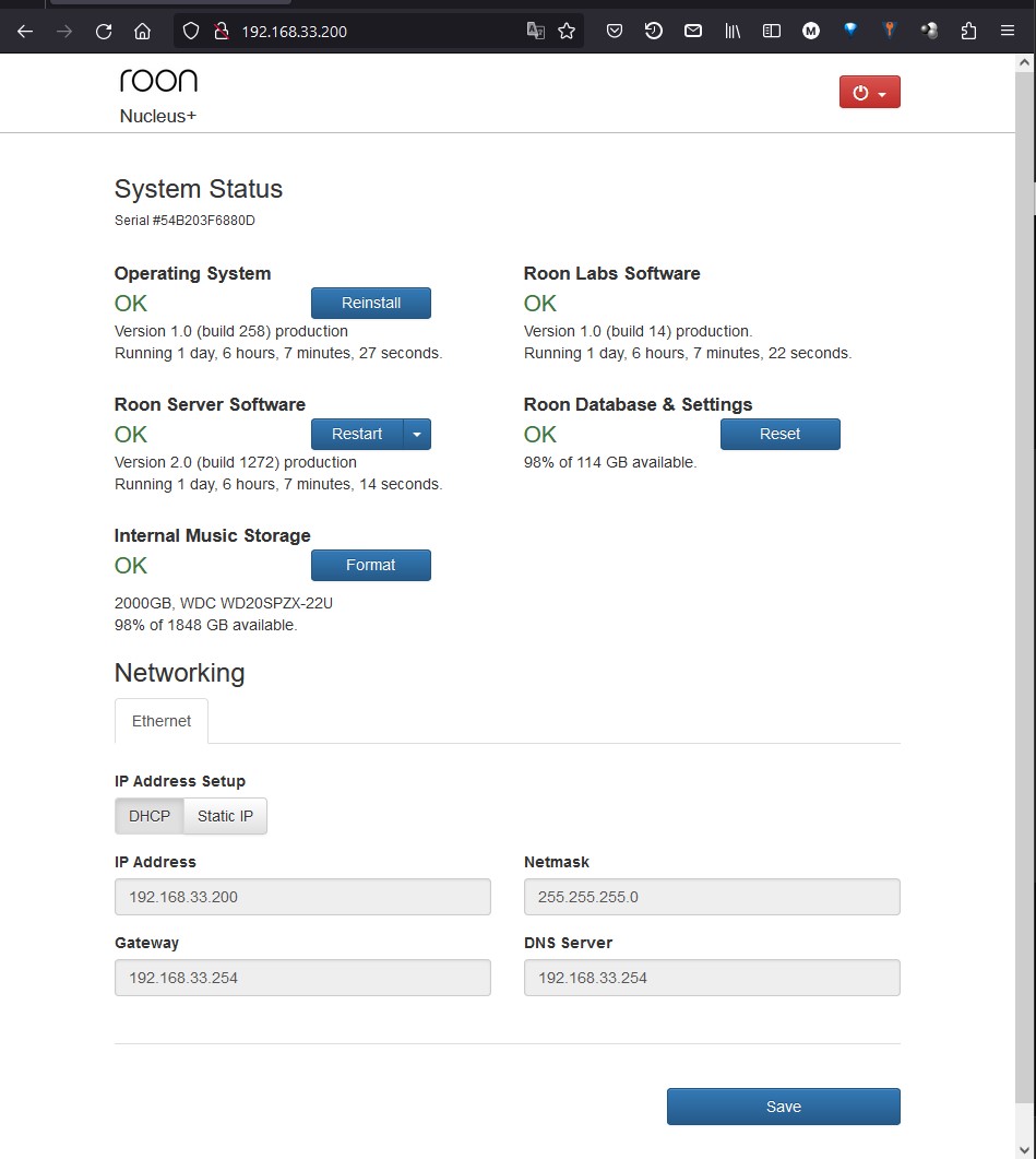

From work I can access the Nuclueus Website, from where I can reboot or shutdown

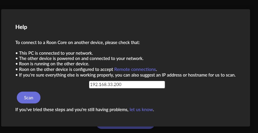

So Yesterday, I set installed Roon Remote on my PC in the office (other place) too. We have a VPN running. It worked at once, I only had to give Roon Remote the IP 192.168.33.200.

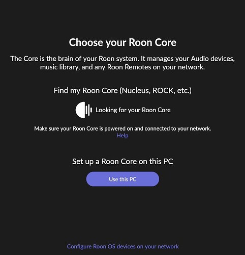

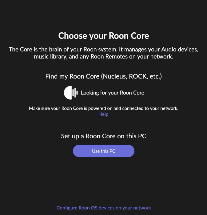

Then, the first task was to go into settings to update my preferences. The change to the dark mode required a reboot of Roon Remote, and from there, it did not find the Core again. That was 10 minutes after first log-in.
I still can ping the Core, I can Reboot and or Shutdown it via website, but it does not want to connect.
All following screenshot are taken from the PC in my office.

I didn’t realize you could do this. Can’t you just do that again?

it’s when you press Help (in screenshot 3, then you get a window like screenshot 4 hwrw you can specify an IP-address…) However after the first restart of Roon Remote, even that did not help … it just stayed searching, but i can still access the core via windows explorer…
