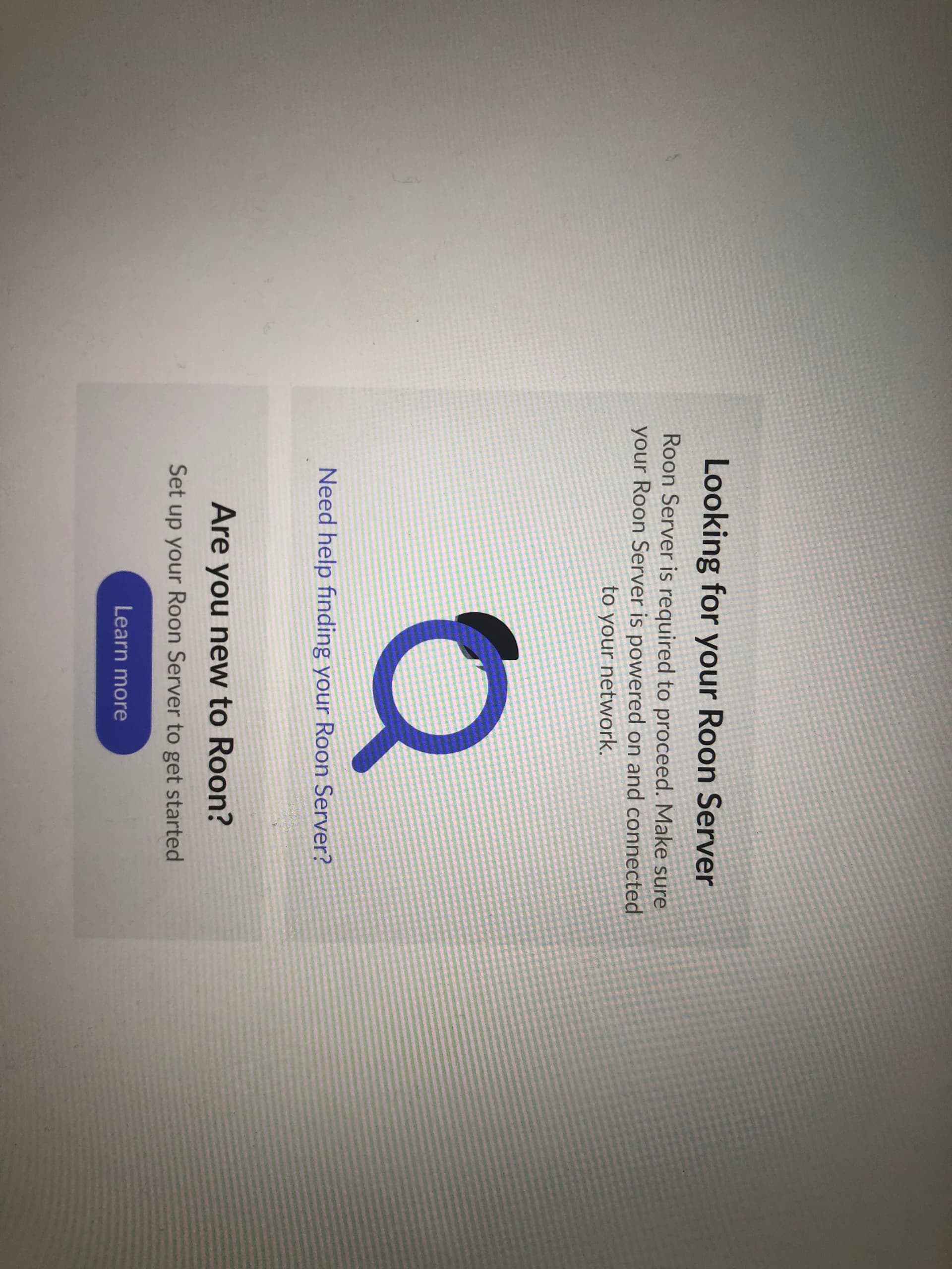

Description of Issue (Describe the issue you’re experiencing in detail):
The Roon Remote app on my iPad can’t find the Roon Core on my Mac mini. It stays stuck on “Looking for your Roon Core”.
What I’ve tried:
• Reinstalled Roon Remote app on iPad
• Restarted both Mac mini and router
• Manually entered Mac mini’s IP address on iPad
• Allowed Roon and RoonAppliance in macOS Firewall (even removed and re-added rules)
• Verified both devices are on same subnet
• Switched Mac from Ethernet to Wi-Fi (no change)
• Checked Fritz!Box settings — could not find IGMP Proxy or WLAN Isolation options
• Disabled private Wi-Fi address on iPad
• No VPN or special filtering running
Everything worked before I deleted and reinstalled the Roon app on iPad. Since then, discovery has stopped.
What else can I try? Thanks in advance for your help!
[Moderator edit: Removed triplicated info.]

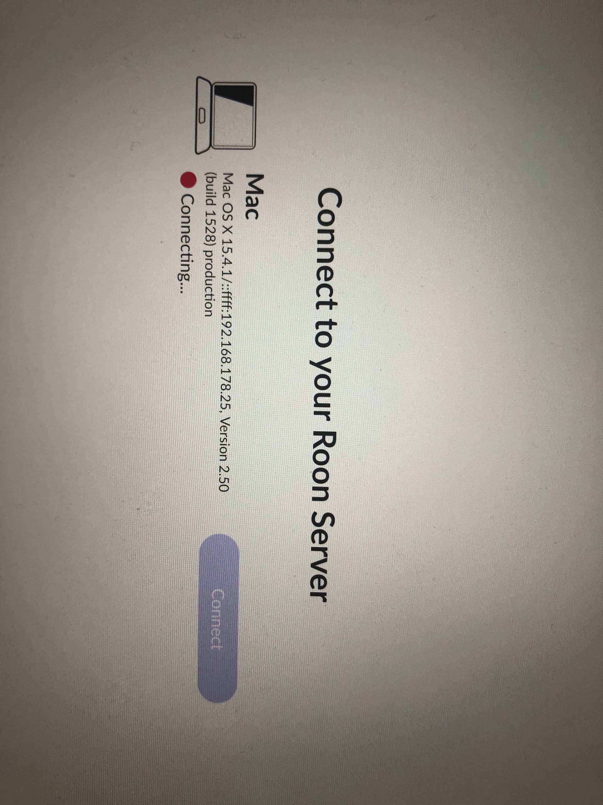

Now the iPad switch between the two messages.
