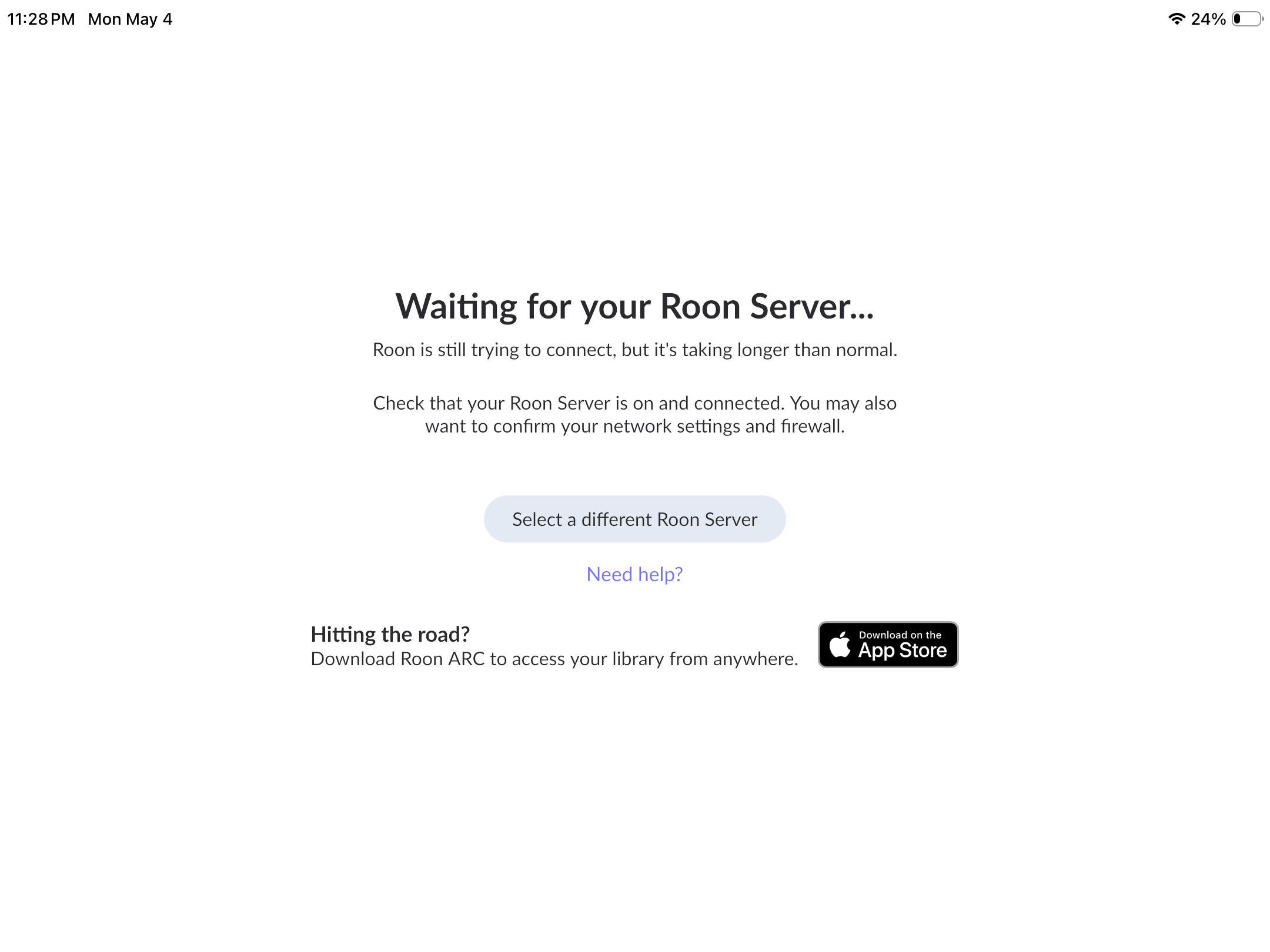

· Roon Remote constantly "waiting for your Roon Server"
· Spectrum 1G service- Spectrum modem- TP Link ax1800 router 5G wifi to Ipad or Iphone for Roon controllers. TP link access point used as an extender for wifi on 2nd floor. Roon Server on Imac (2023) connected via ethernet with 800mb download speed

Connor, thanks for the suggestions. My Ipad and my router already have the settings you suggested though. In terms of other remotes and Imac- Roon Core, I rarely use them to play Roon. But I have noticed a couple of times that when I cannot reopen Roon app on Ipad , that when I went to the Imac to reboot the Imac Roon app, that the app is working on the Imac but not the Ipad controller. If I had to guess I would say that these problems occur mostly on the Ipad, working well one minute , then no longer accessible, then maybe later back on. It’s as if the wifi was not working but when I check other apps on Ipad (eg Youtube) they are still working.

Problem happened several times again with remote /ipad. The remote / iPad was connected to router via 5g and the Roon core IMac connected to router via Ethernet. At the time of disconnection I un plugged the repeater. This did not solve the issue with iPad Roon Remote . Also noted that the iPhone Roon remote was functional when iPad remote was not.

We’ve reviewed your logs - the Roon Server is working fine, no errors on that side. The problem is your network.
  • Your iPad lost its connection repeatedly - some sessions lasted under a minute, one lasted 13 seconds
  • Your Chromecast Audio dropped 31 times on June 14 - sometimes every 30 seconds
  • The Chromecast is not an iOS device, yet it fails at the same time as the iPad
  • Your iMac on Ethernet was stable throughout
When two different WiFi devices fail simultaneously while the wired machine is fine - the fault is in the router, not the iPad. iOS Private WiFi Address and Local Network permissions are not the cause here.
What to try
  • Disable Smart Connect / Band Steering on your TP-Link AX1800 - it silently switches devices between bands and drops connections each time
  • Disable Beamforming - it can momentarily drop stationary devices like the Chromecast when it loses tracking
  • Set static IP reservations for your iPad and Chromecast in the router DHCP settings - your iPad changed IP addresses during this period, which breaks active sessions
  • Switch your One Mesh unit from Extender to Access Point mode - right now it uses a wireless backhaul instead of the Ethernet cable you have running to it, adding an extra layer of instability
Let us know how it goes - happy to dig further if needed.

Thanks for the update! From a fresh Roon Server report, your Roon Server (the iMac, macOS 15.7.7, on Ethernet) ran continuously the whole period June 19–23 with no crashes, no restarts, and no errors on its side. Every failure in the logs is the server reaching out to a device and the device not being there. So @vadim is right: this is a network-link problem, not a Roon problem.
Two details worth knowing:
Your iPad and your “two” remotes are actually one iPad (model iPad11,6). On June 19 it was at 192.168.0.151; from June 20 onward it’s consistently at 192.168.0.200. That IP change is your static-IP reservation taking effect, and it held steady ever since, so that step worked.
When the iPad drops, the server logs a burst like “connecting (attempt 1…5) → client connection failed → Giving up” trying to reach the iPad at 192.168.0.200:9200. That “Giving up” is the exact moment your iPad shows “waiting for your Roon Server.” The iPad has silently fallen off WiFi.
Suggested next steps for you:
  1. Confirm what you changed on June 20, so you don't undo it. If you set the static IP and switched the One Mesh unit to Access Point mode and disabled Smart Connect/Beamforming all at once, that bundle is working. If you only did the static IP, the remaining drops suggest doing the rest now.
  2. Switch the One Mesh unit from Extender to Access Point mode if you haven't. You have an Ethernet cable to it, but in Extender mode it ignores the cable and uses a wireless backhaul, an extra failure point right where your iPad lives.
  3. Disable Smart Connect / Band Steering on the AX1800 if still on. When the router shuffles the iPad between 2.4/5 GHz, the iPad briefly leaves the network, which is exactly the "device not there" pattern the logs show.
  4. Give the iPad a fixed band. As a test, create a separate SSID for the 5 GHz band (or split the bands) and connect the iPad only to that. This prevents mid-session band hopping entirely.
Let me know if any of the above help :folded_hands:

I will monitor whether it has fixed the issues. I am not sure in what order or dates I did the changes. My guess is I switched to AP on Jun 20 perhaps. Since June 20 I am not sure if the ipad had the same issues, seems much less. Do your recrods still show it is dropping off network? thanks
