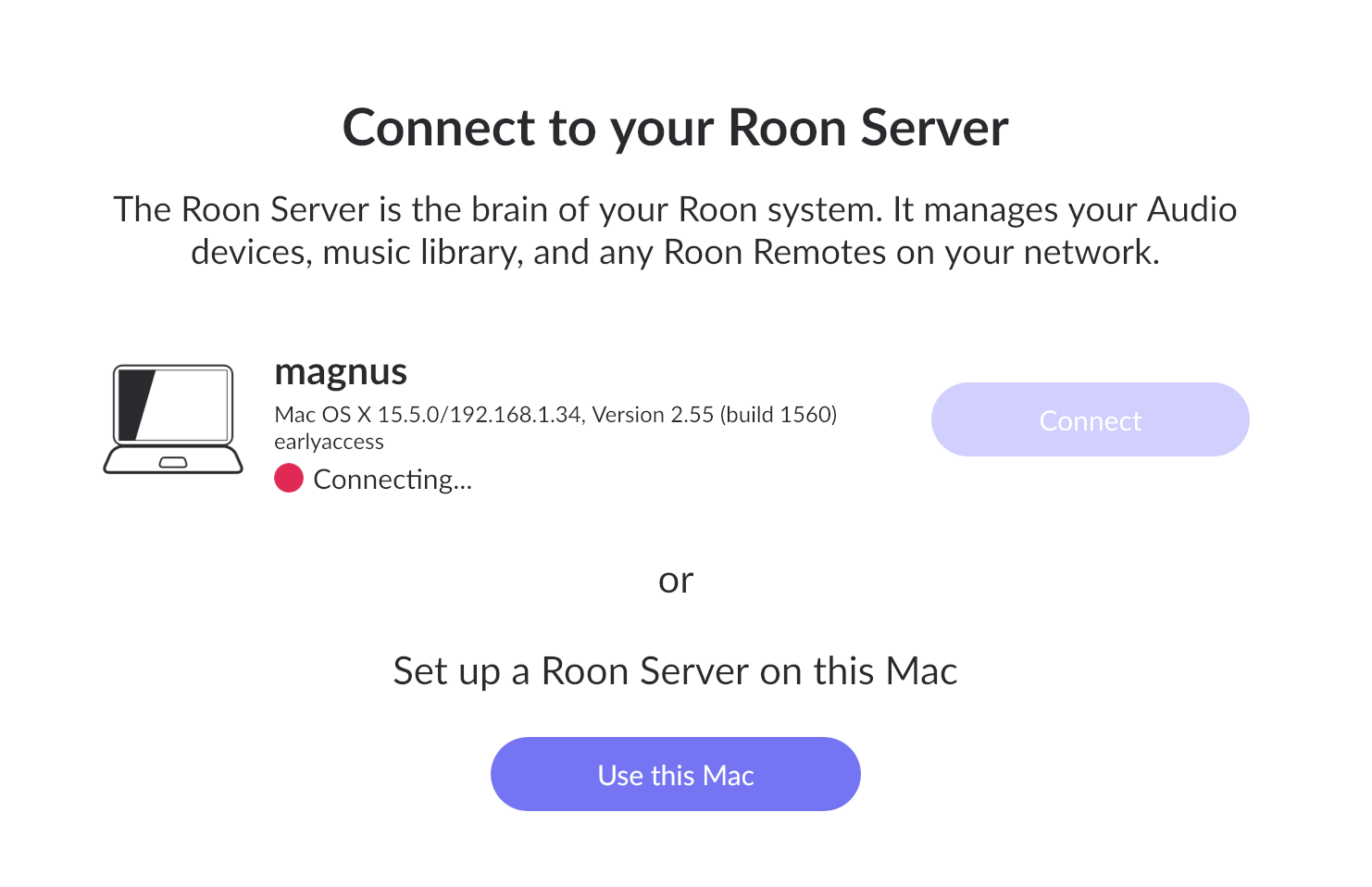

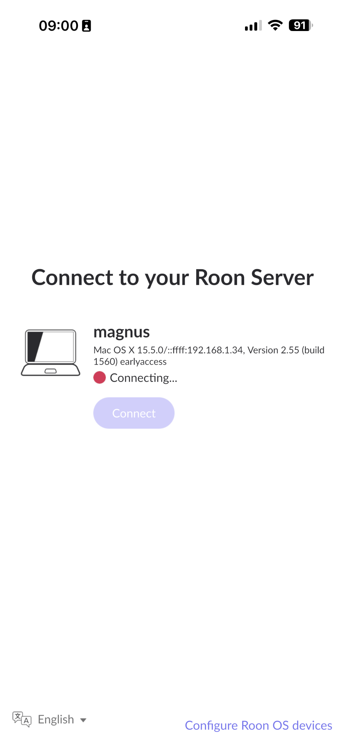

After upgrade to build 1560, no Roon Remote can connect; however, server can connect to speakers on remotes
Verizon FiOS, Verizon router, Tailscale, ControlD DNS
This happens from every remote I’ve tested, on MacOS Tahoe, Sequoia, and iOS.

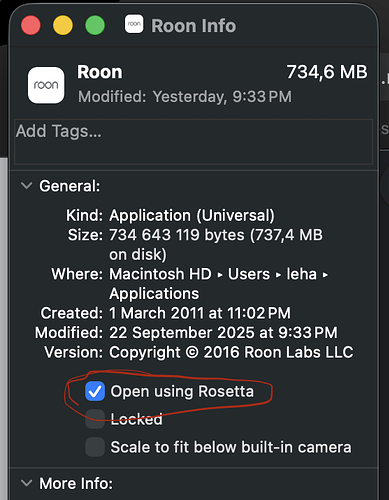

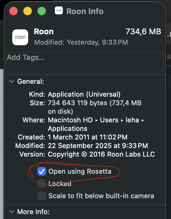

P.S. for the macos Tahoe we do recommend to run Roon via Rosetta until next release if you experience critical issues.
You can enable it in Application folders by going to “Get Info” for Roon App and ticking “open using Rosetta” checkbox.

The server is running on Sequoia. Clients are on Sequoia, Tahoe, and iOS.
@alex_h An additional observation – if I restart Roon Server, I’m able to connect for a short period of time (<15 minutes) before my remotes get kicked off and return to the red dot/“Connecting…”.
Fair to say this is not an issue with network permissions as those would be enforced continuously.
