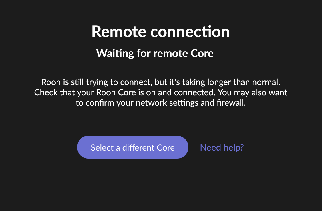

Hello, I powered down my NAS where Roon is installed while away for vacation. I returned to reboot and I can “see” my Roon Core on my NAS from a PC directly wired to the network. The Roon Remote on that PC and all other wifi Roon Remotes are unable to find the Roon Core. I’ve rebooted my NAS twice along with the Roon Control devices.
Through the system below, I can access my NAS files and Roon Core via my imac. But, again, none of my roon remotes connected to the same Google Home router says, “Waiting on Roon Core.”

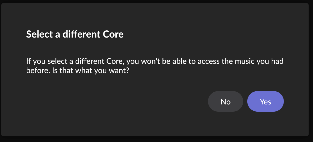

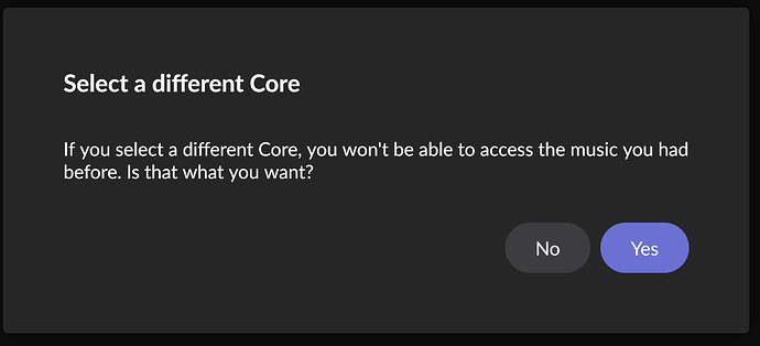

Have you tried ‘Select a different Core’. I have two cores on two different QNAP NAS, each with their own license. So depending upon where I am, I get the same display you see and I have to ‘Select a different Core’ on my remote to display the core that is available and then I can connect to it by selecting ‘Connect’ on the remote.
Thanks, but I only have the one Core which has been working on the same network and NAS for years with no issues (even after power outages and other types of system reboots).
If you Select a different Core, it will show you what the core address is and you can select Connect.
Okay, I’m a wimp. I started that path until I saw this.
Sorry that I forgot to mention that, but since you only have one Core, it will be fine. Once you click YES and then Connect, you will be all set.

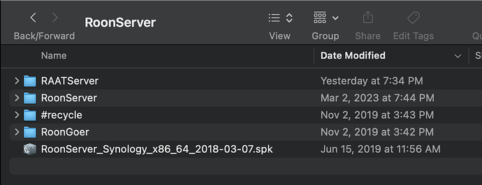

@mjw No, sorry. I can connect to my NAS and Roon Core SSD drive from my iMac via ethernet. In other words, I can see all of the files on the NAS and Roon Core and even copy to and from those drives. They’re active. But, when I launch Roon Remote on that same iMac I get the “Waiting for Roon Core” screen.

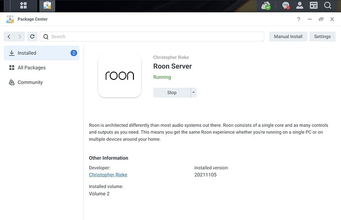

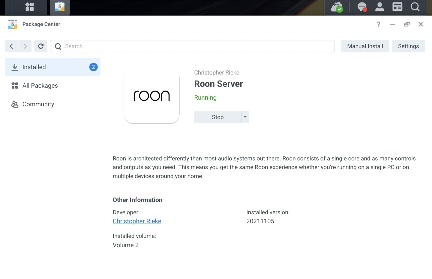

Just an obvious, possibly dumb question - is the Roon core service on your NAS running?
@Graeme_Finlayson , I had no idea what “Package Center” was let alone programs could be stopped and started.
Once Googled helped me link “Package Center” to my NAS OS, I opened it and found out Roon was, in fact, not running.
Thank you so very much! All is well with Roon and streaming. Whoot whoot!!!
