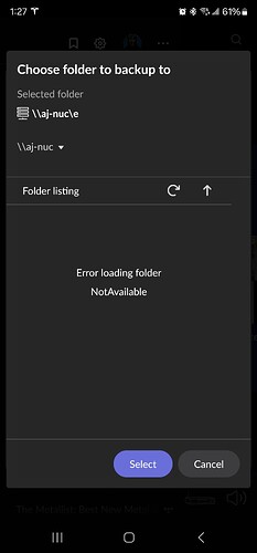

Roon stopped backing up a couple of weeks ago. It kept saying that the backup drive could not be found, even though nothing had changed, afik. Attempting to force backup results in message: Backup Failed / Backup director not available. Last successful backup was 17 Oct 2024. Fast forward a couple of days, and now my remotes cannot connect to my core at all. Last time this happened, there was a firewall setting that windows changed with an update. I'm not sure what the cause is this time.

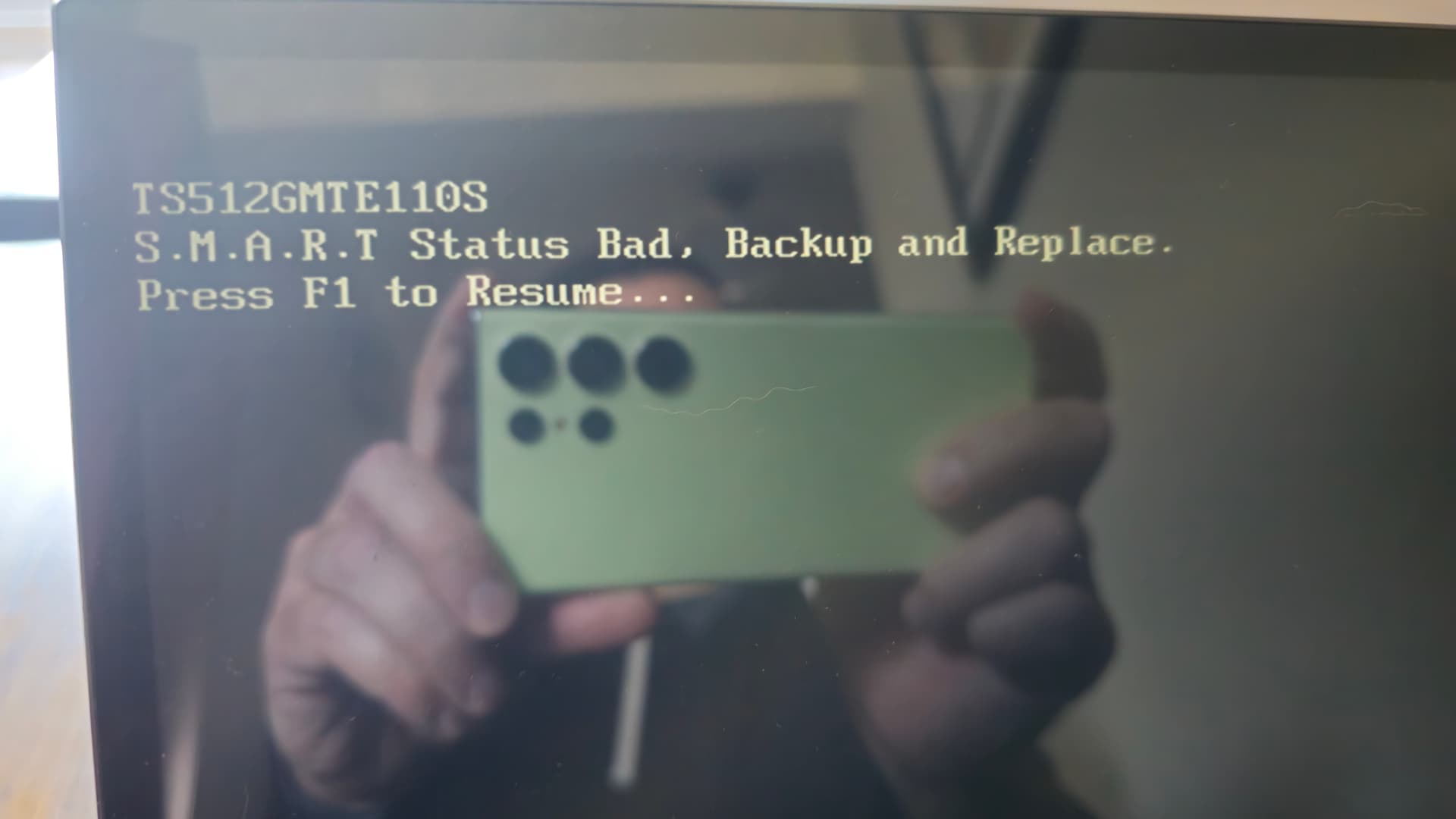

The core keeps crashing after just a few minutes of running. When I reboot, I see this message:
I added a 1TB internal hard drive to the nuc. Does anyone know how to tell which HD is going bad? I presume it’s the one with the OS, but just want to be sure.
It says TS512GMTE110S so it seems to be a Transcend 512G drive:
https://www.google.com/search?q=TS512GMTE110S
Thank you!
That’s all Greek to me, so it’s nice to have confirmation.

As far as the backups failing and not being able to network with my hub computer, I’m sure this is a Windows issue, but I hope someone her can help resolve the problem. The network was stable for a couple of years, then just the backups just stopped, and now I can’t see the ROCK from my main computer.

For the ROCK connection issue, have you looked into the SMBv1 settings on your Windows device yet?
Thank you, Noris!
I’ll look into this and report back :slight_smile:
I disabled SMBv1, but I still cannot connect to my core after rebooting my windows pc.
It looks like Password Protected Sharing was turned back on, likely due to a windows update. I turned it off again and now I’m backing up my core :slight_smile:
However, when I navigate to \rock\data (to transfer an album I recently downloaded to my core), the Storage folder shows as empty. I have a ton of music on my core. Any idea where I can find that storage folder?
The Windows 11 24H2 update disabled anonymous (guest/guest) logons on SMB shares, at least on some Windows variants, and affected users are made to dick around in the registry…
