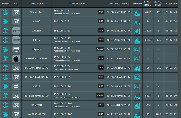

Are you able to share a screneshot of your router>devices list to confirm everything is on the same subnet?

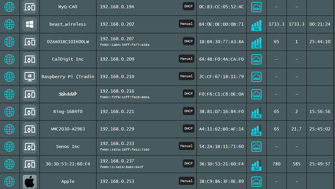

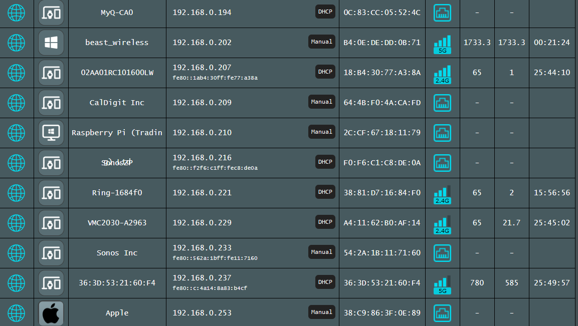

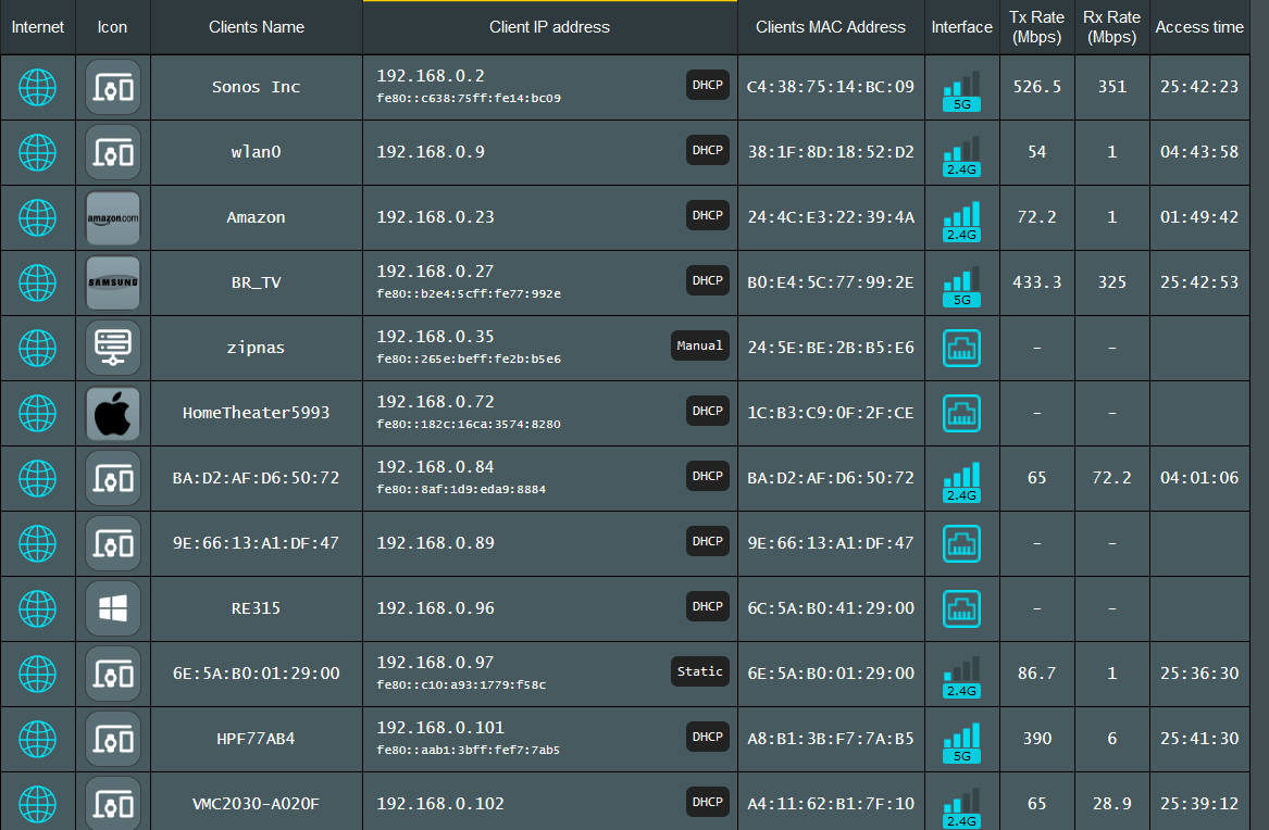

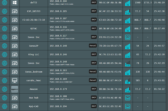

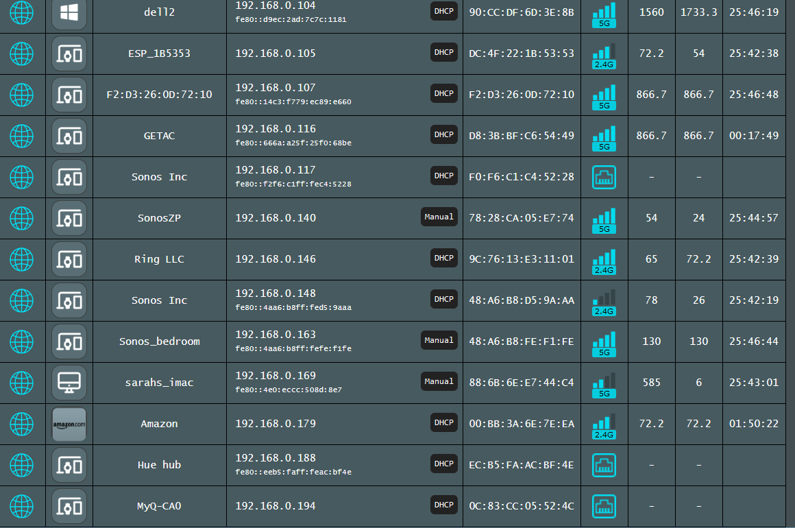

I can send a .csv file from my router to show all the connections. Here are 3 screenies of my router client list.

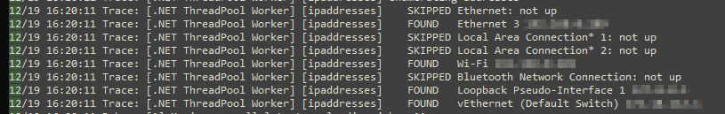

Sorry for the delay in responding to you and thank you for getting those logs to us. On examining your logs I found this in the most recent log that you sent.
If you look at the last two lines of that screenshot you can see that vEthernet and Loopback Pseudo-Interface are both found. Those are both VM related adapters. Can you please try disabling those 2 interfaces. Hopefully that will solve your issue with connecting remotes. Please let us know if it works!
