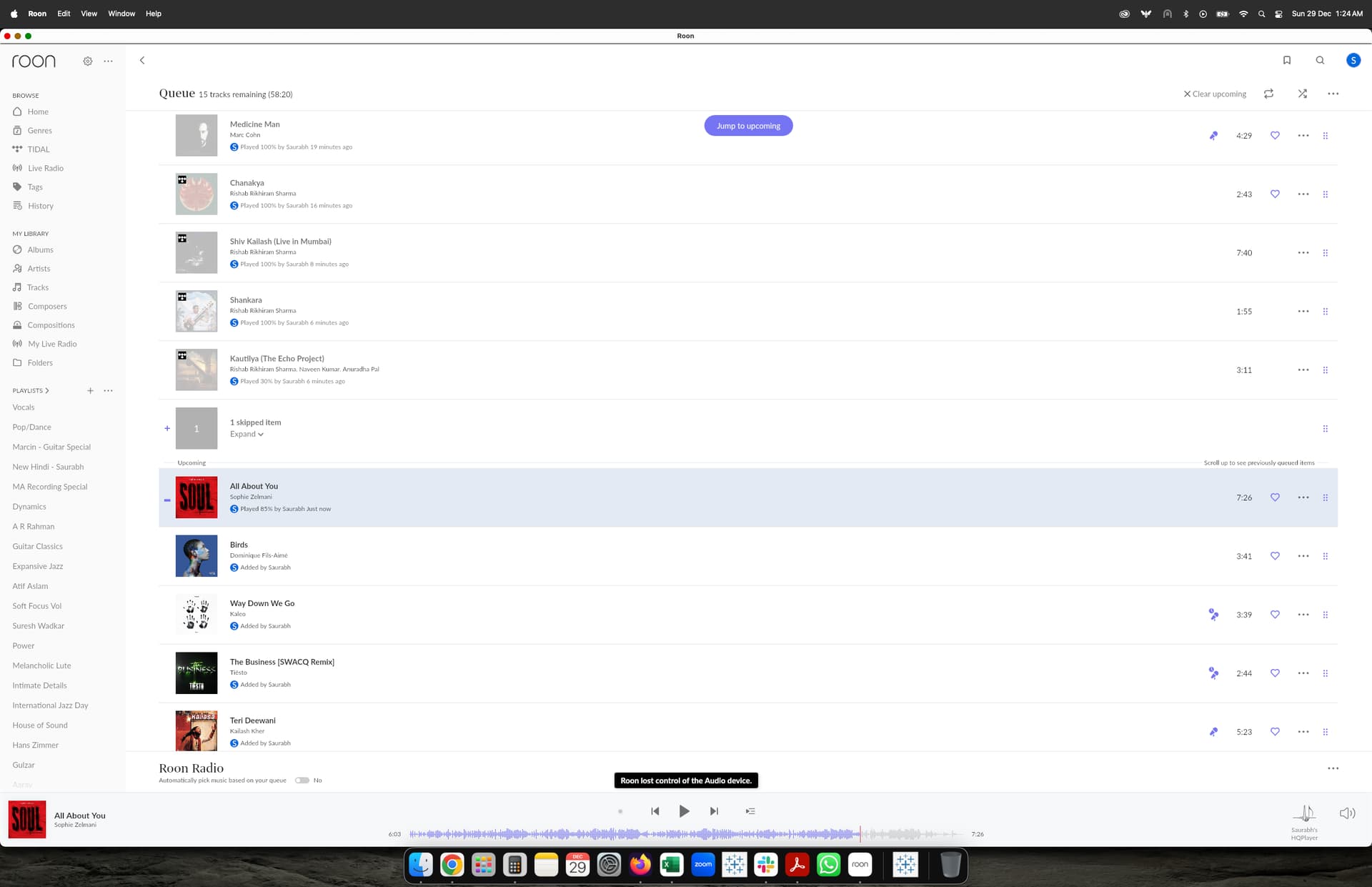

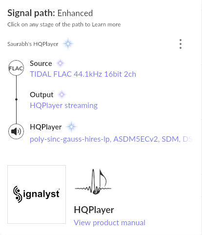

![Screenshot 2024-12-29 at 1.24.06 AM|690x445](upload://5oF33hm0gP3VeIHHN2LBcS7T63I.jpeg) ![Screenshot 2024-12-29 at 1.28.57 AM|414x481](upload://yoSBe4YpHGzo0Kb3x7HQc2sK8yW.png)

Also it looks like your screenshot didn’t post. Can you please try uploading it again?

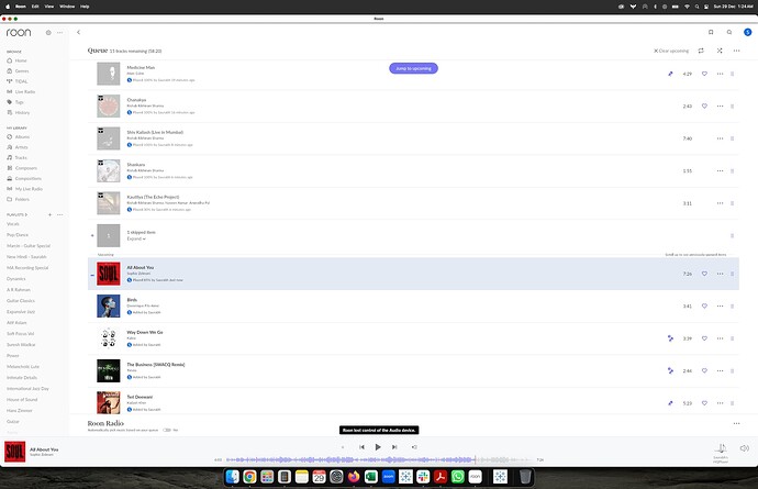

I will re-post the error screenshots once again here.

Hi @Saurabh_Ashtamkar ,
Thanks for sending that screenshot over!
This would just be the local time of occurrence (e.g. Dec 29 at 1:24AM while playing All About You, as per your screenshot). We have activated diagnostics mode so we can use this track/timestamp as a way to investigate the error further. Looking over the previous log, it looks like you tried to reinstall Roon when the issue occurred, so we will need to have a new timestamp from you to re-run diagnostics, if you can please let us know when possible that would be helpful.
