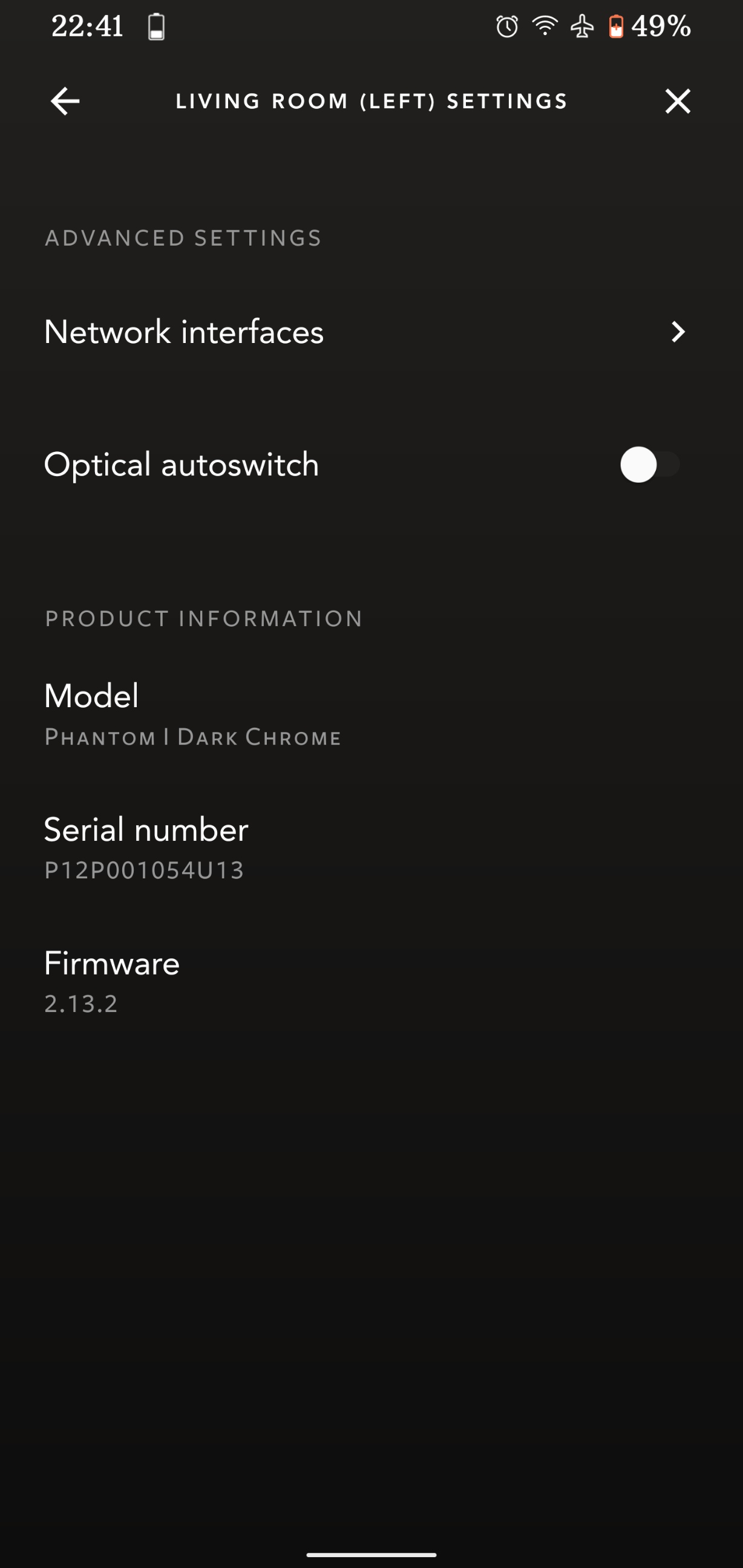

Stereo dark chrome phantom I’s running firmware 2.13.2

Here are the details for my setup;
