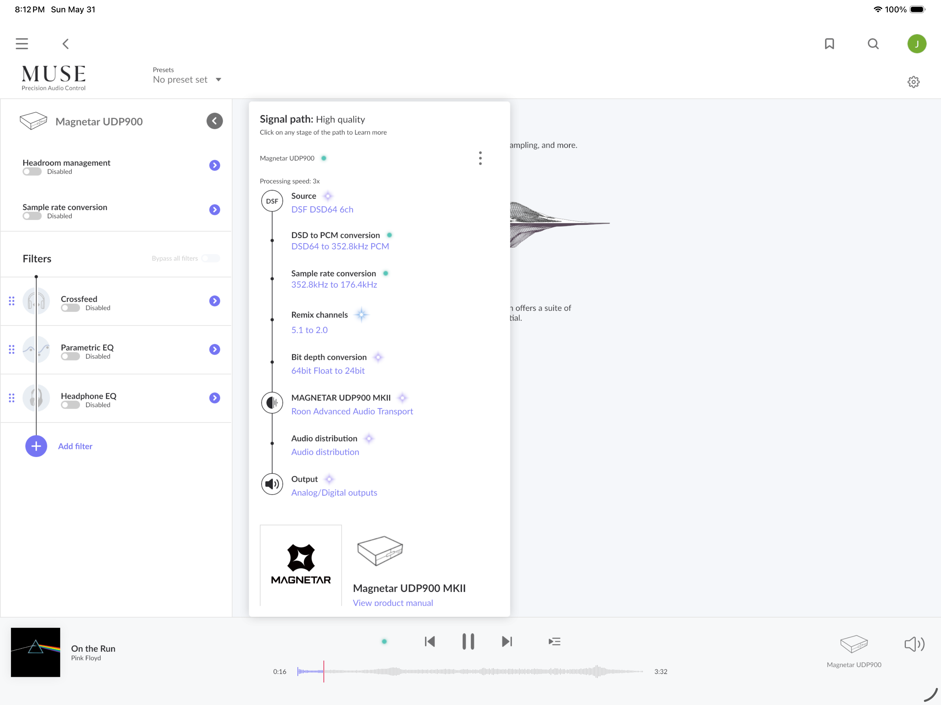

· I have a Magnetar 900MKII connected to an Anthem AVM90 via HDMI, the Magnetar is Roon Ready. I am also using a Nucleus One. When i try to play stereo or multichannel .dsf files, it resamples and downmixes them to to 2channel PCM. When i try to play multichannel FLAC files, it also downmixes them to stereo PCM. However, when i use the Magnetars built-in interfance to browse directly to the files on my Nucleus One without Roon, it sends them natively to the Anthem AVM90. I am not using any DSP and volume is set to fixed for the Magnetar. How can i get Roon to send these files natively?

Hey @John_Capra,
Thanks for writing in and for sharing your report! We were able to review a fresh Roon Server diagnostic report, and saw that the Magnetar UDP900 MKII only Advertises 2-Channel PCM formats to Roon.
Take a look:
"supported_formats":"96000/16/1|2, 44100/16/1|2, 192000/16/1|2,
48000/24/1|2, 96000/24/1|2, 88200/24/1|2, 48000/16/1|2,
44100/24/1|2, 88200/16/1|2, 192000/24/1|2, 176400/24/1|2, 176400/16/1|2"
Notice the channel counts, every single format ends in 1|2, meaning mono or stereo only. The Magnetar is not advertising any multichannel formats (like …/1|2|3|4|5|6) to Roon via RAAT, and there is no DSD listed at all.
Compare this to the Nucleus One HDMI output in the same log, which advertises 1|2|3|4|5|6|7|8 (up to 8 channels) for every format. Roon has no choice but to downmix to 2ch and convert DSD to PCM because that’s all the Magnetar is telling it to accept.
So it appears the device is not properly advertising its multichannel and DSD capabilities to Roon’s transport layer, even though the hardware is fully capable.

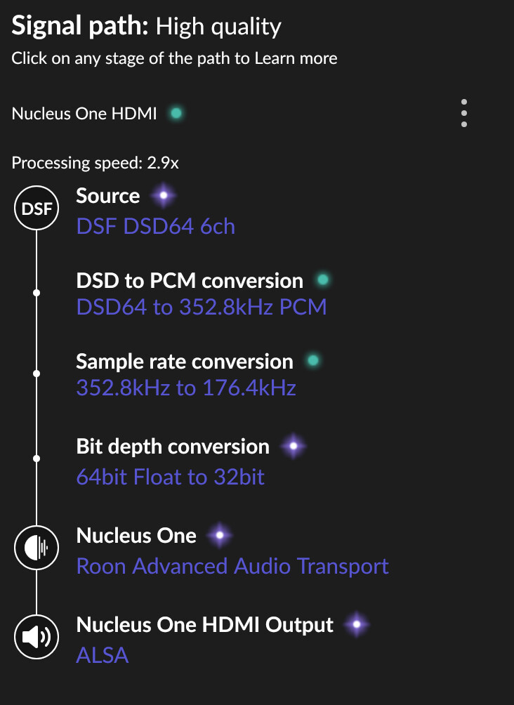

Thank you Benjamin. I connected the Nucleus HDMI directly to the Anthem and it does send 5.1 to the Anthem but converts it to PCM. (see attachment) The Nucleus has the option to select the speaker configuration where the Magnetar did not.
Does the Nucleus not output native DSD? (Can you provide the full Nucleus supported formats string for reference?)
UPDATE: I missed the DSD options for the Nucleus One but see them now. There is no option for Native DSD, only DoP. Is that a limitation of the Nucleus One or the Anthem?
Hello @John_Capra
It’s both, but primarily the transport (HDMI)
HDMI via Linux ALSA (Intel HDA PCH) is a PCM-only transport at the driver level. The kernel ALSA driver does not support sending raw DSD frames over HDMI.
The “No native DSD, only DoP” limitation is HDMI’s architectural constraint — HDMI carries PCM, not raw DSD bitstream. DoP is the standard workaround.
