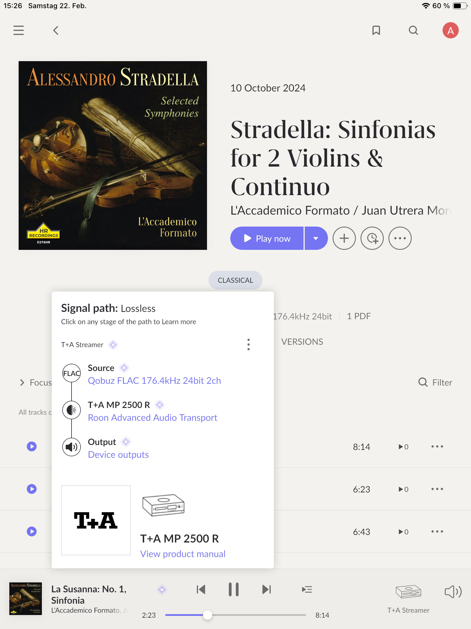

Please share an image of the signal path. Thanks.

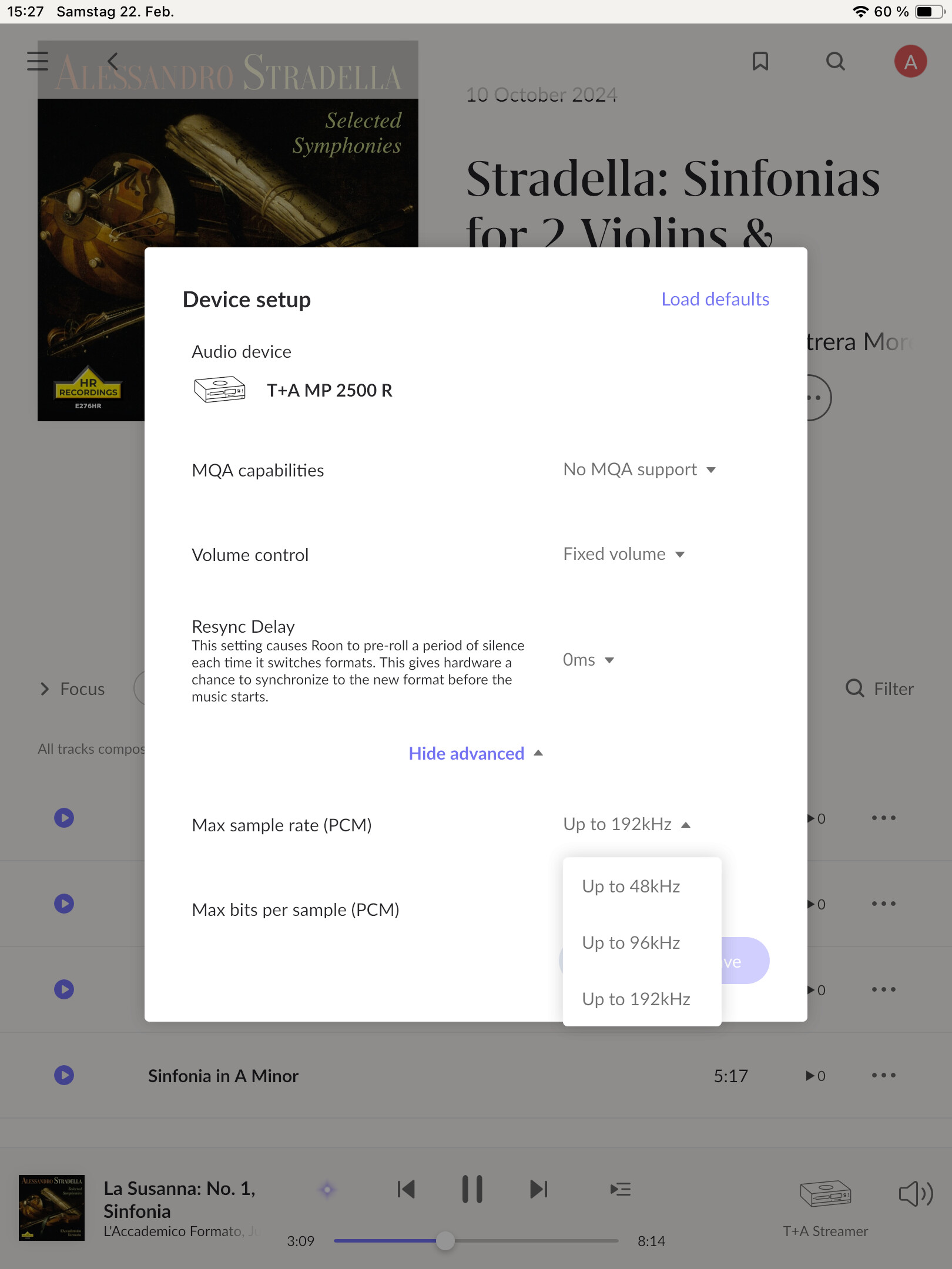

In Roon - Settings - Services, Qobuz is indeed limited to 192 kHz (or higher frequencies are not selectable)
So I’am afraid you will need to launch a feature request fot this.

Many thanks, will do. Pls find below the rspective screen

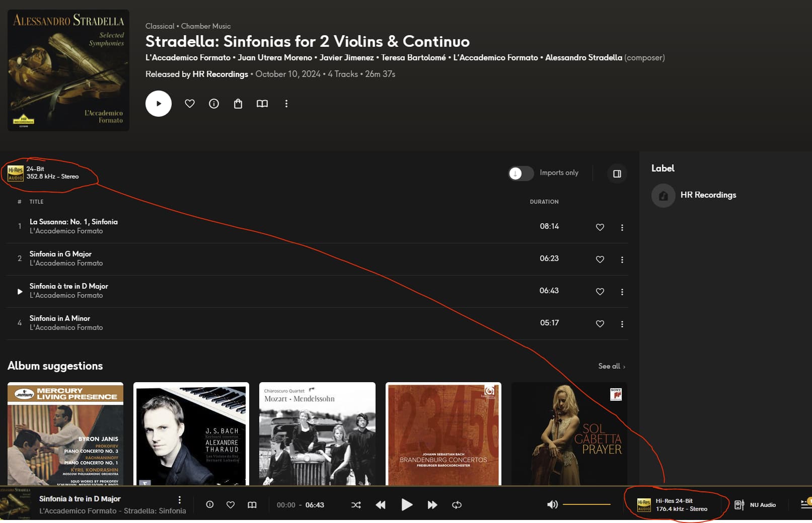

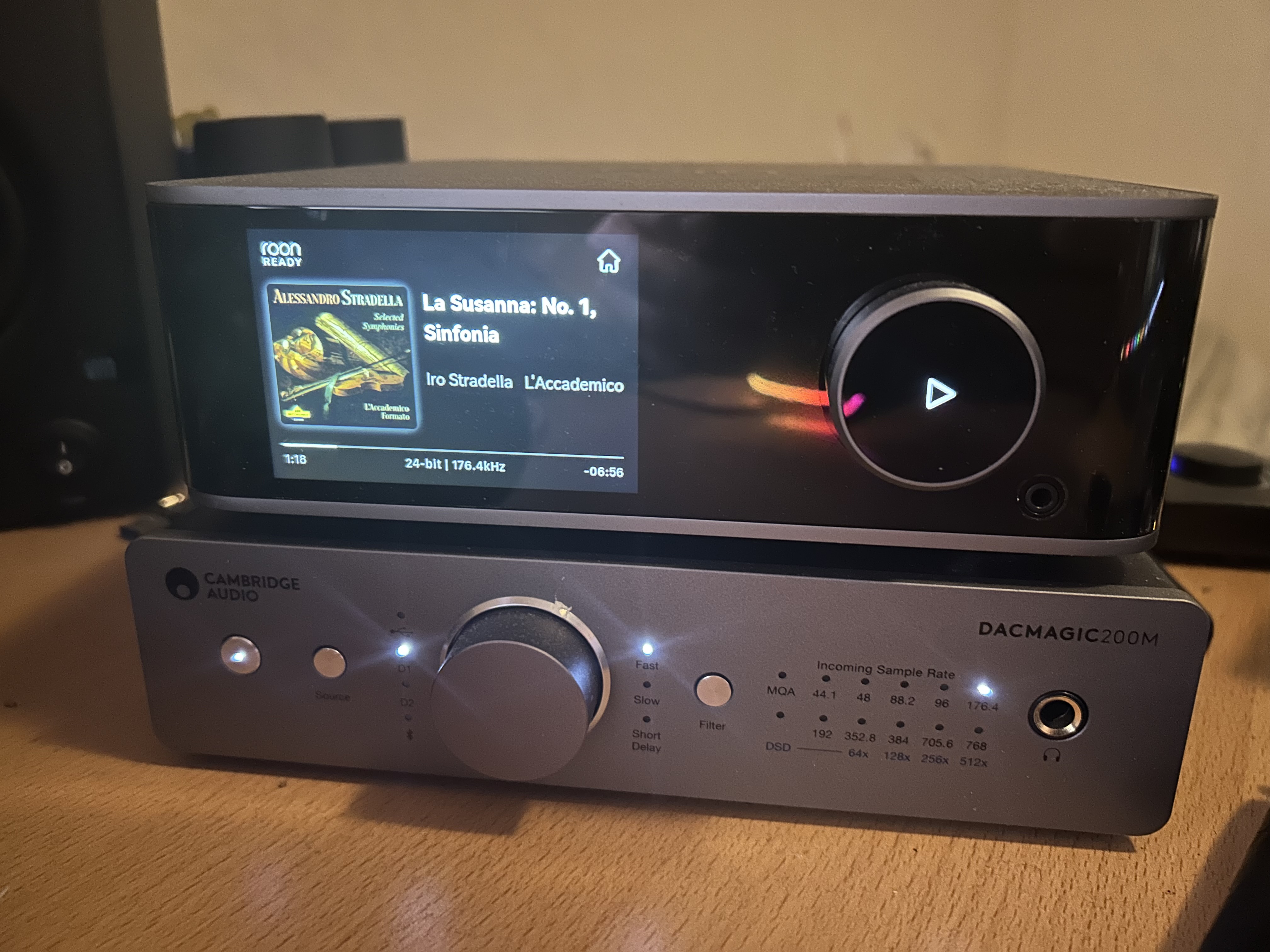

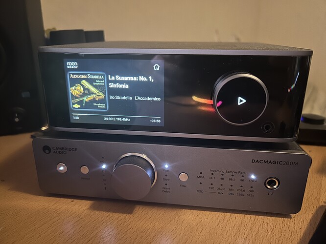

Judging the signal path. The original Qobuz file is 176.4 kHz. Not 352.8 kHz.
I’ve checked the album with my desk setup. And it plays as 176.4 kHz as well.

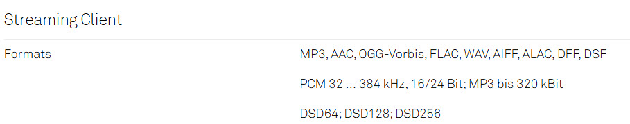

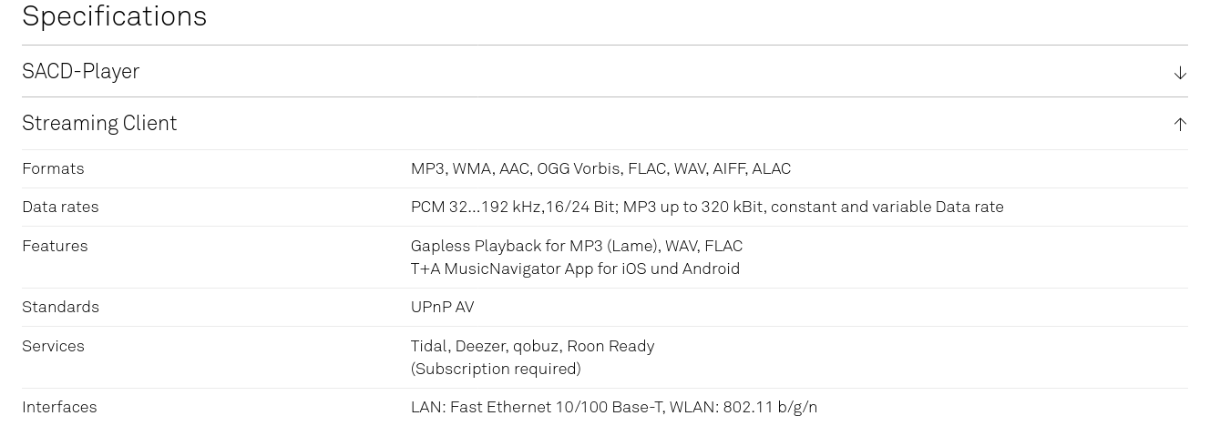

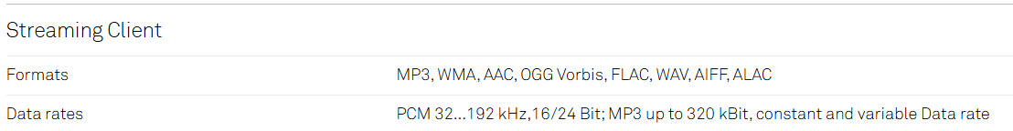

There exist published technical data for the device:
grafik
So it seems 192 kHz is all you get for the MP 2500 R.
The MP 2500 R G3’s streaming client (board) on the other hand may be rated higher but is not (separately) Roon Ready certified and also not the device you have (as of your own writing here and in your other thread).
If you own the MP 2500 R G3, please ask T+A support about why they did not certified that device and if they have plans to do it in the future so owners can use the higher resolution with Roon.

It simply is that the MP 2500 R, according to T+A, does not support more than 192 kHz.

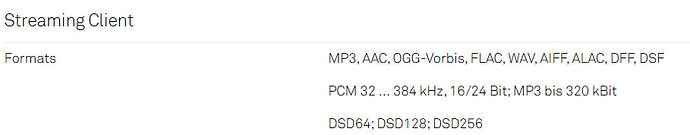

Hi Walter,
Sounds like you have a MP2500R and not the updated MP2500R G3.
If you have a MP2500R then it’s correct. Via the network interface, the max is 192/24.
https://www.ta-hifi.de/en/audiosystems/r-series/mp-2500-r-multi-source-player/
The newer MP2500R G3 does support higher sampling/bit rates as well as native DSD (up to 256) via the network interface.
https://www.ta-hifi.de/en/audiosystems/r-series/mp-2500-r-g3-multi-source-player/
If you wish to play higher sampling rates/DSD files then your option is to connect the player to your NUC with a USB cable. And install the proprietary USB driver on your NUC (see “support” > “firmware/driver” under the first page above)

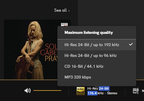

Are you sure that the T+A app/device is not doing it’s own upsampling of the incoming stream. That is what happens when I play that album through Roon. Get sent 24/176.4 and Roon upsamples it.
Qobuz’ own desktop app does not support streaming that album at that resolution.
Here is the Max Listening Quality as set in the Qobuz app…

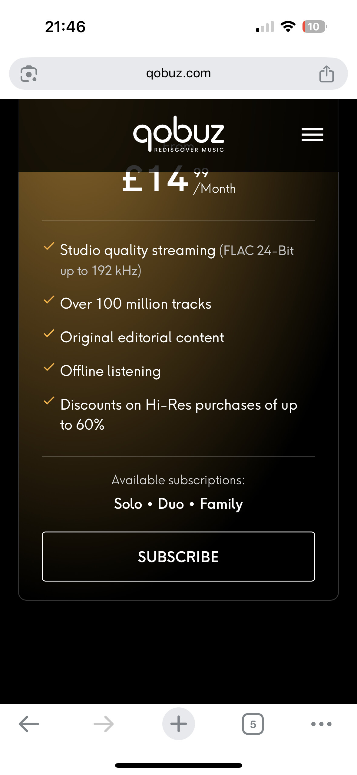

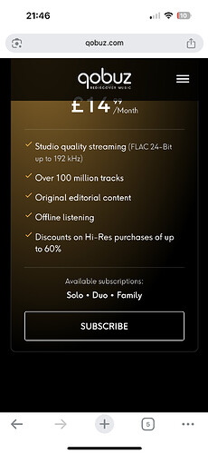

And as I’ve shown with pictures above, this is not the case. Qobuz’ own desktop application is limited to 24/192.
You seem to be able to do so through the T+A app, please post screen shots of the app, as according to all published data this should not be possible.
In Qobuz document with the link posted above you will find these two comments.
Available quality: 24 Bits/352.8 kHz. You can purchase these formats from the download store, as well as in our desktop applications and web player.
There is no mention of being able to stream this resolution, only purchase.
But more importantly, it states this…
The DSD and DXD formats are now also available for purchase; these formats are not available for streaming.
