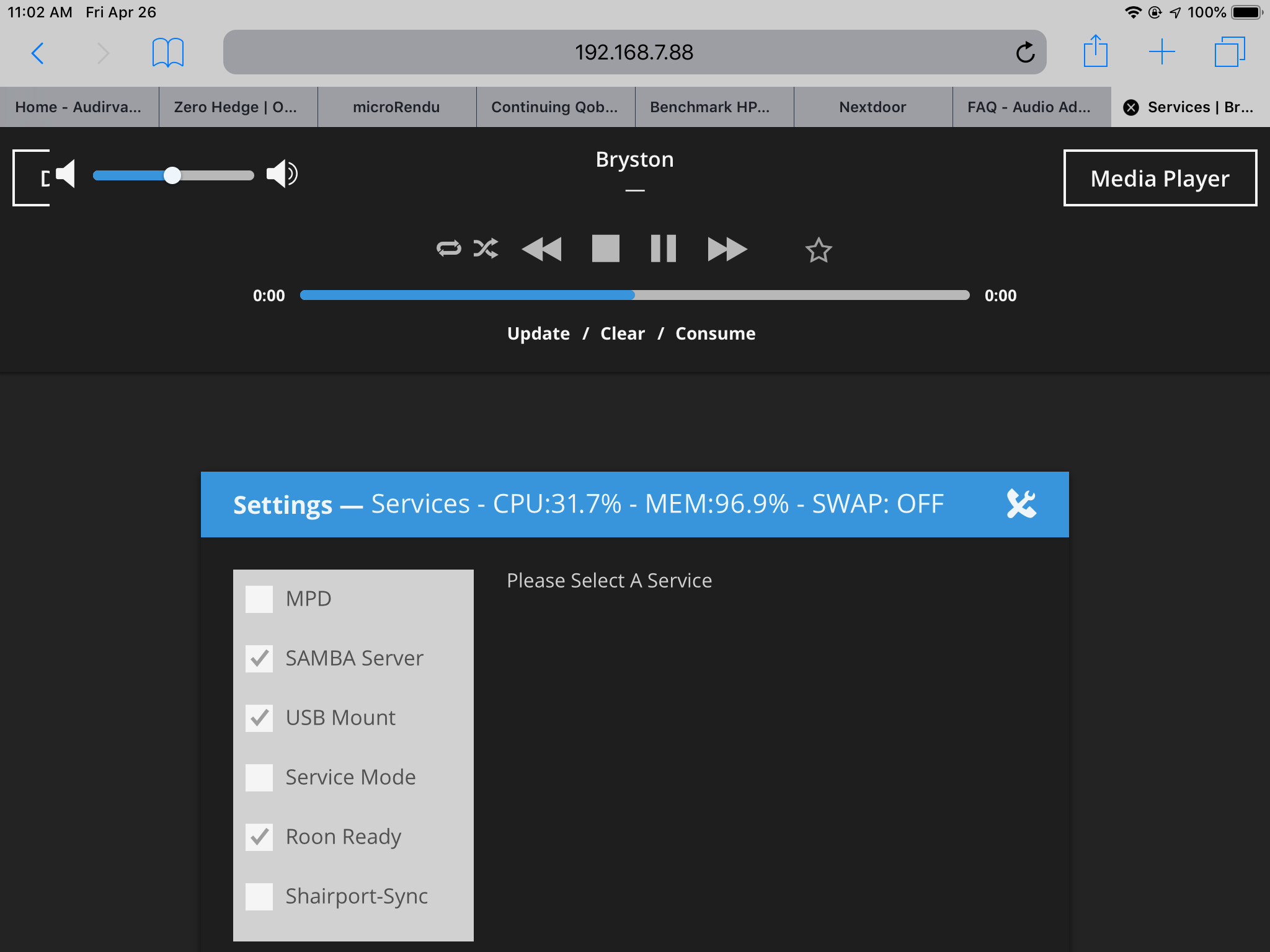

Don’t know about Rock, but the BDP-1 is Roon Ready, and connected to the network via ethernet cable. Roon Ready has to be selected in the Bryston unit settings. Check the applicable box under Services.

Yes, I am using the BDP1 as a Roon Endpoint and have been for the last 3 or 4 years. It works great! But I’m trying to figure out how to get the CORE off my laptop and into its OWN device.

i have the current firmware installed yep!
Yep that will work.
