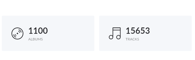

How many tracks do you have in your library. If RoonServer runs out of memory it just crashes without warning. So, it could be a sign you running into memory issues.

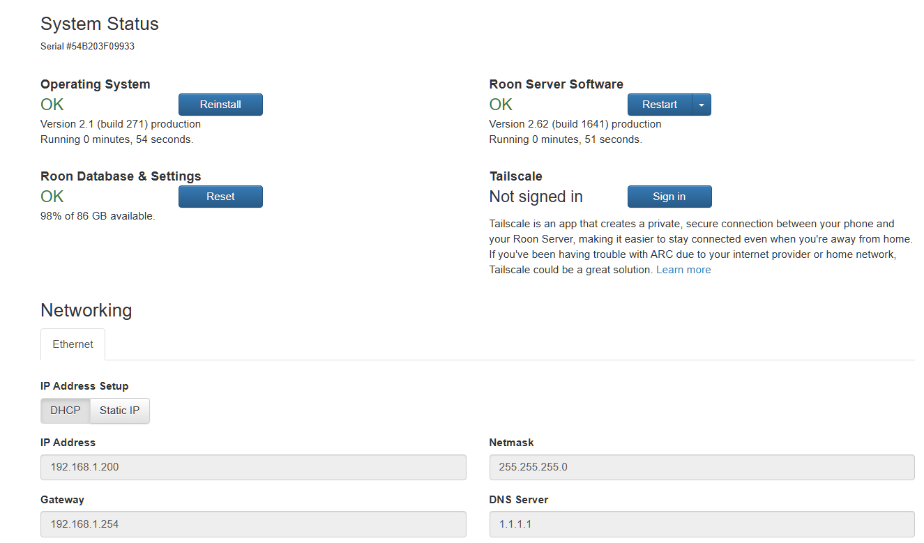

You mentioned you are hitting 192.168.1.200. Is this IP reserved in your router's DHCP table? If not, another device might be trying to claim that IP every couple of days, causing a network collision that freezes the service.

For the IP address I have a MAC reservation in my router’s DHCP for the NUC’s IP
