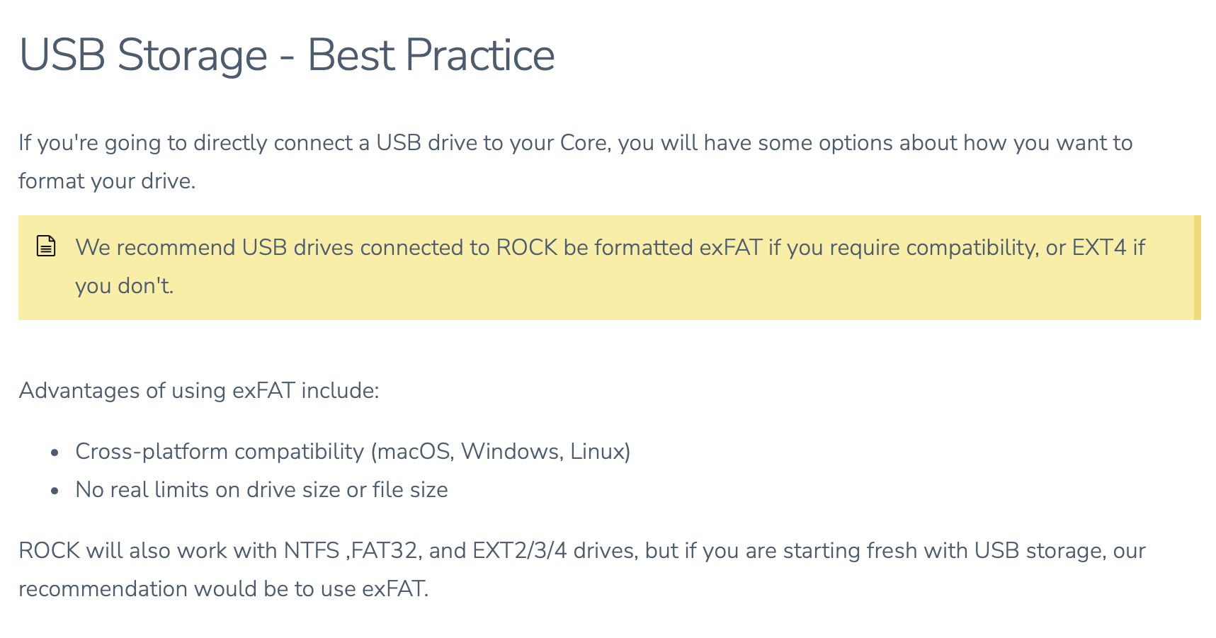

I confirmed that the SSD is formatted in exfat by plugging it directly into my Macbook and checking disk utility.

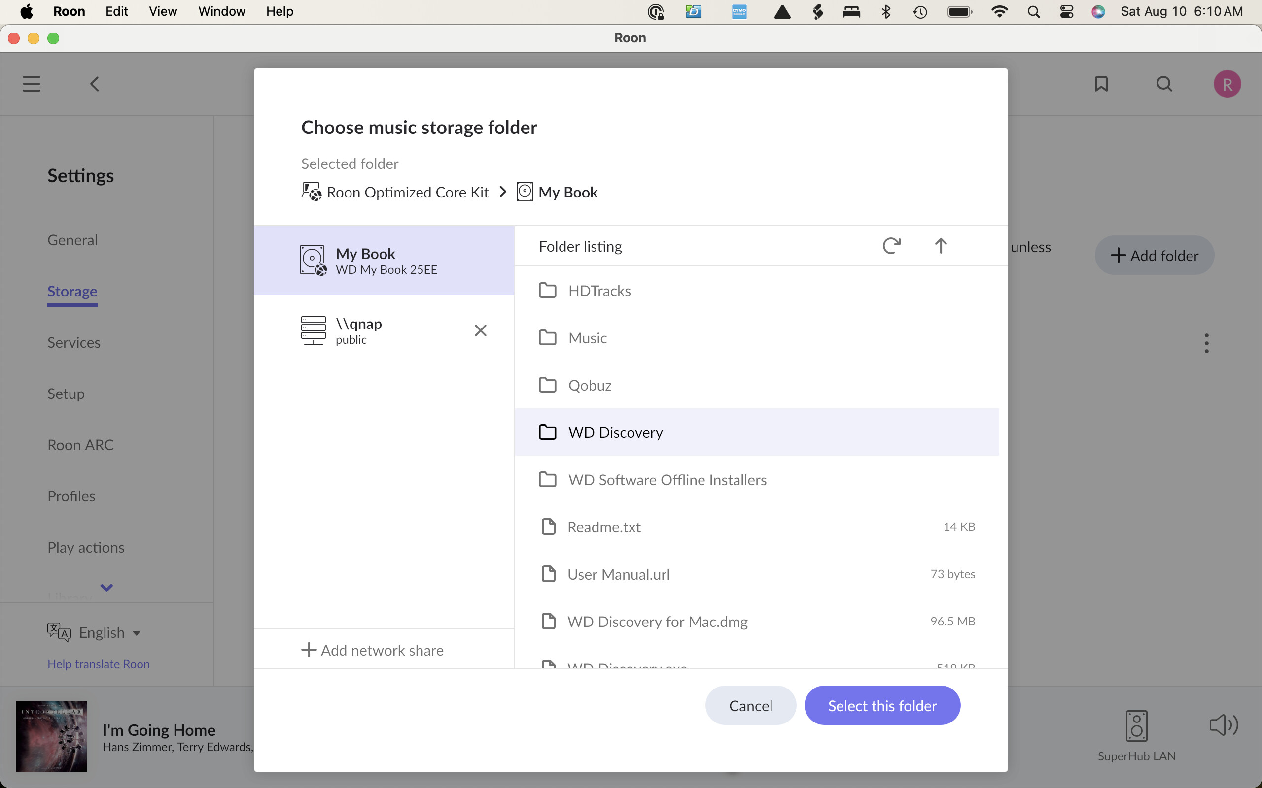

Can you post a screenshot of Roon’s “Choose music storage folder” screen with the SSD plugged in to the NUC?
Here you go. The new SSD doesn’t show up here, nor does it show in Finder when navigating to ROCK > Data > Storage…only my existing HDD shows there. Using the up-arrow in Roon/Storage to go “up” the tree back to “Roon Optimized Core Kit” has no effect other than presenting an option in the lower left for “New Folder” within an existing drive.
Hmm, it’s odd. Have you tried reformatting it again as exFAT using your Mac utility to see if that will work?
