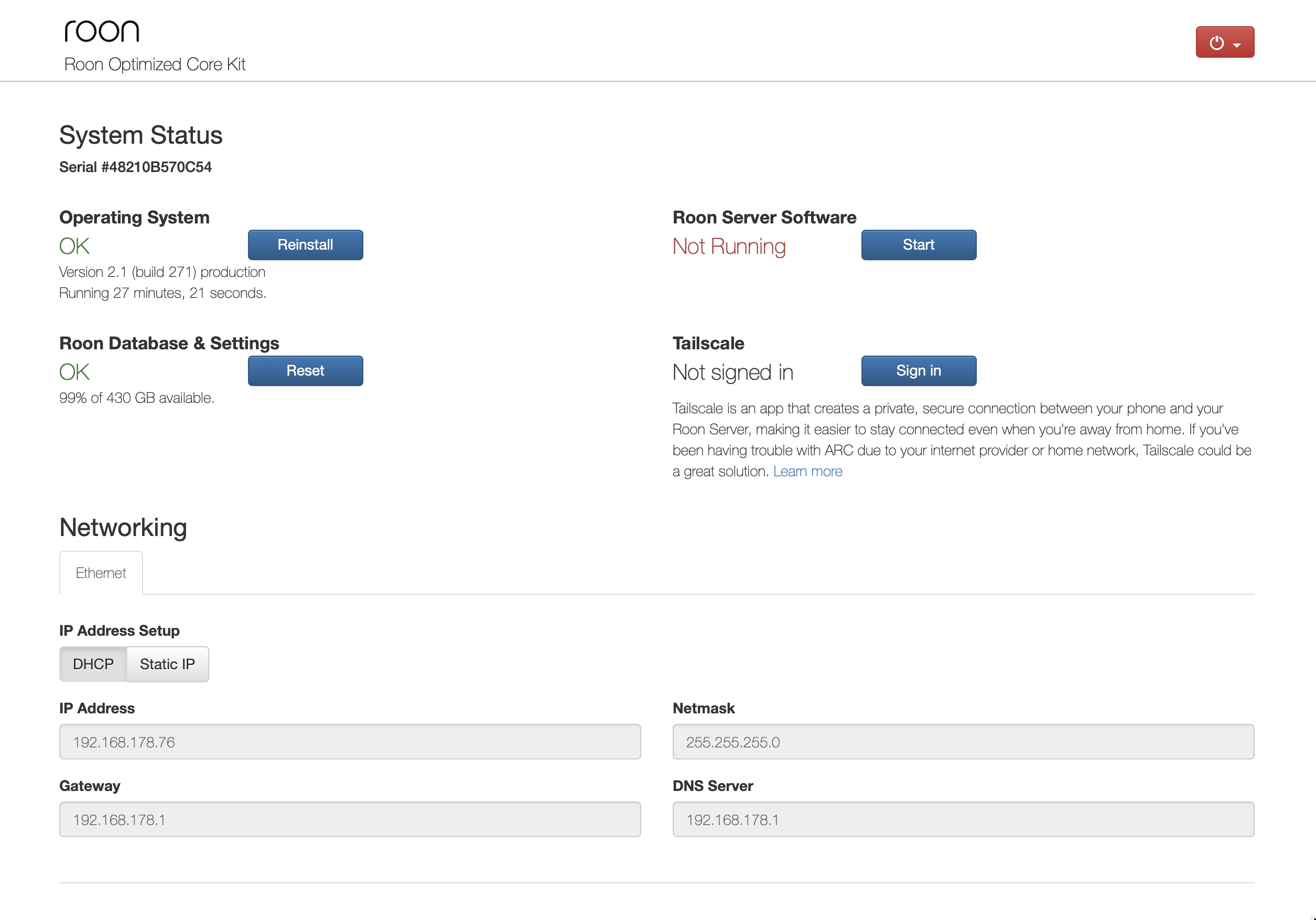

Rock is in my network and is running. Server software is not running and NUC says restarting is not possible, please contact support.
NUK as core with rock. Qnap Nas as store for music. Mac Studio 2025 and iPad Air 2025 as control. Router AVM 7690
Please wait until cloudflare gets its current issue resolved, then try again.

Hi alex_h,
You are right. By now my system is running. iPad works very well. The Mac Studio with OS Tahoe 26.1 has still problems to connect to rock. In system/privacy I very often have to turn Roon off and on. When I start my Mac again then, mostly it will run. When this will not help I have to take the router from electricity and DSL connection and start the whole system new. But this is stressful. Especially the search after the problem.
