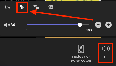

You can set Roon to up or down sample the stream to a set resolution. This is done under Muse.
Sample Rate Conversion. Set Sample Rate Conversion to “Custom”. And then set all Incoming sample rates to the same outgoing sample rate. Like this..

@Rugby is correct with the above note - you can apply a sample rate conversion in Roon before the audio stream hits your Bryston, and that should help you out.
Enable your Bryston as your zone like you would normally, and then click the speaker icon to access MUSE:
