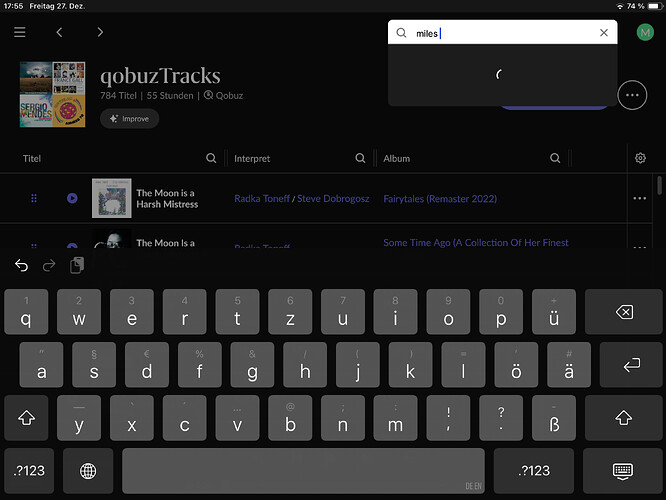

However since having updated to the latest Roon firmware for the Nucleus plus the search function has become very slow and often cannot find artist or tracks entered in the search field. An example: just today Roon search couldn’t find „Miles Davis“. The difference in search-speed and search-reliability becomes most obvious when comparing it with jPlay app running on my iPad too. Search with jPlay for Qobuz artist and tracks is much more faster and absolutely reliable.
Any idea what’s going wrong? It’s nice indeed getting more and more functions in Roon as Roon Ready Relay etc. But happens this at the expense of a weaker search function and slower data transfer?
I just tried it and the response returned immediately after Miles was typed in before I could add Davis.

Actually Roon found Miles but initially showed this error message:

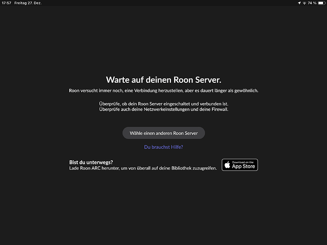

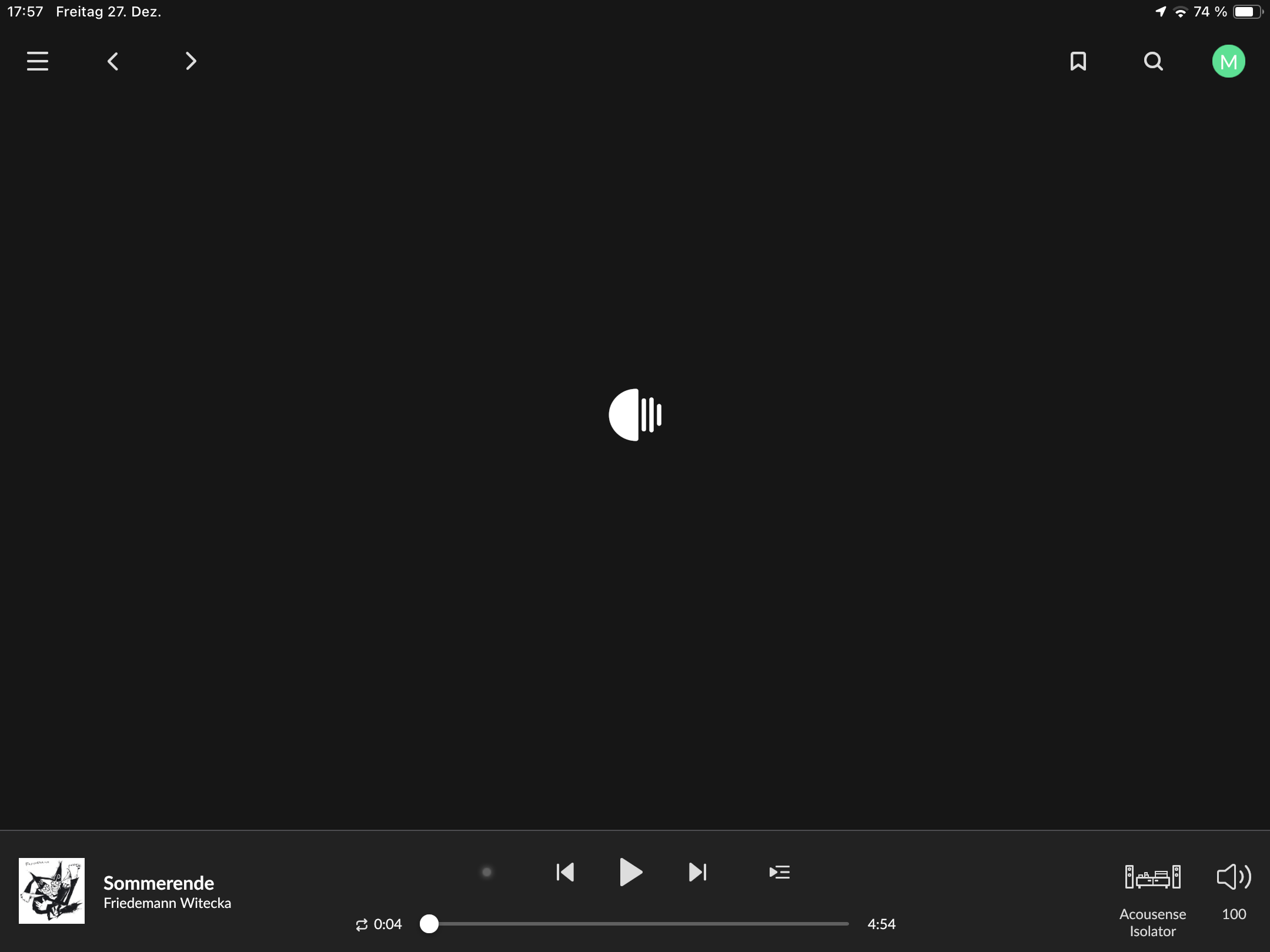

The slow and delayed reaction begins when staring Roon on my iPad, see screenshots:

When starting my Roon App on my iPad it takes about 8 to 10 sec before the Roon UI is ready for commands.
My jPlay app is ready within 4 to 5 sec.
