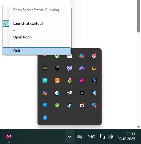

  2. Exit from the Roon server using the taskbar and click Quit.
  3. Open the Process Manager and make sure that there is no Roon or RAAT process active.
  4. Navigate to /Roon/Database/Registry/Core/
  5. Delete all files in the directory and make sure that all the files with 170180f547a87e77807d560f7be92b3e7d58 in the name are removed from the folder.
  6. Restart your PC.
  7. Open Roon and enable the device via the Settings → Audio again.
Let us know how it goes after that.
