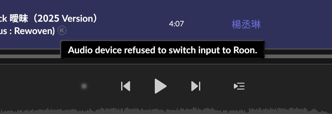

KEF LS60 not playing DSD anymore following April 2026 firmware updates. Once attempt to play DSD and fail, all subsequent playback will fail with reason "Audio device refused to switch input to Roon."
KEF 60 connecting to router over LAN cable. Roon Server on Mac Mini is also connected to the same router over LAN.
