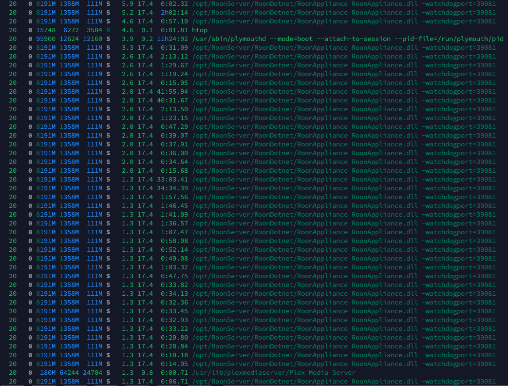

Running Roon Server on Ubuntu. Via terminal htop and post back a screenshot when this is occurring.
Or
sudo apt install htop if not installed already
Then
htop
This could help highlight if something is causing the high temp or confirm it’s as per @vadim and needs some TLC.

this was now when it was going off recently, cpu amount varies, but its the same process stacking up.
I will give it a try! its completely random when it start to spin up, even when i havent used it for a few days.
