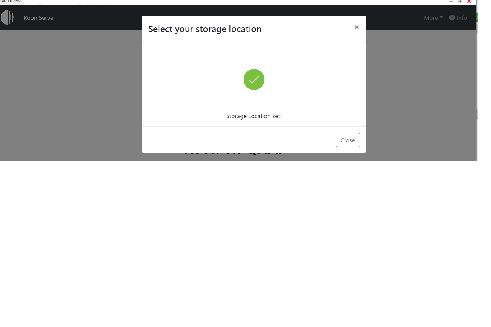

I finally managed get the roon server installed after two weeks attempt (I’m in China and installation stop at 50% …) and I’m now stuck at the first configuration page when i open the roon server, i have created a shared roonserver folder and pointing it to store the roon database at the configuration page, it gave me message of location is set and return back to the configuration page again which running in the loop.
i have stop and start the roon server service but it not helping. below is the debug it display

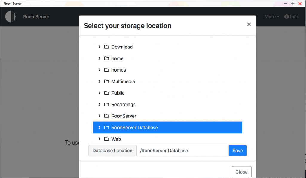

  • Can you share a screenshot of your “Select Storage Location Folder” tab? For refeference this is what this screen looks like:

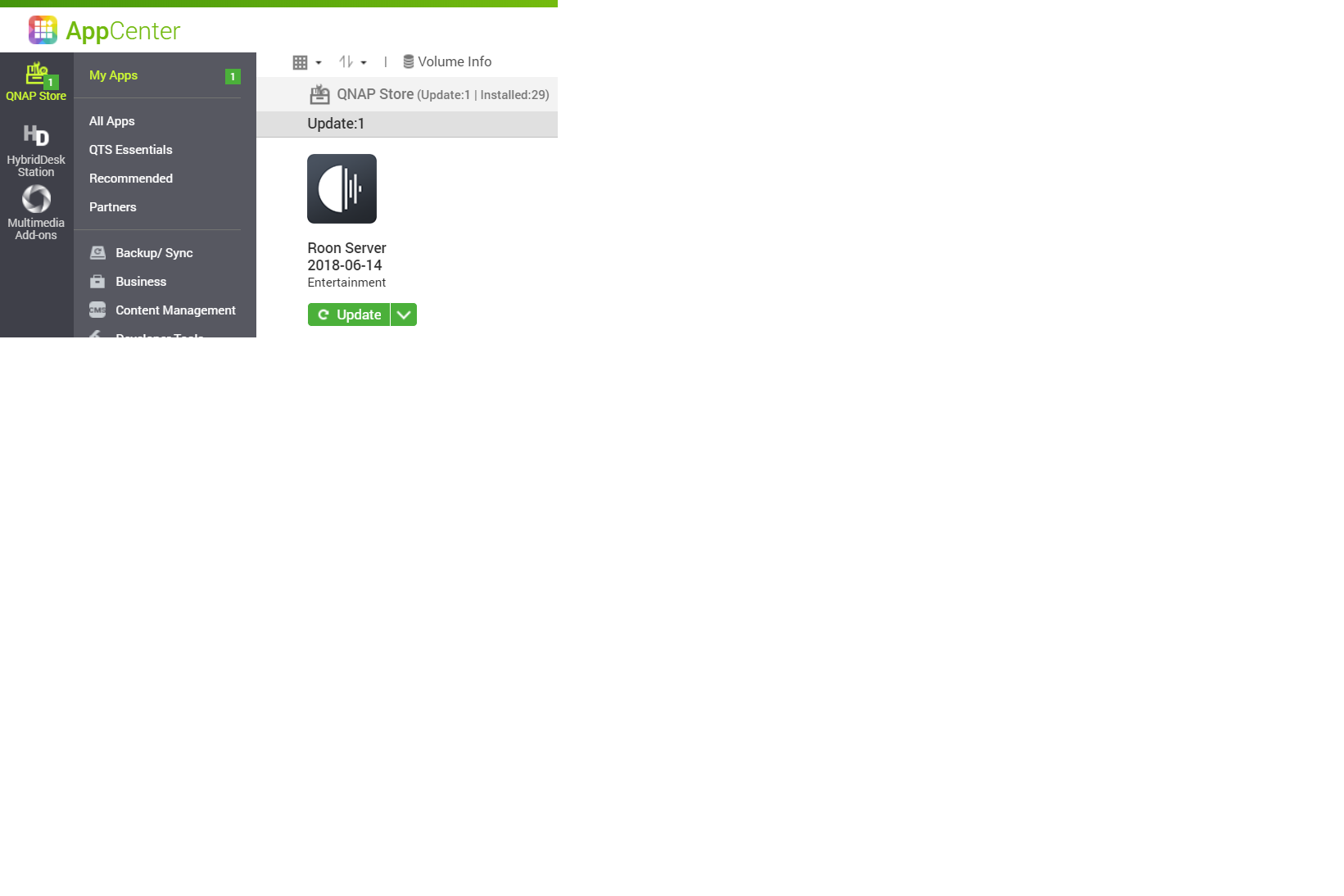

  • yes, have follow the instructions and install the roon server thru the app center, I have installed the 2018-06-14 version three weeks ago and now failed trying to update by clicking the update icon, the update process took overnight and I got no response, background update job disappear but it still asking me to update roon server, see screen dump 1, let me try to remove the whole thing and try again

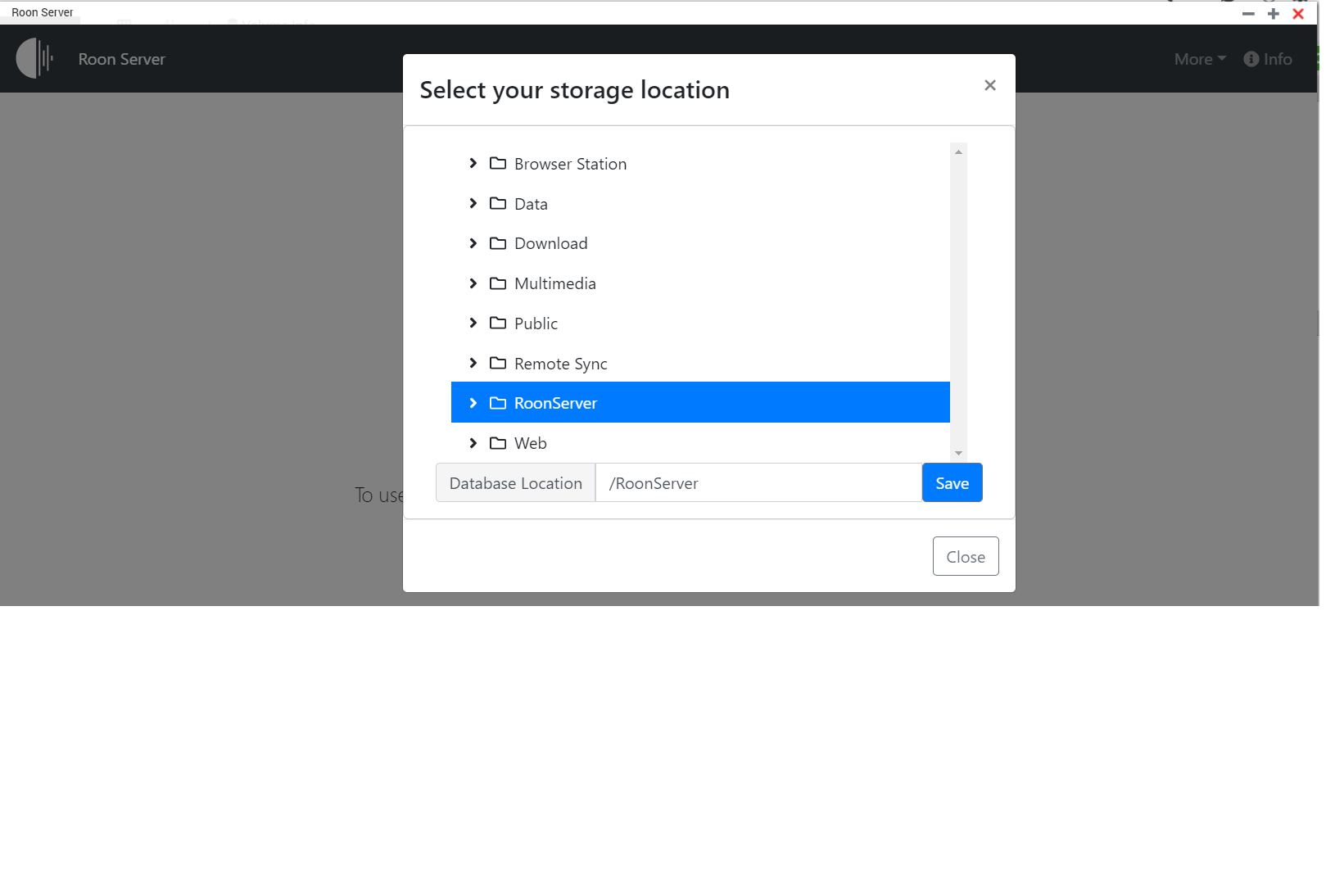

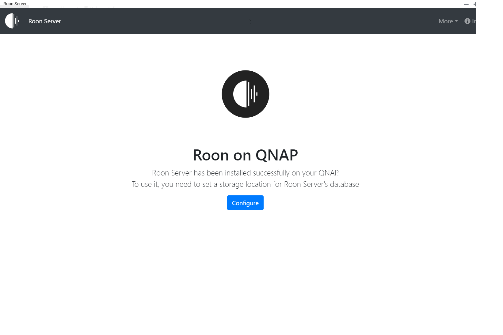

  • see screen attached screen 2, once the location selected, it goes to screen 3 and then back to 4 asking me to select the location again
  • have done the reboot, on/off but still the same
I will do a flesh installation again and revert.

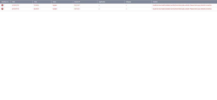

I can’t even install the server now, it show up at the App center (2019-06-09) but it never get install successfully, after few hours waiting, it says could not download installation archive from Roon labs website, please check your internet connection. (see screen dump)
I have the same issue before with 2018 version but it seems install “ok” after few try.
@noris I have not got the log file before and the roonserver folder was empty … so I guess the installation is not quite right.
