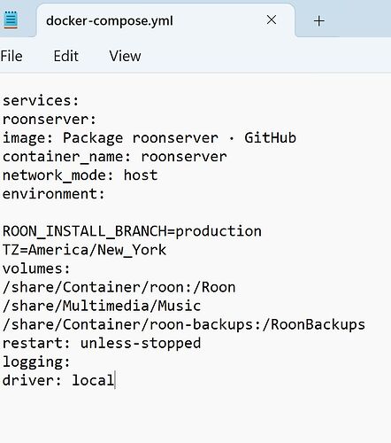

I tried restarting the container, but that didn’t help. I used the provided YAML code, except I changed the location of my music to /share/Multimedia/Music:
services:
roonserver:
image: Package roonserver · GitHub
container_name: roonserver
network_mode: host
environment:
  • ROON_INSTALL_BRANCH=production
  • TZ=America/New_York
    volumes:
  • /share/Container/roon:/Roon
  • /share/Multimedia/Music
  • /share/Container/roon-backups:/RoonBackups
    restart: unless-stopped
    logging:
    driver: local
Attached are screenshots of the Roon Server container. It is showing no networks, which I assume could be the problem.

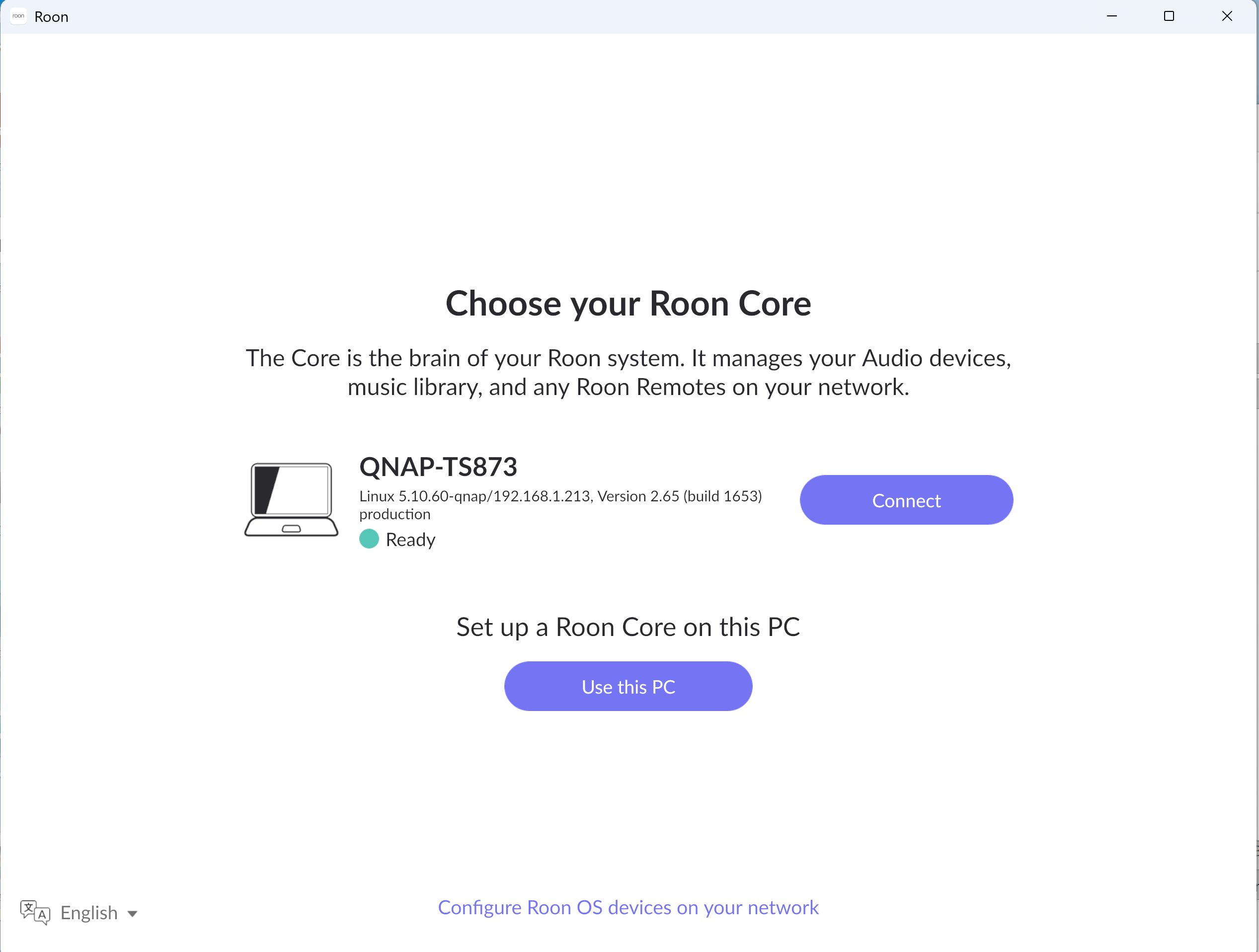

Hello. Unfortunately that didn’t work. PROART-P16 actually isn’t the right server. I have deleted it, but I was trying to connect to QNAP-TS873 server (see attached image). It is still hanging after selecting this server and I did delete the cache on the Windows computer. I also deleted the app on my iPhone and reinstalled, but got the same result.

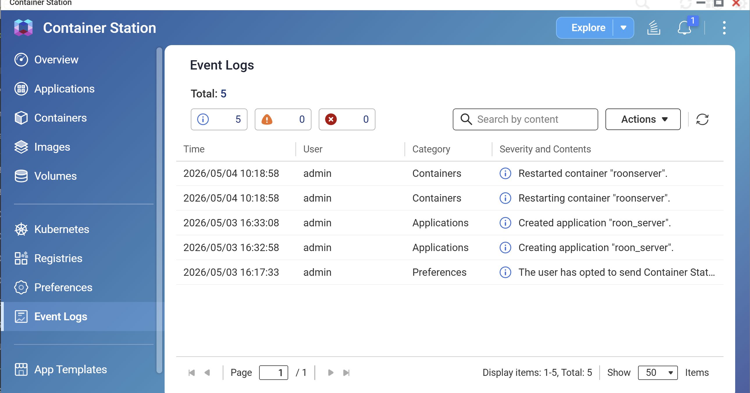

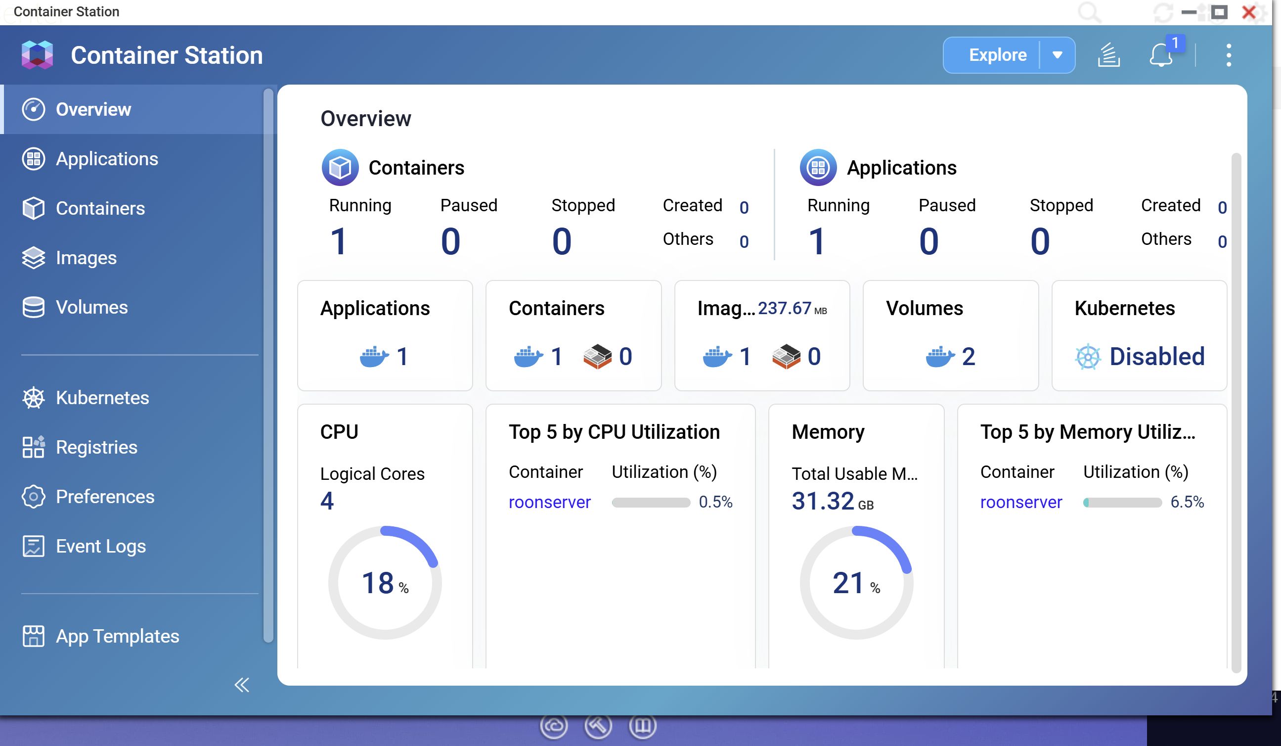

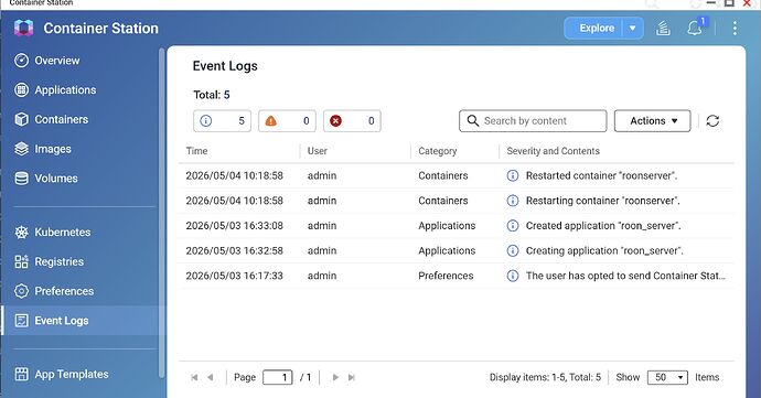

Hello. Unfortunately, deleting the folders and reinstalling Roon didn’t help. Attached are the screenshots of the Container Station Event Log and Dashboard and the docker-compose.yml file. The is nothing in the Log except for creating the container and restarting the application. The yml file is the same as the provided one except the location of the music files being changed for my setup.
v
Sorry. I forgot to attach the files.

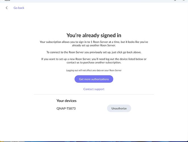

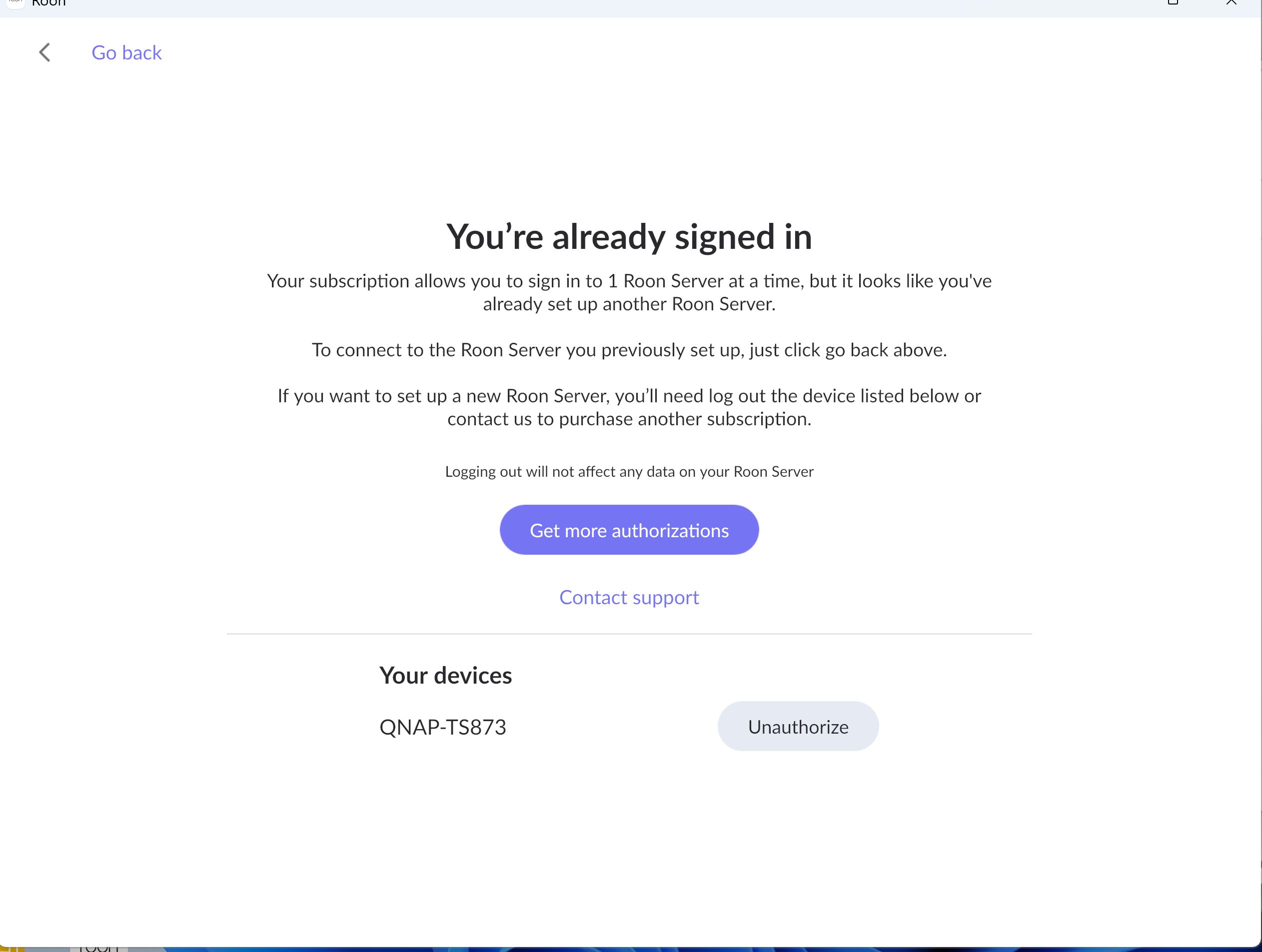

I restarted the Roon Server application in Container Station and did get to the You’re Already Signed In - Unauthorize screen (see attached). I didn’t backup my old database to to the new Docker mapped folders. Should I Unauthorize the existing QNAP-TS873 server? Thanks.
Hello @Curtis_Schuelein,
That screenshot is exactly what we wanted to see! Getting to this screen means your new Docker container is running perfectly and properly communicating with your remote app.
Yes, you should absolutely click Unauthorize.
Why it is Safe:
Clicking “Unauthorize” does not delete any of your music, settings, or your old database. It simply tells Roon’s cloud servers to transfer your single active streaming license from the old QPKG installation over to this new Docker container.

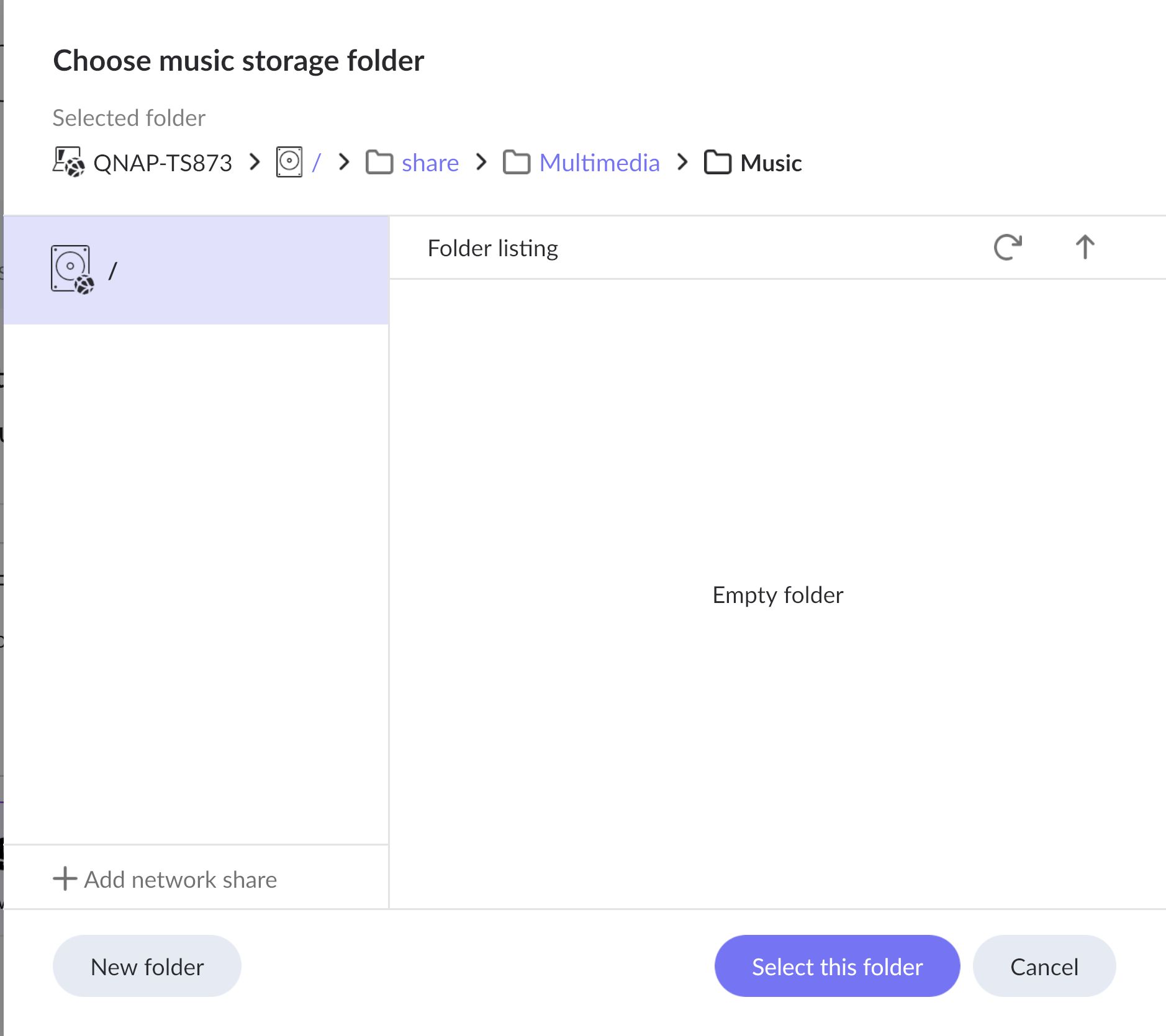

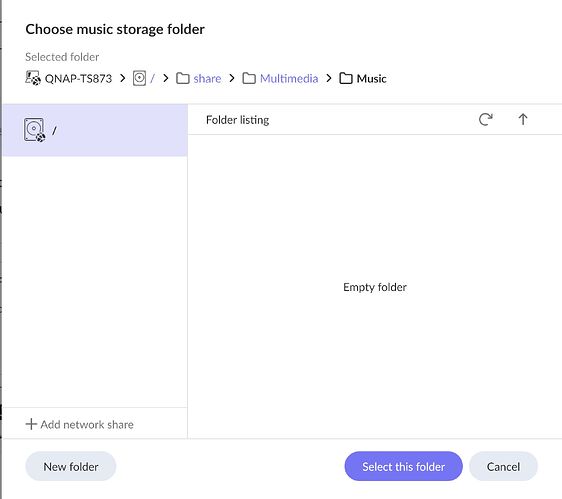

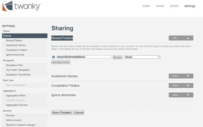

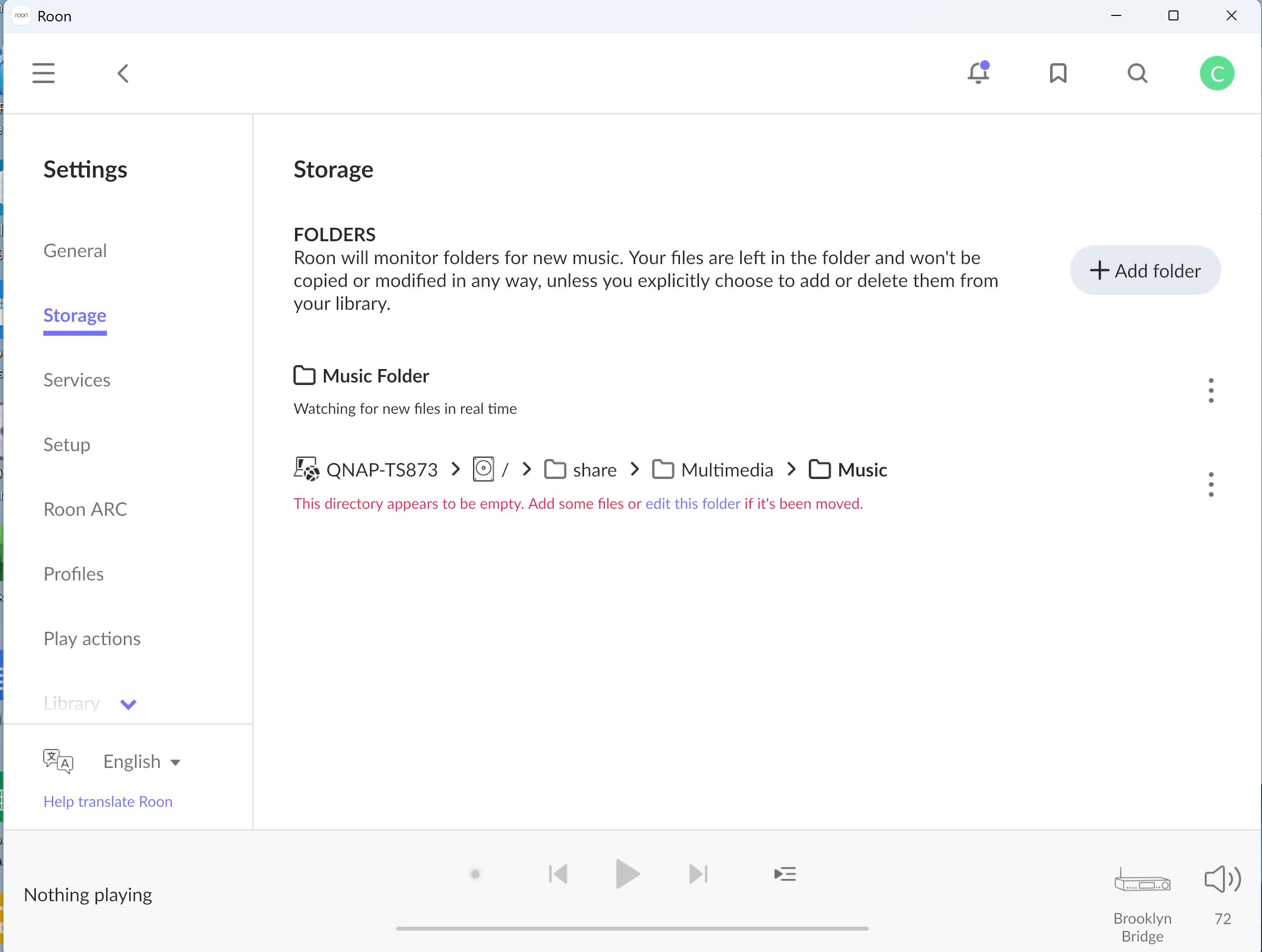

Thanks. I got Roon Remote to launch, but it is showing no music. I get the indication that my music folder is empty when I go to Choose music storage folder, which it is not. Thanks again.
This is the same music storage folder that currently works fine with Twonky Server and previously with Roon Server.
Here it is in Roon Remote.
Please check the second share path in your docker script. If you are using this one:
there might be a syntax error in the exact line. If /share/Multimedia/Music is the correct folder where your music is on the NAS, the script line should read:
/share/Multimedia/Music:/Music
Apparently the :/Music part is missing, which defines the alias name of the folder inside the container. Roon in the container seems to take the share post on the host side (/share/Multimedia/Music) as the alias name within the docker, which leads to nowhere because the first term of the line, before the : is missing.
Don´t forget to update or reinstall the container after altering the script.
