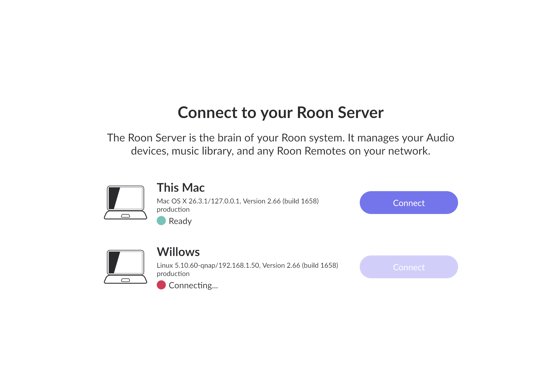

I have installed Roon Server as a new trial user on my QNAP TS 253D running QTS 5.2.9.3451. I have installed it via Docker and following the instructions provided by Roon. The server is running. However, when I try and connect via Roon interface on my MacBook, Roon sees the server but gets stuck in "connecting". There's another slightly odd issue. The MacBook and Roon Server are on the same subnet (198.x.x.x) - this has been confirmed through terminal. However, in the connecting screen Roon shows the MacBook with a different subnet to the server (127.x.x.x). There may be a port issue also - Port 9100 refused, port 9330 open. help please. thanks!
MacBook is connecting wirelessly, the QNAP is on ethernet connected via unmanaged switch to Utility Warehouse router (Technicolor DGA4135)

Hi Vadim. thanks for following up. This is all sorted now. I reconnected my QNAP directly to my router and everything started working! thanks again, Terry
