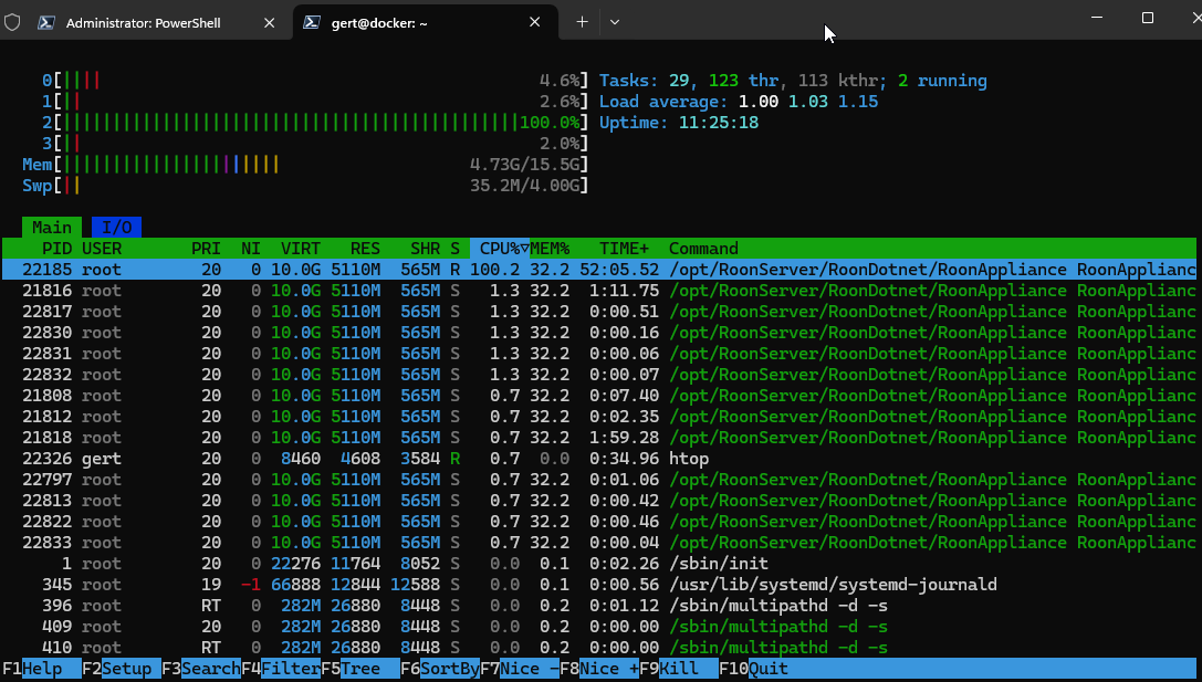

Roon server uses all cpu

Roon in a container/docker env. is not an officially supported situation.
Apologies if i misunderstood your screenshot.
Is your library fully analysed and identified? Size?
That has nothing to do with docker it’s standard Linux htop for performance monitoring. Shows what apps are doing what work the pcs resources. Roon is using all one core so it becomes sluggish in nature. Reports by many of us, no solution in sight.
I know how htop looks, but the ssh session is gert@docker which indicates a container solution.
Ah yes very observant I missed that. Not had my coffee yet. Still it shows the same problem lots of us are getting docker or no docker.
Havel you done a trace in to Roonserver log to see what it’s doing. When it’s happened on mine it ends up being metadatasvc updates which is doing a full library metadata trawl and update from its services.
