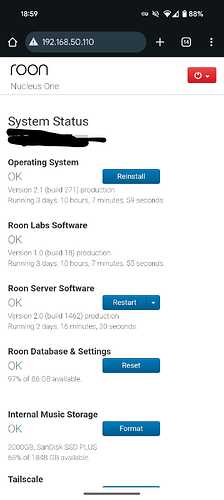

Can you share a screenshot of the webUI of the Nucleus?

Here is a screenshot (from now) of the Nucleus Web UI:

Thanks for the update! We were able to review another diagnostic report from your Nucleus, but didn’t see any obvious issues based on the screenshot you shared above.
