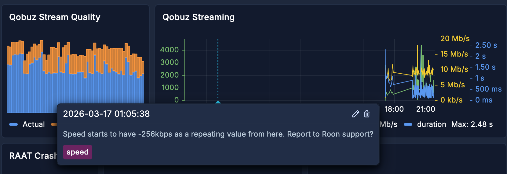

A Roon remote stopped playing a song and seemed stuck. Pressing the pause and play button did not result in the song continuing. Only by skipping to the next song in the queue did the music continue playing. Odd behavior but I considered it a momentary network glitch with Qobuz’s platform.

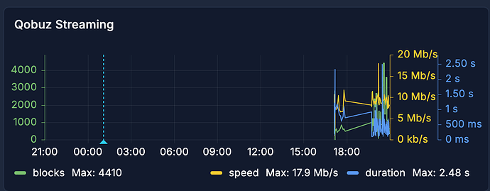

After a while, I noticed that a Grafana chart I used to track Qobuz download speeds stopped showing data points:
At the timestamp when the chart stopped showing data, this was in the Roon Server logs:
03/17 01:06:27 Debug: FTMSI-B-OE qo/531A4FB7 rid:1 request ended – first block: 0 blocks read: 0 download speed: -256kbps response time: 153ms
To find how often the “-256kbps download speed” entry appears in the log files I executed the following commands from the Mac OS terminal:

03/22 16:46:06 Warn: FTMSI-B-OE qo/E3BE7969 rid:1298 error response: 410
  • File request #1298 got an HTTP 410 from Akamai
Manual verification using curl
HTTP/1.1 410 Gone
Server: AkamaiGHost
Mime-Version: 1.0
Content-Type: text/html
Content-Length: 404
Expires: Sun, 22 Mar 2026 21:52:34 GMT
Date: Sun, 22 Mar 2026 21:52:34 GMT
X-Cache: TCP_DENIED from a23-33-86-31.deploy.akamaitechnologies.com (AkamaiGHost/22.4.4-cf5672731e69c345796af56199edfb50) (-)
Quick update: I think I’m incorrectly interpreting those ERROR_CODES and STATUS_CODES from the X-Akamai-Session-Info headers: they look more like static configuration settings and not dynamic values. This is based on a couple things…
  1. I was able to download a “stuck” file from Qobuz’s staging edge server while their prod environment was failing to serve the file. Yet the ERR_DNS_TIMEOUT and 500 502 504 in the headers from the staging server are the same as prod.
  2. Akamai docs seem to indicate status codes are configured by the customer (Qobuz) and they are separated by spaces
