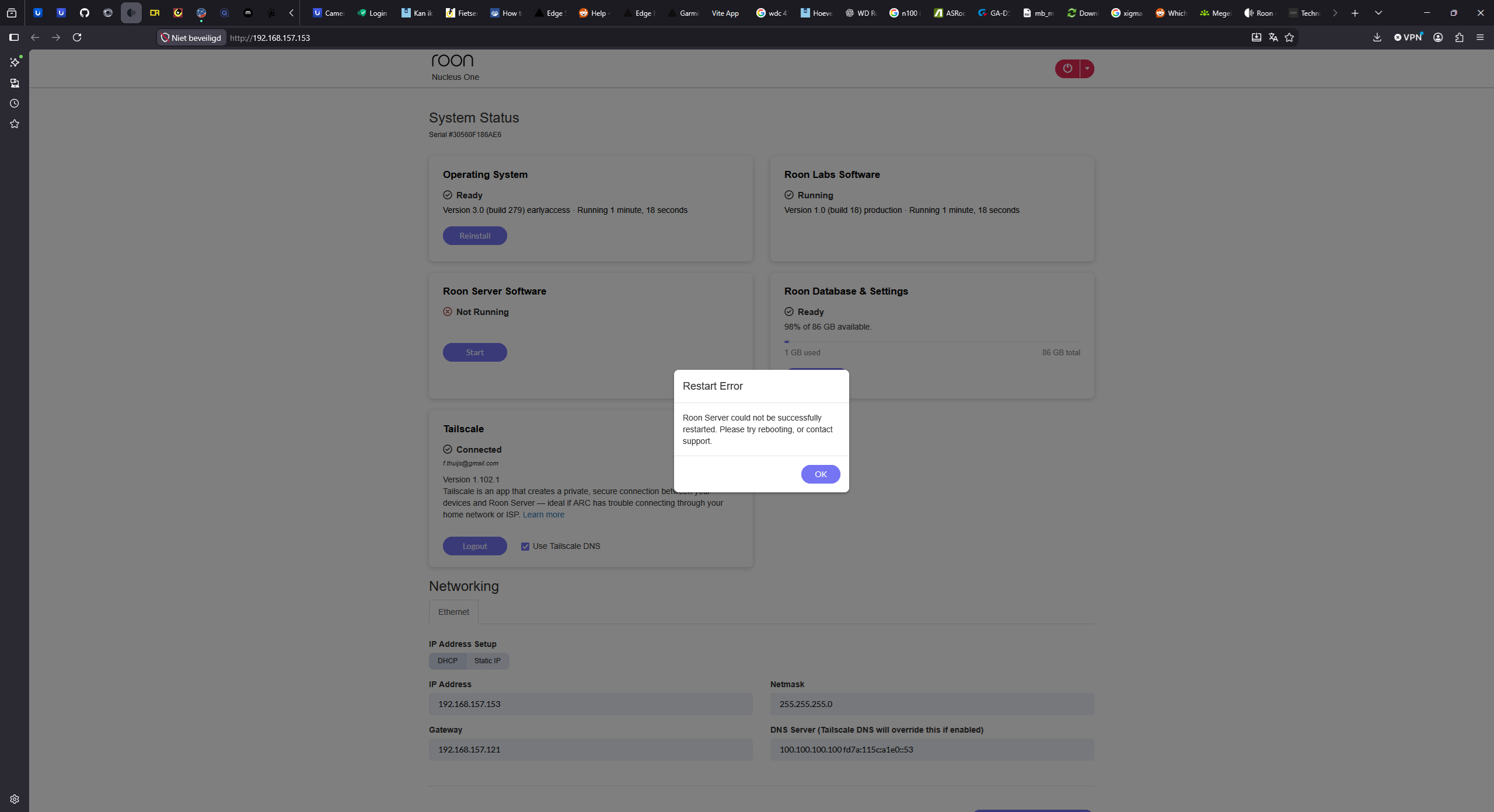

Roon server fails to start post-update (ref#LELFUX)
· Roon server doesn't start after latest update!

Have you tried if Roon is working for you despite the web UI saying that the server is not running?
There is a known bug in today’s update that makes the web UI of RoonOS say “not running” even though it’s actually running just fine.
See the newly pinned central tracking thread:
Hello @Frank_Thuijs ,
We are looking into the issue of the wrong status being shown there. According to our diagnostic system, it looks like your Roon Server is showing as operating properly, can you please confirm if the Web Interface Error is the only issue and the system is working as expected otherwise?
It wasn’t working on my PC earlier this evening, but it is now accessible from my iPad. So I presume Roon server is running and it’s only the webserver…
Hello @Frank_Thuijs
That is right, your Roon Server was running the whole time. What you saw was a display bug in the RoonOS web interface reporting it as not running when it was active.
It is fixed in the hotfix we released yesterday, Roon 2.71 build 1683:
The update should be offered to you automatically. Please check Settings, then About, in Roon, and install it if it is waiting there. After that the web interface will report the correct status again.
One thing to confirm: you mentioned Roon was not working from your PC earlier in the evening, while your iPad works. Please let us know whether the PC connects normally now, since that would be a separate matter from the status display.
Yes, later on I noticed that Roon on my PC also worked. It took a long (a longer) time to connect to my Nucleus One, but then it connected.
