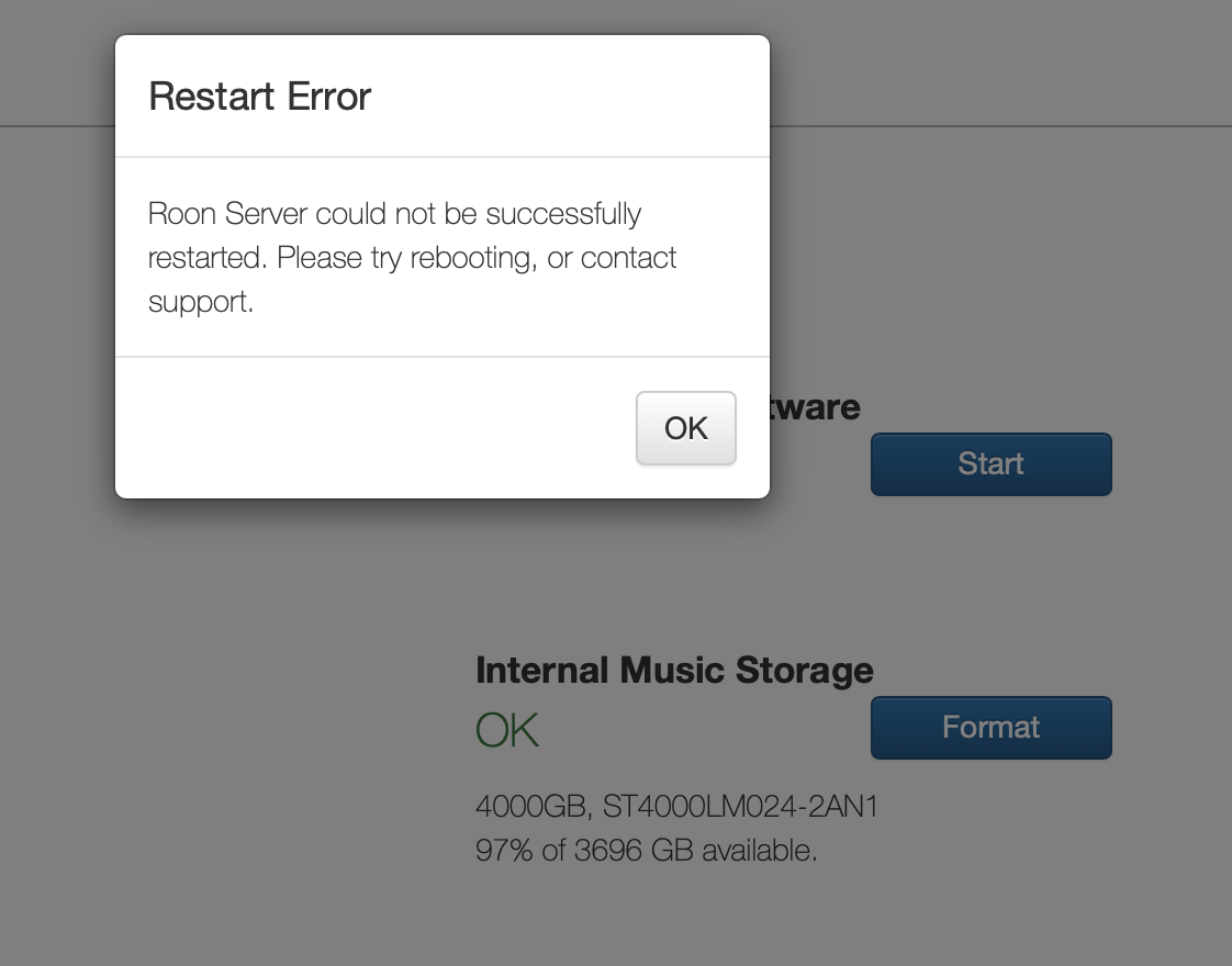

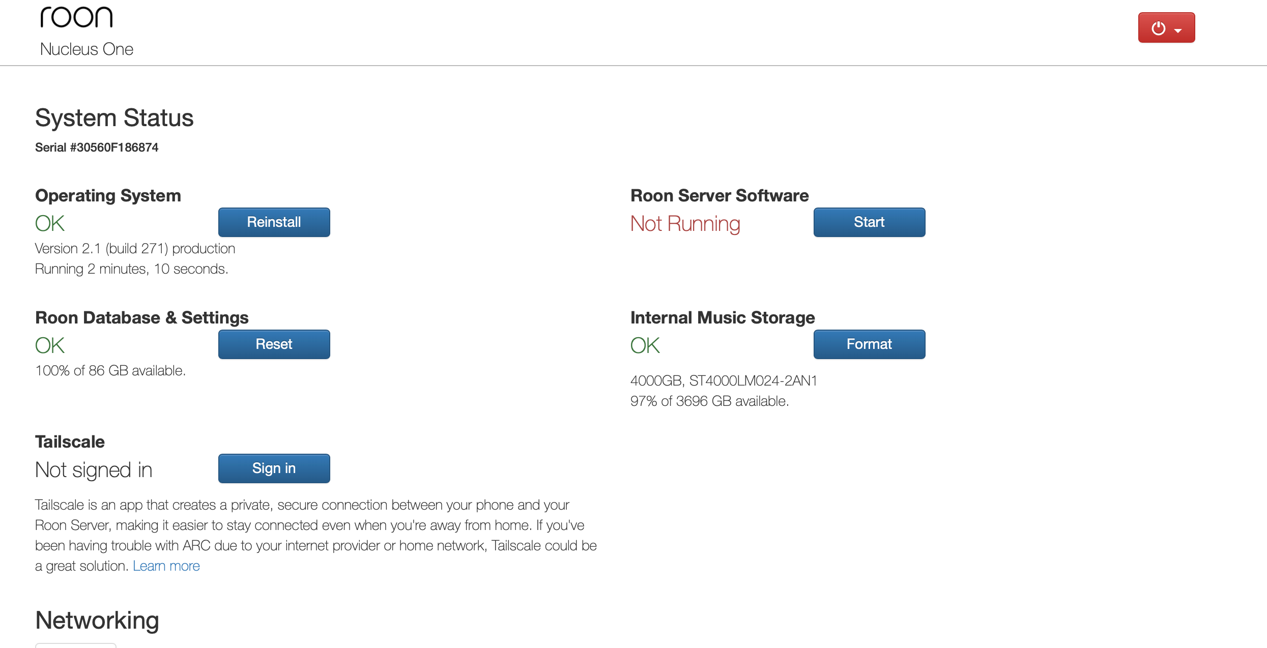

I tried to re-install the OS as I could not get the Roon Server to update (it was at 2.66). After re-installing, the Server did not re-start due to “Missing Codecs”. I googled and found directions to install FFMPEG file in codecs directory. I then got the option to restart the server (image that I uploaded) but the restart always fails. I tried re-booting the Nucleus One, resetting the database, re-installing the OS but still get the same message.
I made no hardware or other changes before this occurred (re-installing the OS). I tried multiple times on different machines through the Roon App to update the Server but each failed.

The system does successfully boot to the web UI but fails when I try to start the Roon Server. Could there be a problem with the FFMPEG file I copied into the “codec” directory? At this point I have reset everything including the Database and Settings and removed the hard drive from the Nucleus One so it should be in the state that I received it in. The first error is “Missing Codecs” which I addressed by copying the FFMPEG file into the “codec” directory. The OS is “Version 2.1 (build 271) production”. I have tried re-installing the OS from the web UI and the process seems to complete correctly. Just cannot re-start the Roon Server.

After further testing, here is what I found:
  1. If I try to reinstall the OS from the web interface, I get the same state I had previously: unable to start the Roon Server.
  2. The ROCK install has Roon Server v2.0 (build 1303) and asked to check for an update. I clicked on the link but the result is “There was an error checking for an update”
