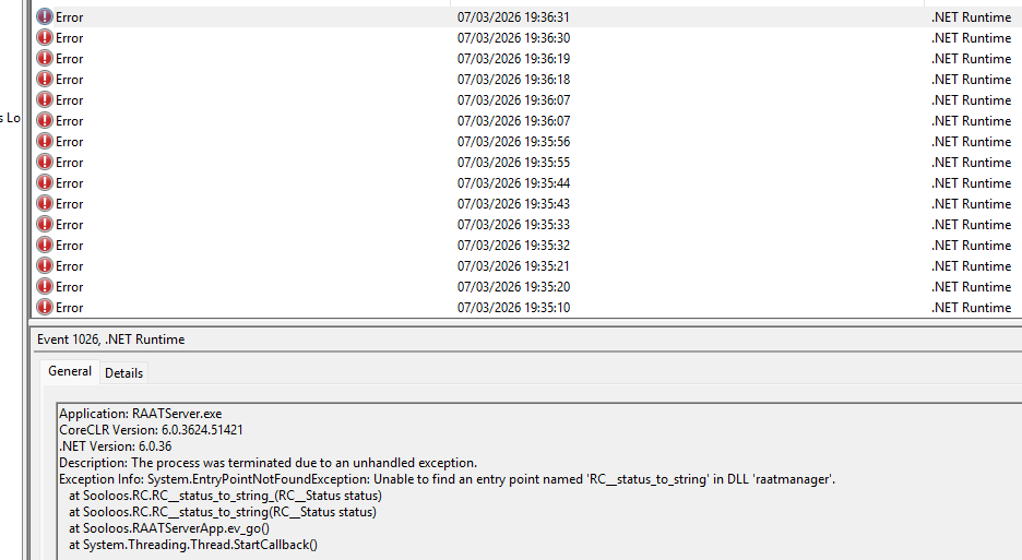

· Roon Server fails to start correctly and creates many event view entries. Roon version 2.62 (build 1641), Windows 11 Pro (10.0.26200). I have tried re-installation (without uninstall), several machine reboots, disabling firewall to no avail.
Event viewer messages are of the form
Application: RAATServer.exe
CoreCLR Version: 6.0.3624.51421
.NET Version: 6.0.36
Description: The process was terminated due to an unhandled exception.
Exception Info: System.EntryPointNotFoundException: Unable to find an entry point named ‘RC__status_to_string’ in DLL ‘raatmanager’.
at Sooloos.RC.RC__status_to_string_(RC__Status status)
at Sooloos.RC.RC__status_to_string(RC__Status status)
at Sooloos.RAATServerApp.ev_go()
at System.Threading.Thread.StartCallback()
Many thanks

I’ve actually managed to get things working again - I usually keep a connected external DAC powered down, but thought I would try powering it up to see what happened, and things have started as expected. One of the normal audio devices does seem to not be detected currently and that was the default but after transfering between zones it now appears to be working as normal. I’ll test over the next couple of days but hopefully this is now resolved.

This appears to be a temporary, edge-case race condition: RAAT tried to enumerate available local endpoints at startup while the system output wasn’t actually online. Keeping the external DAC powered resolved the issue because a valid audio device was available for system output.
This shouldn’t normally happen, and the team is investigating ways to prevent it. If you set the System Output to something that’s always available (like built-in computer speakers or a DAC that draws USB bus power) you shouldn’t encounter this issue in the meantime.
